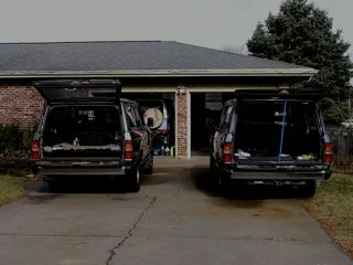

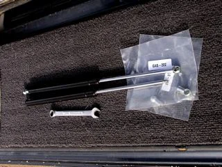

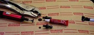

    Sure appreciate all the info on replacement tailgate struts!
    I used Reid Supply Co., mfg. is ArvinMeritor, label tag is Guden; Suspa has an on-line order system & also sells the ball studs. Don't miss those little spring clips in the attachment parts bag. No instructions, but I found them to hold the strut on when placed appropriately.
    I fortunately started out with 1 extra OEM strut, as I rounded off the 12mm base of one stud completely (must have been on there for 18 years now, 8<), rounded a corner on a couple others. Not to worry, as you can use a box end wrench (love those gearwrenches!) when you reinstall them.
    I used a rotary tool to cut the studs free :eek: , from the pic you can see that those cutoff discs I'd worn down to the size of a dime or less cutting my fan shroud work perfectly, as the mandrel can ride the socket & space the cut away from the stud. By the time I'd cut 9 of them I was getting pretty good, and only nicked one of those I did use.
    See studssalute pic for a comparison. FJ62 on L has new struts; FJ62 on R is propped up on a mop handle, so its just slightly higher than where weakened struts held it up.
    Stand back when you open the hatch so you don't catch it on the chin. I warned the wife to release the tailgate before feet leave ground. :bounce: :bounce2: No more noggin knots!:grinpimp:
