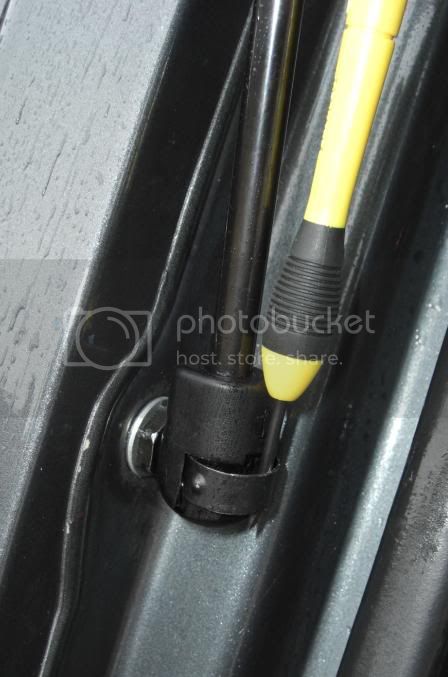

I installed a set of hatch supports sourced from liftsupportsdepot.com and they are plug/play. Liftsupports is offering 10% off with an end total of 48.40 shipped (more expensive than Reid's, I found this post late). They seem sturdy and definitely require additional muscle to close the hatch.
They come with ball joints that screw directly into the existing holes (all old hardware can be trashed). The shocks are very easy to install/remove since the retainer clip is exposed and accessible with a small flathead.

I just replaced both shocks using the ones from Lifts Support Depot Whole job took about 10 minutes. I put some acetone on the balls to break the Lock-Tite, The new set came with new balls with the correct threads and as far as I can tell the shocks are the exact same specs as the originals. Only difference is the locks on the ends, they are the band type, not the wire type, as shown in BG's pic above. And Very satisfied, even the sockets came pre-lubed.
