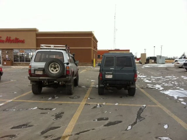

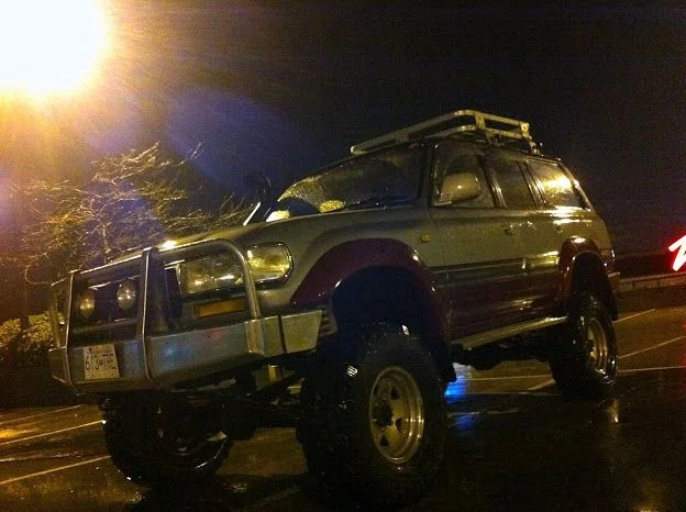

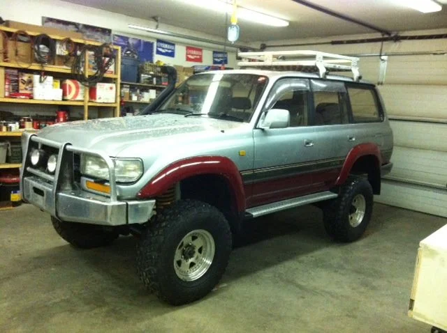

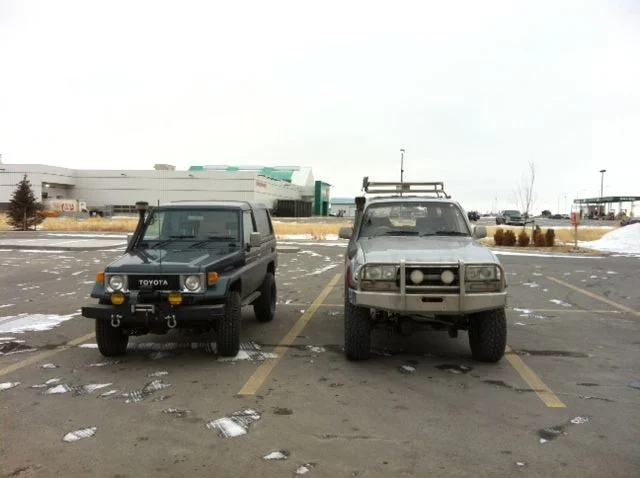

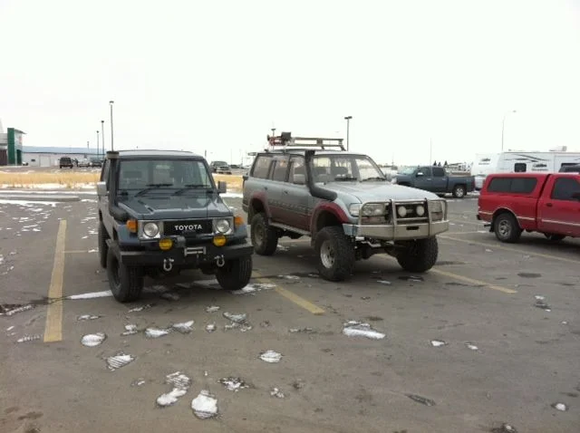

I'll add some pics and let you be the judge of that, lol..... A couple poser shots and one at the end of our long drive home parked beside my 1989 BJ74 with 3" lift and 33's
I was going to ask if it was the red/silver one. It is way too high you need at the very least to get rid of the spacers. I saw it in Burnaby, and the alignment is likely right on but the caster is likely way too low. with a 6 inch lift you are likely looking at Arms rather than plates... I followed it down hastings St in Vancouver and it was tramlining badly n the ruts...

Good lord that thing's tall! How tall is your garage door that you fit it in there with a roof rack? Must have been tight?
