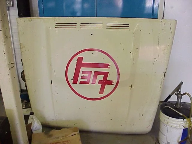

Only pic of progress so far.
The red was a test on a spare hood. I didn't think red would go with the green so well.
um... Wow... thats decent. wounder what mine would look like.

I guess i've lived under a rock for a while so this might sounds like a stupid question to all of you, but what is that simbol that gumby painted on that bonnet/hood? it looks nice btw.
i've seen it on the engine, oil cap etc. etc.
thanks
