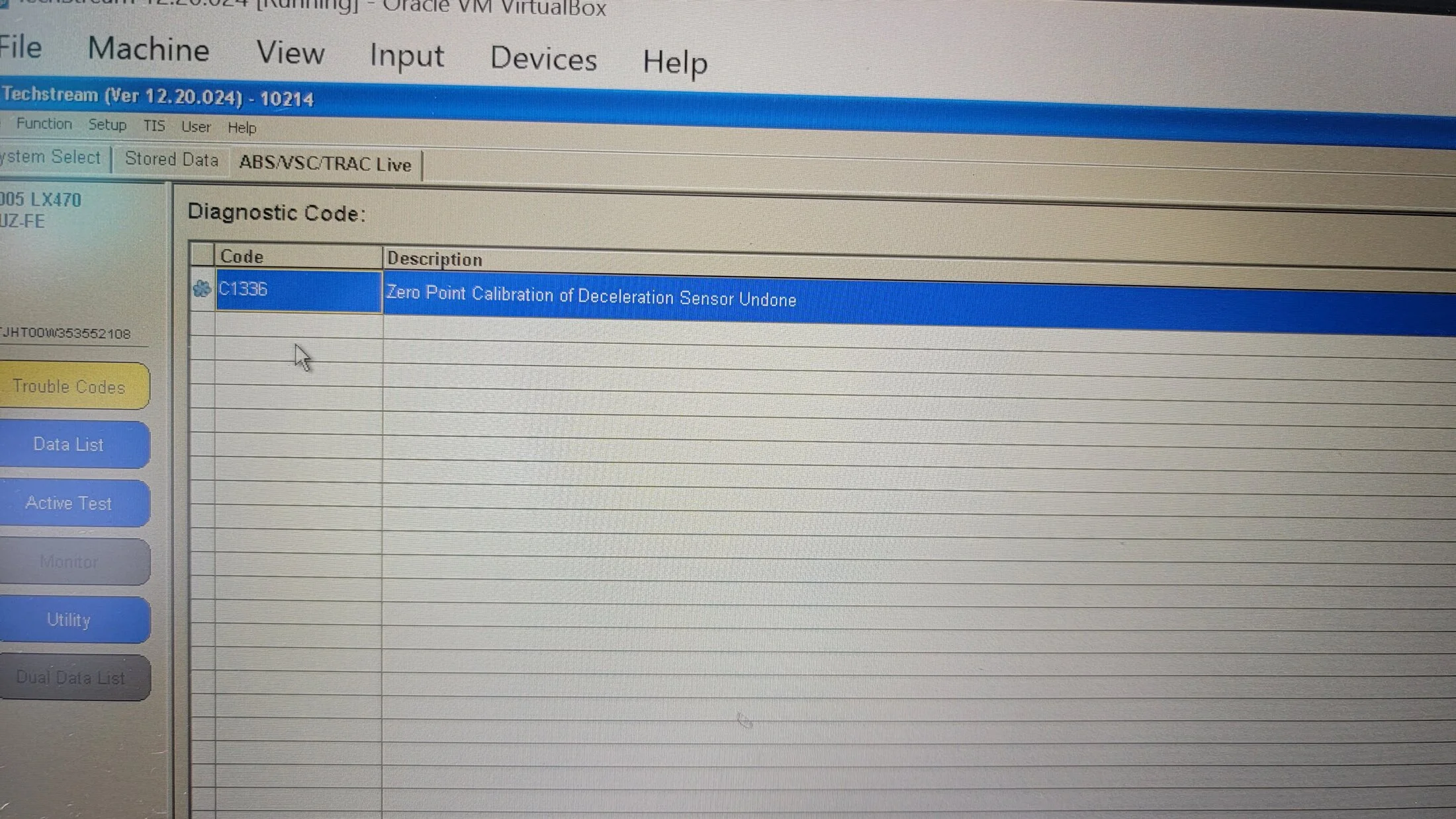

This morning I installed the 2 new rear ABS harnesses. I opted to go with "WVE" brand on Rock Auto as some posts here mentioned pulling Denso parts out of WVE boxes. I don't think I was so fortunate, as I couldn't find Denso anywhere on the parts, but I didn't find any other markings either. But, the brackets were correct and they had the correct number of the push-in plastic 'place holders'. I did need to adjust the position of some of the clips just to give the right amount of slack here and there. Took me about 30 minutes to do the pair, which included 2 minutes of looking it over, 30 seconds to make the right side harness connector crumble, 2-3 minutes of cursing, and 5 minutes of contorting myself to tediously pick out the remaining plastic of the original sensor side male connector.
Before replacing, I'd disconnected the battery to get fresh readings on the dash (and ultimately Tech Stream). To my disappointment, as soon as I put the truck in gear to exit the garage, the VSC lights returned. 2 more minutes of cursing.

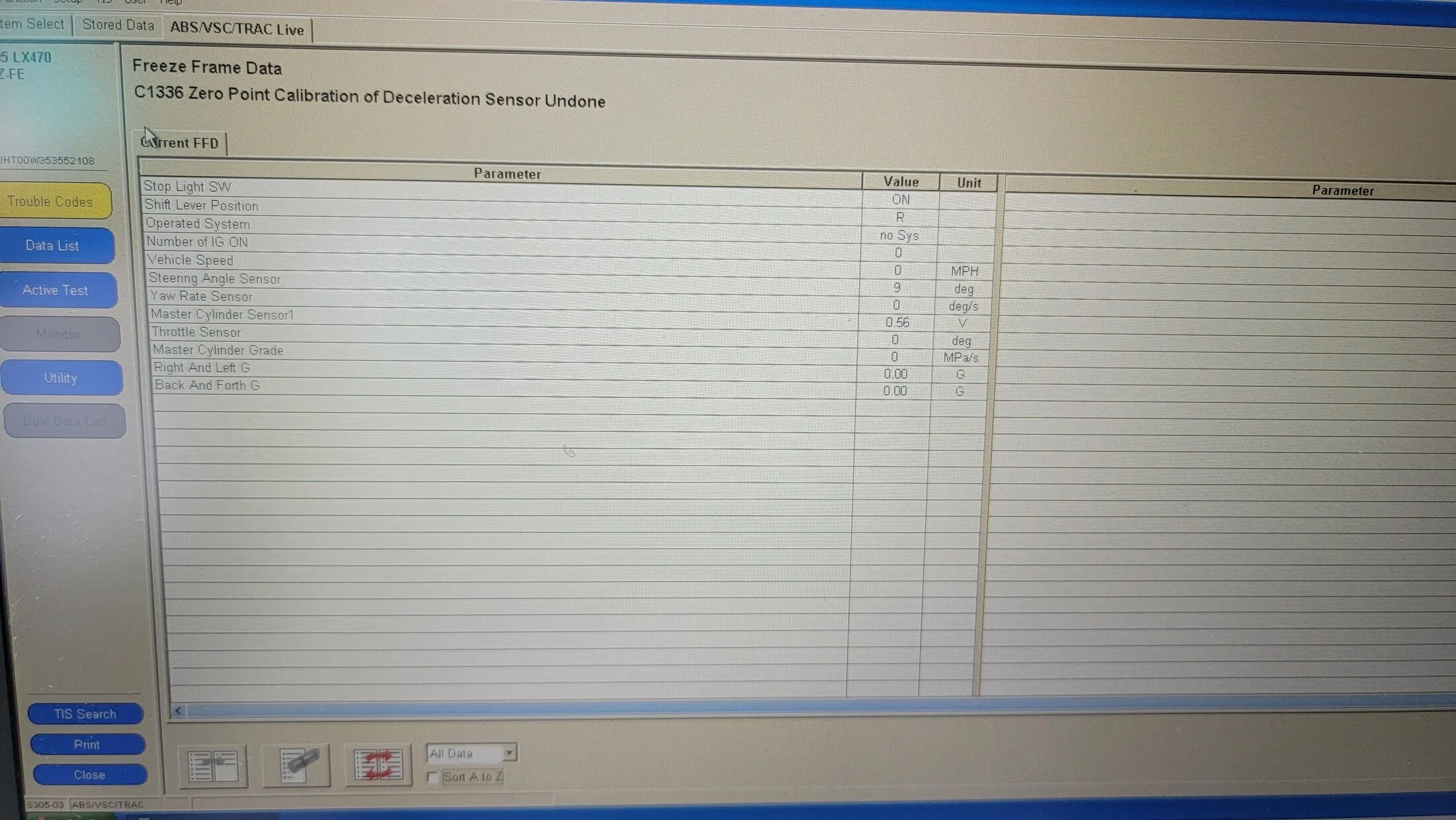

Then I hooked up TS to see if I'm still battling the same codes. Interestingly, I'm not! I only showed C1336, which was "Zero Point Calibration Deceleration Sensor Undone" or something similar.
Did a google, found a thread, did a fresh ZPC, and all is well! No more lights on the dash and my VGRS light behaved correctly (as far as it went away after doing some lock-to-locks and hitting 25-30MPH around the neighborhood. This is good as it was coming back at each key cycle the last week and wouldn't go away for a few miles at 50-60MPH.

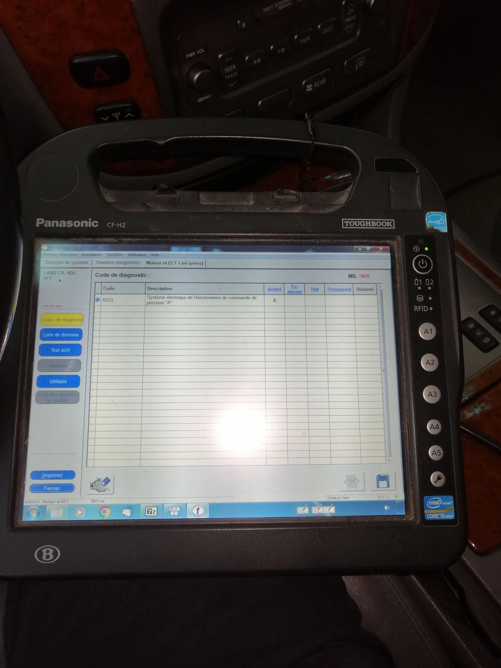

Bonjour,
Je suis en France, je viens de relire toute la discussion car j'ai un problème similaire sur un hdj 100 (diesel) de 2005. BVA 5 vitesses a750f
Après 15 kilomètres de roulage, témoin moteur, le toyota ne passe plus la cinquième.
Je contrôle les résistances des électrovannes, c'est bon, mais j'ai un doute, vu que le problème n'intervient qu'à chaud.
Dans le doute, je change de boîte de vitesses, je roule 15 kilomètres, témoin moteur, plus de cinquième.
Je change le calculateur moteur, le défaut revient mais systématiquement après 35 kilomètres.
j'ai un code erreur techstream 62(3).
Le faisceau de boite sur un hdj 100 fait parti du faisceau moteur, ce n'est qu'un élément, ce n'est pas facile à trouver.
Donc, suite a vos infos, je vais tester le capteur de vitesse sur la transfert, si cela ne change rien, la commande de changement de vitesse...
Le truc, c'est qu'a chaque fois il faut faire au moins 40 kilomètres pour vérifier.

Salut France !
Vérifiez définitivement les 2 capteurs sur une transmission et les 2 interrupteurs à l'arrière de la boîte de transfert. J'ai fait une inspection visuelle rapide de l'ancien faisceau de câbles l'autre jour et j'ai trouvé une zone où un court-circuit aurait pu être possible. En remontant en arrière, je crois que c'était le connecteur du commutateur de prise en charge L4 de la voiture de transfert.
Je ne reconnais malheureusement pas les codes que vous affichez.
