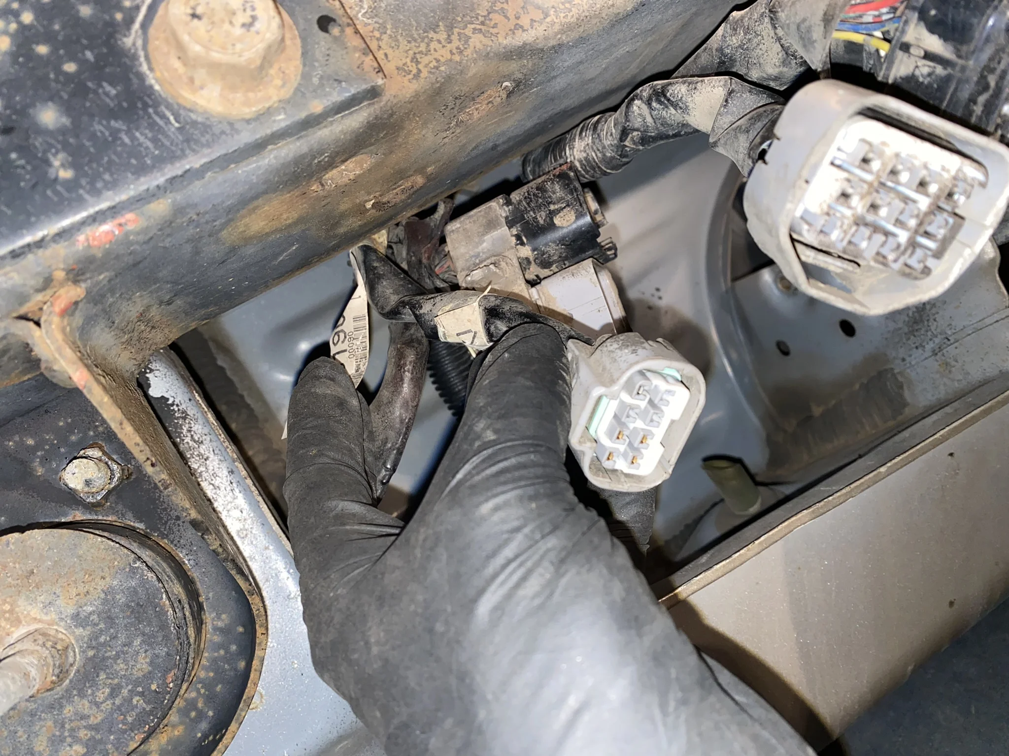

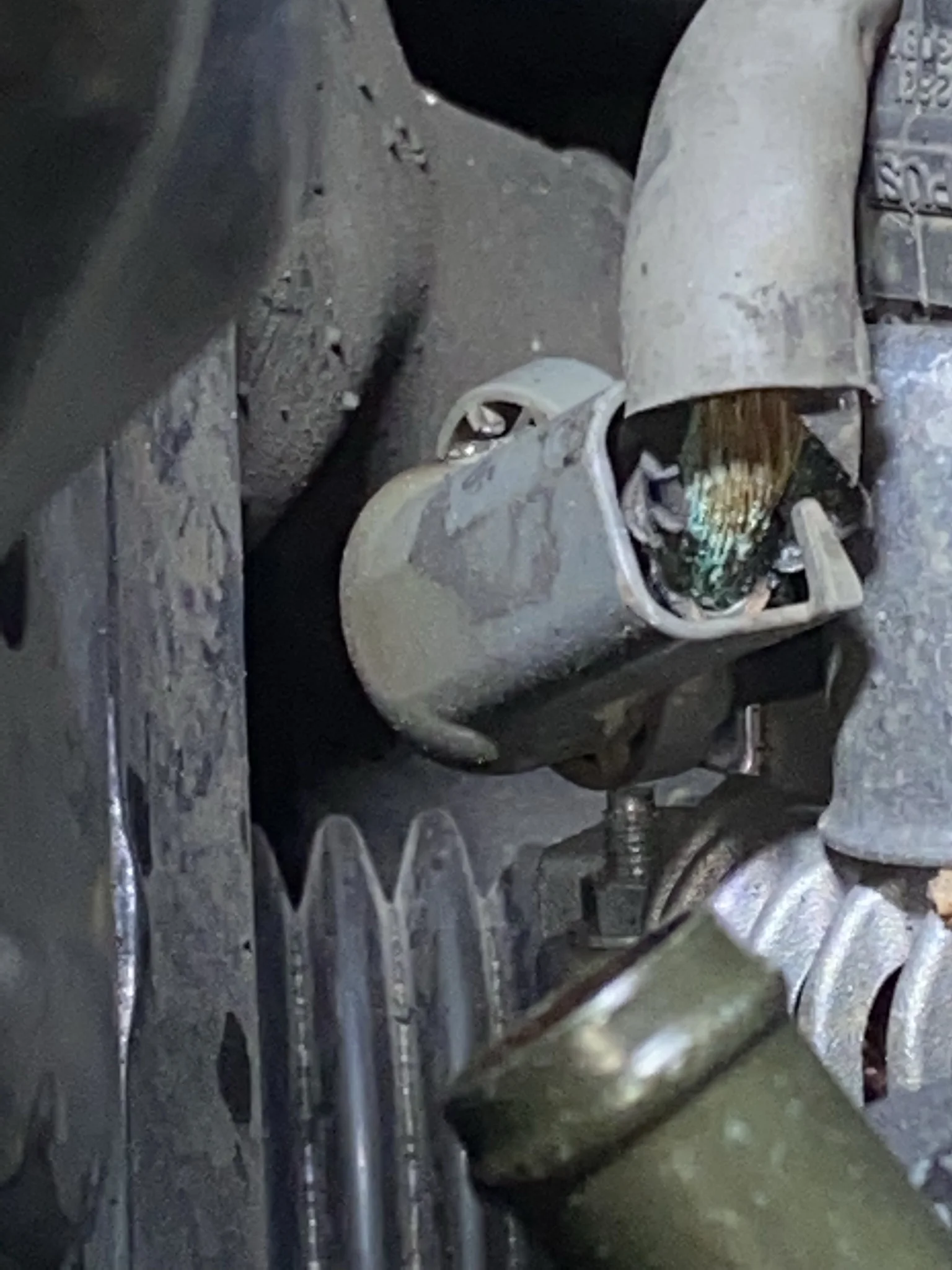

  1. Brake booster motor permaturally fail, due to high resistance in brake control wires. This one easy to spot under boot at lead screws connection.

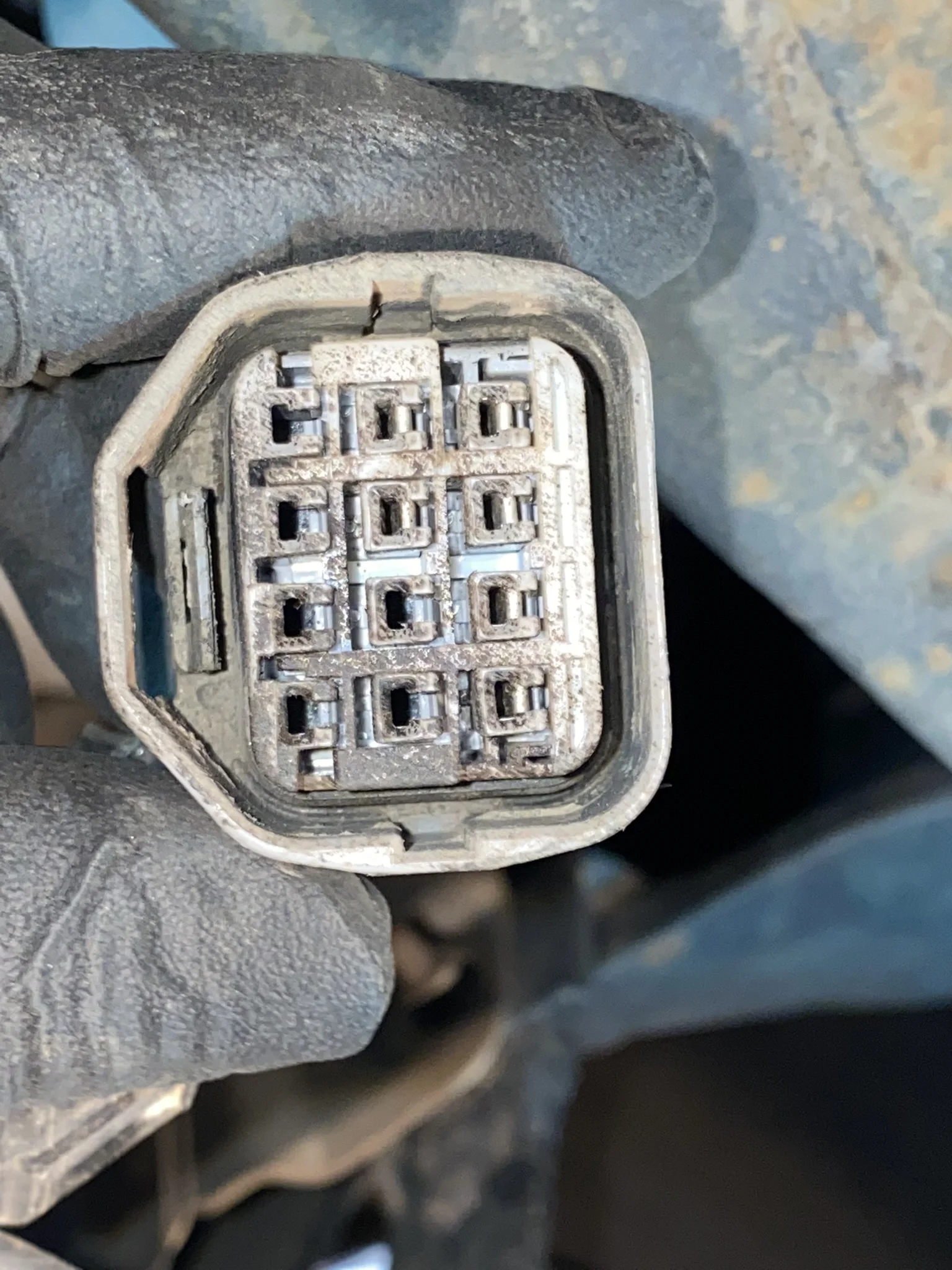

  2. HVAC issues due to ground fault resistance. Was two part. One resistance at RH junction box ground fault and bad main lug harness connection to RH junction box. This one 1/2 dozen Dealer ships and specialize tired to fix, unsuccessful over 5 year period.
  3. Watertight AHC wire housing block, with signs of water entry.
Brake control wire. Easy one:
Clue RH junction back had water entry,
Clue 1) knowing windshield replaced and had water leak in past.

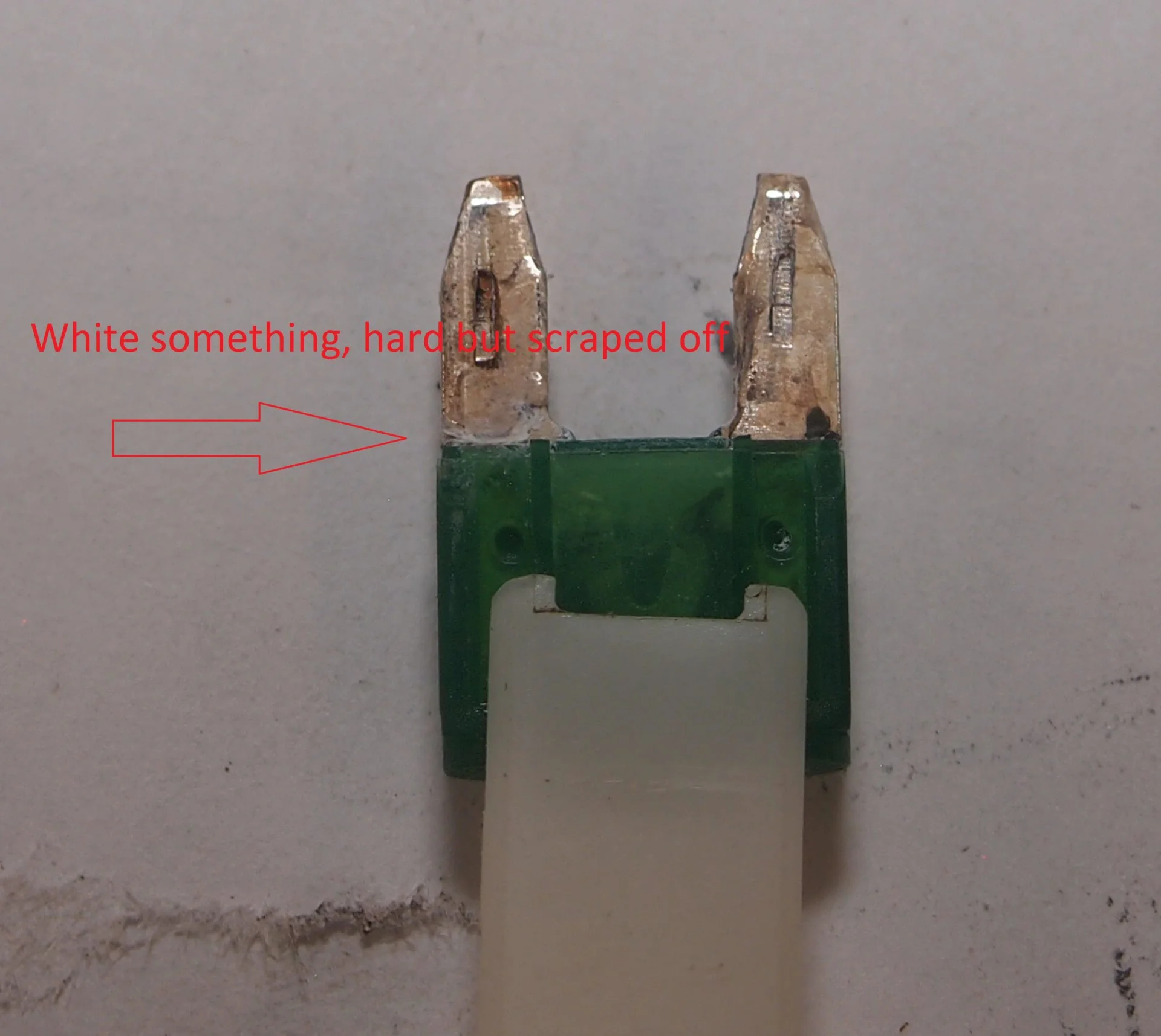

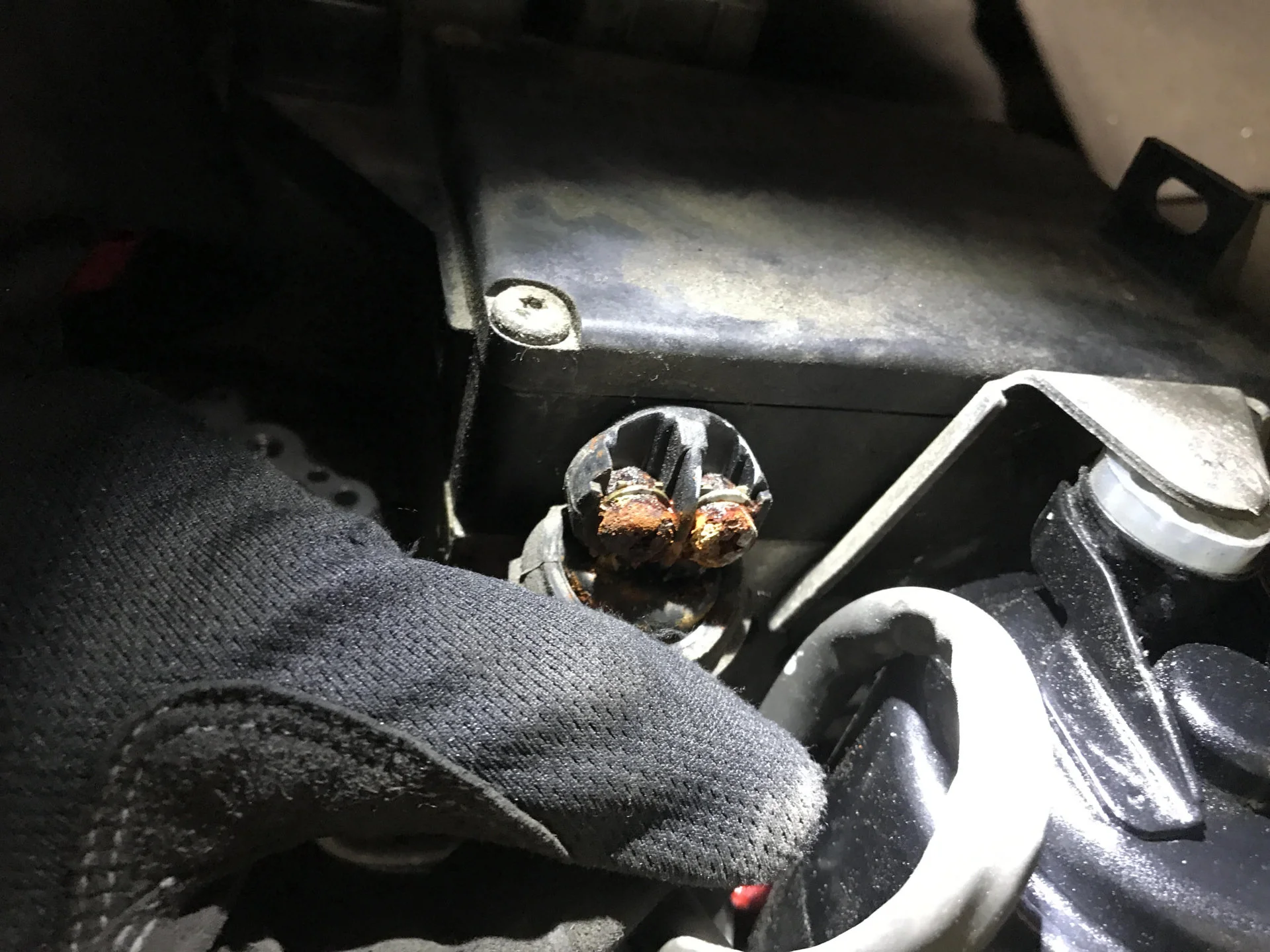

Fuse in RH junction box, stuck and had oxidation

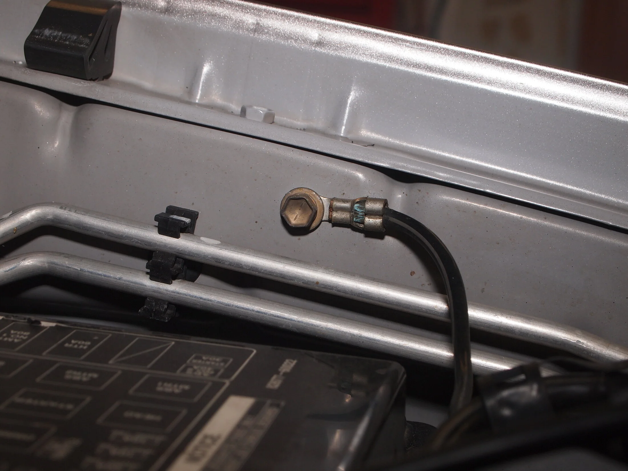

Wire blocks, with signs of less than perfect seal. Resistance.

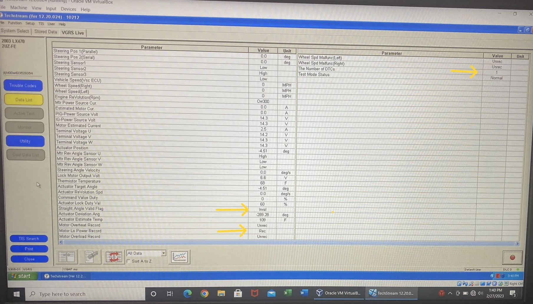

However, the VSC lights (and only the VSC lights, no BRAKE or CEL) are still present after stepping on the brake pedal to put the truck in gear. Additionally, the VGRS light has come on at each key cycle, even though it's cleared itself during each drive. Is it possible this is a vestige of the ZPC that will take some more mileage to work its way out completely? FWIW, although I've been driving my W126 for a few weeks, the steering does feel a bit 'off' running down the road at 60MPH. Not bad, just a little more responsive/jerky than I'm used to it being. Again, could be me being used to the old Benz.

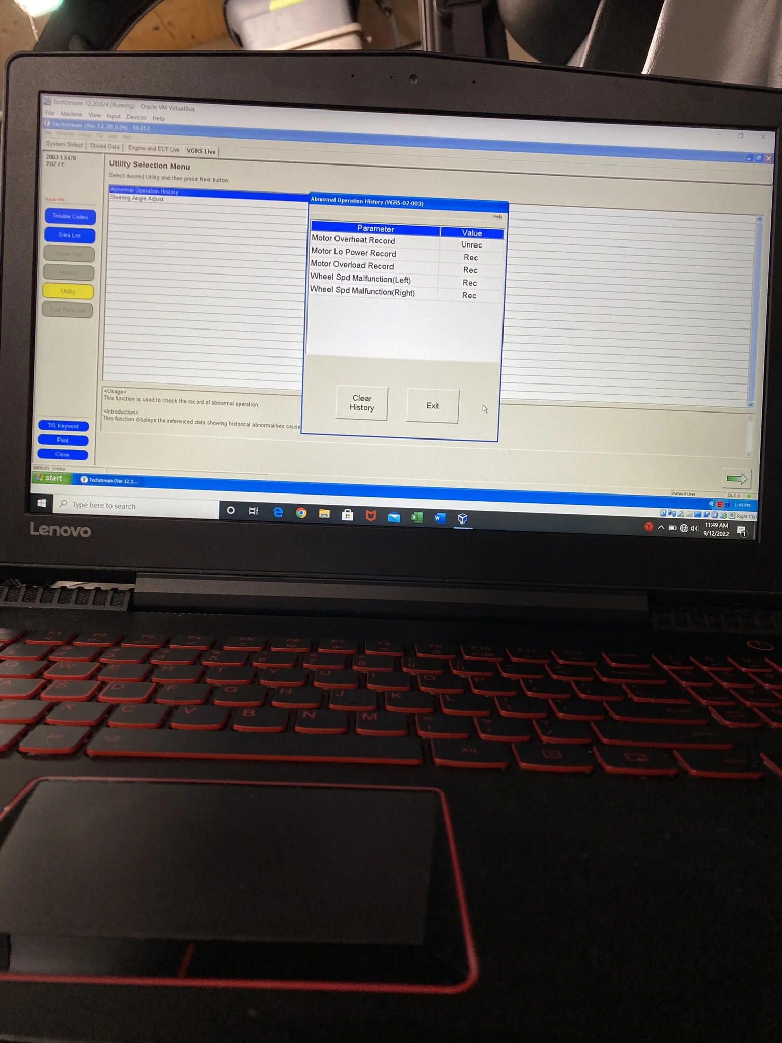

Make sure to clear (REC) from VGRS. There is also a very long calibration of VGRS. States only needed when VGRS CPU replaced, but hey worth a shot.
