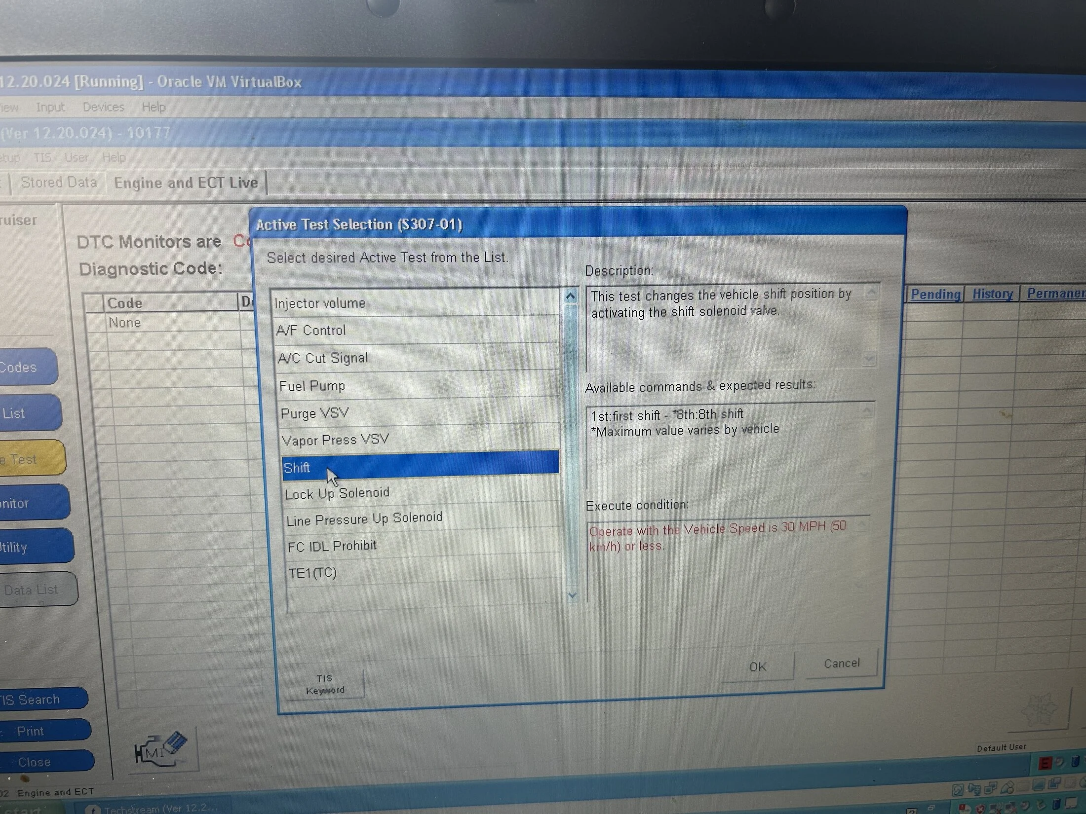

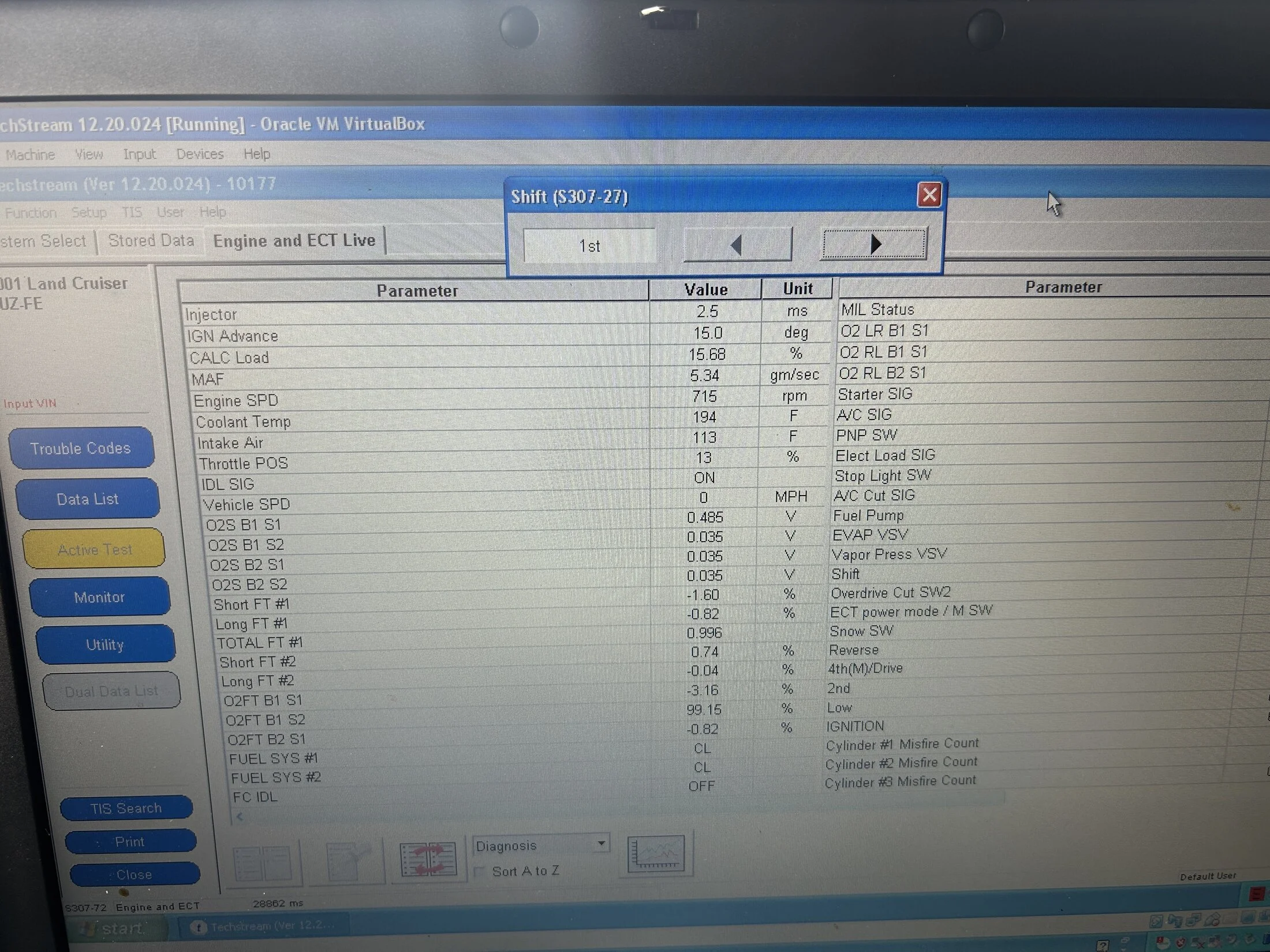

Isn’t there an active test that allows you to manually shift gears using techstream while in motion? Wondering if TS would be able to shift into 5th if that wasn’t previously attempted.
If there is I would love to know about it. I've driven with TS hooked up and watched the truck recognize its shifts from 1-4. It also recognizes that the gear selector is in D in real time. If there's a manual override, I'd try it right now.

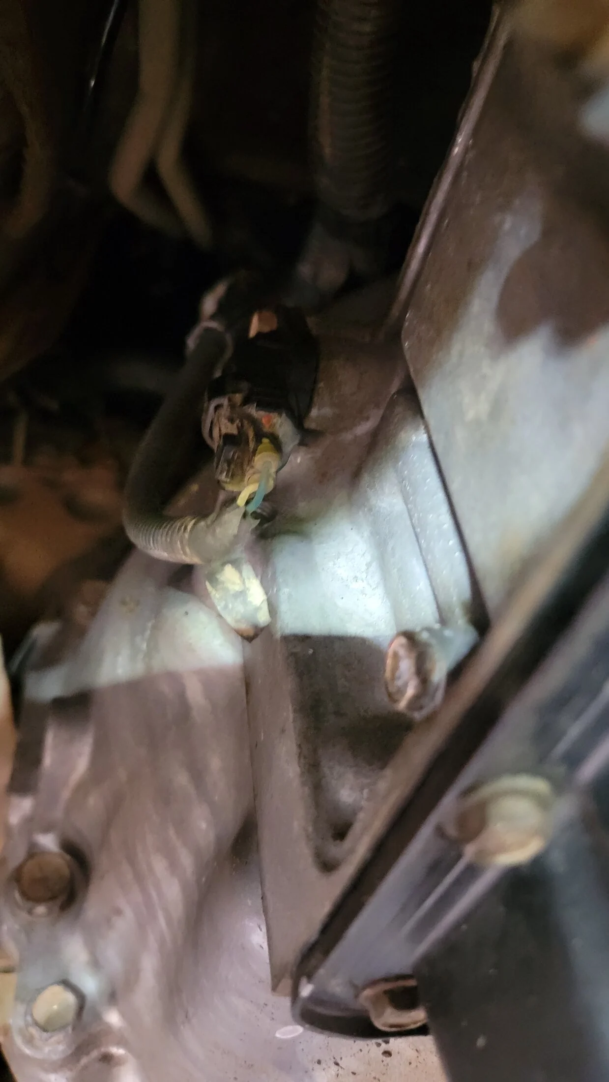

But during my underside inspection just now while jiggling, I found this speed sensor (I think? ) connector on the driver's side of the trans smashed with the backs of the pins exposed. Doesn't look recent, but if it's the issue, this connector is a part of the harness I just ordered.

this is on 2001 LC so different model year but maybe you’ll have same function. This is found under engine and ect, then select active test, then shift.
