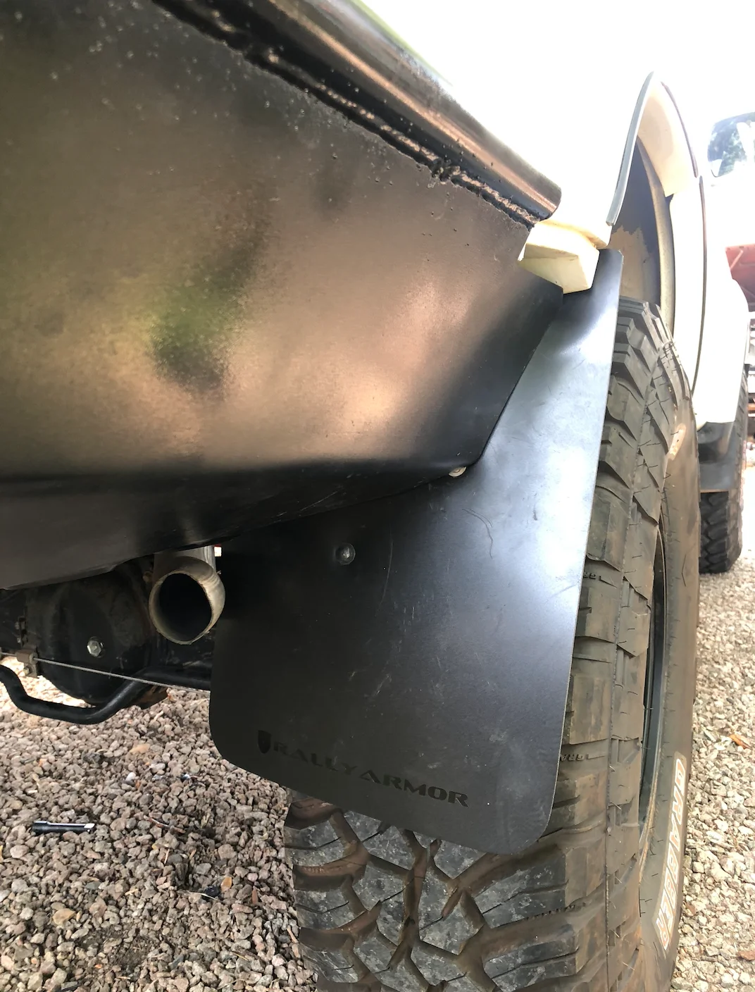

Here is my solution:
Trimmed Rally Armor from Amazon. Used OEM mounting locations with OEM hardware.
Images below. Label from amazon:
Rally Armor MF20-BAS-BLK Black Mud Flap with Logo (Longer Universal Fitment (no Hardware) Basic Plus)

On the exhaust side, I used same set up as photo I posted above. Only difference was I trimmed a section out so it did not interfere with exhaust. I am not running stock exhaust though, so your situation may differ.

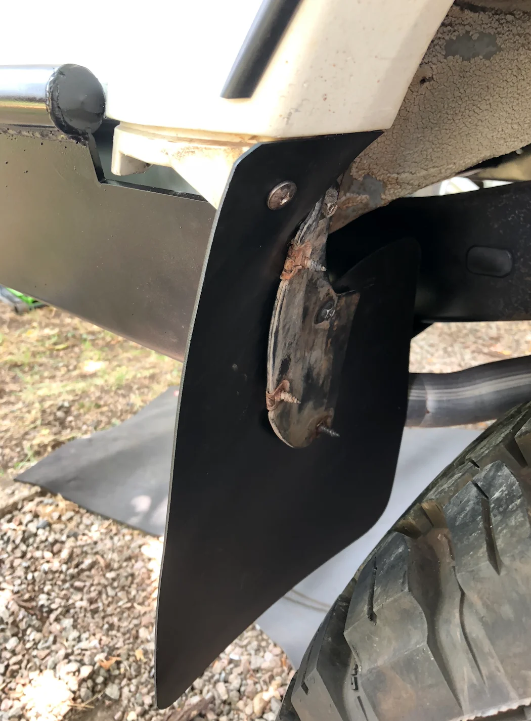

Update on mud flaps - Found a better/ more secure way to mount muflaps than the way previously posted (by me above). I decided to reuse the factory mudflap insert thing. This allowed for more mounting points, and more support.
Here is how it turned out:
What made you change it up? Did the original mounting points/flaps you used in earlier posts not work out? Tackling this soon on mine as well - thanks @crtx .

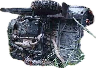

My truck doesn’t have the factory flares anymore. I welded a bit of 1/4” flat bar at the front of the wing. My mud flaps are 3/8” conveyor belt cut to shape and bolted to the flat bar. They extend up into the wheel arch to cover the hole between the bar and the body.
Like in this picture.
Unscheduled chassis inspection.
My truck doesn’t have the factory flares anymore. I welded a bit of 1/4” flat bar at the front of the wing. My mud flaps are 3/8” conveyor belt cut to shape and bolted to the flat bar. They extend up into the wheel arch to cover the hole between the bar and the body. View attachment 3479216
I'll gladly work on my garage floor instead of ever seeing this angle...oooffff! Hope all is well with the rig, and thanks for the alternative angle shot.
