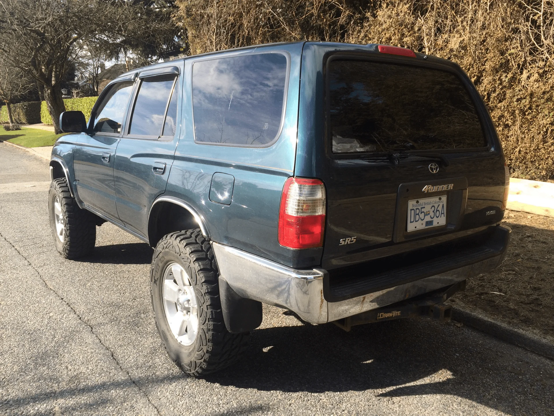

Honestly it's probably going to be a 2nd or 3rd gen. Both have their advantages.
The 2nd gens are cheaper because of the 3.0 3vze engine. They're also easier to do a SAS on them because kits are readily available. And easier to do a RF1A Marlin dual transfer case because the passengers side t-case drop. And 2nd gen 4Runners already came with an RF1A for the 4-cylinder trucks.
The 3rd gens are more common generally. But way less common with a 5-speed. They also have a few nicer amenities. Plus, they came with a factory hood-scoop. I know I want an intercooler for the turbo diesel, so a top mount intercooler with factory hood scoop would make things clean/simple. The drivetrain work would be a little more intensive to ultimately get the truck the way I want it: less common 5-speed, driver's side t-case drop, less common SAS kits, etc.
But imperial jade mica is one of my favorite colors.
Ultimately it will boil down to the fit-and-finish of the Doomsday Diesel kit offerings. If Doomsday comes up with something really clean for a 3rd gen swap, then I'll go with the 3rd gen.
If the 3rd gen requires some heavy fabrication or large concessions to make it fit (cutting crossmember, radiator core support delete, hood latch delete, A/C delete, etc), then I'll go with a 2nd gen.
