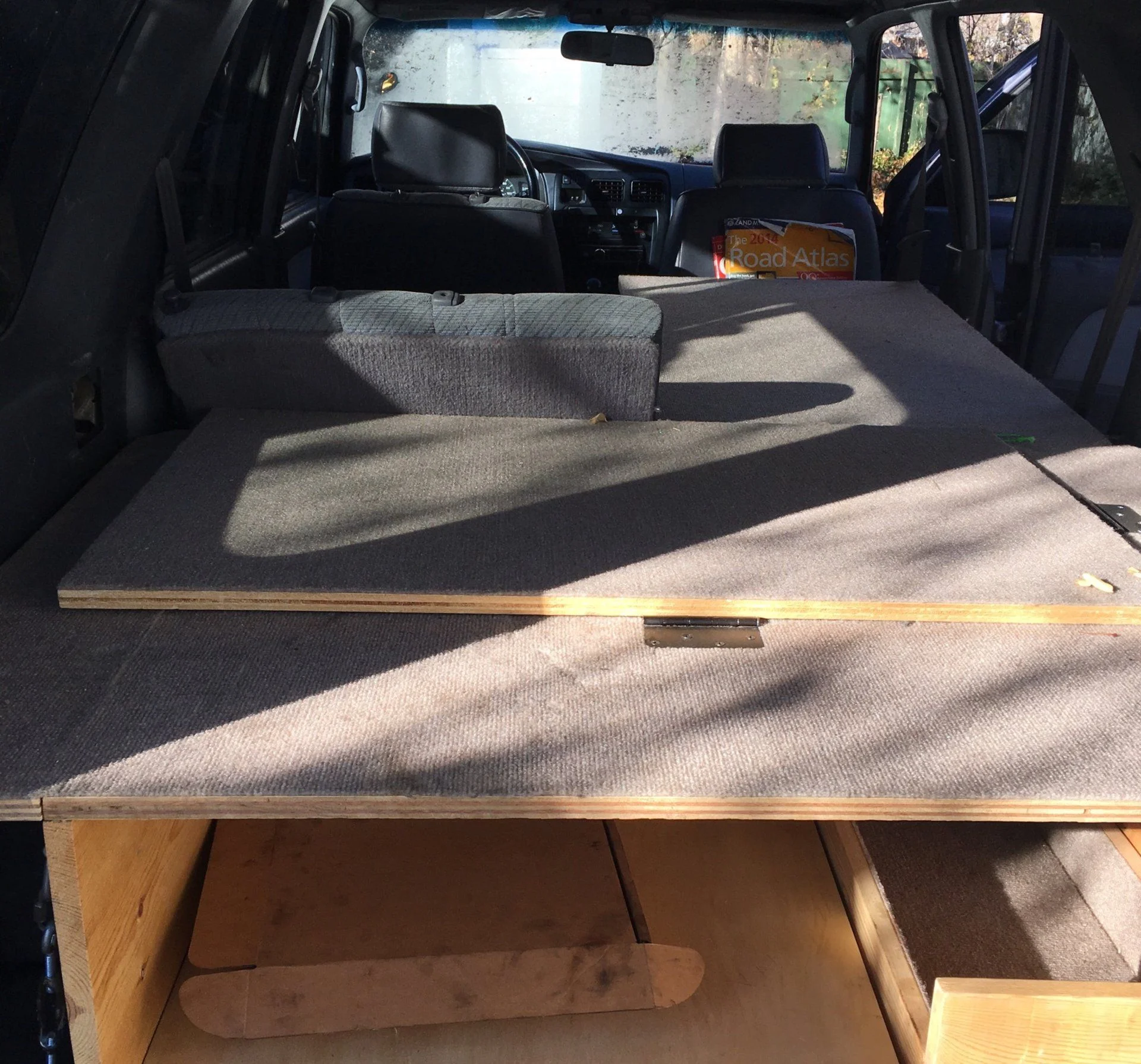

Did you end up going with a 3rd gen? I built a platform that is semi-permanent in the cargo area, with leafs that spread it out over the rear seat bottoms when they’re folded down. Gives me 6’6” of length but not a lot of head room
I built a platform in the back of mine. Semi-permanent as the cargo area stays and I have a separate piece that I can put in when I take the back seats out. This platform allows me to put approximately a standard full size mattress in. Mine is actually ~52"x73.5" and all foam so that it can squish around some of the plastic that sticks out and takes up a bit of space. My platform is 6" tall with a 6" foam mattress. Pretty nice inside. Bit tight on head room but I manage... It was a whole lot cheaper than a RTT so that is why I went for it.
