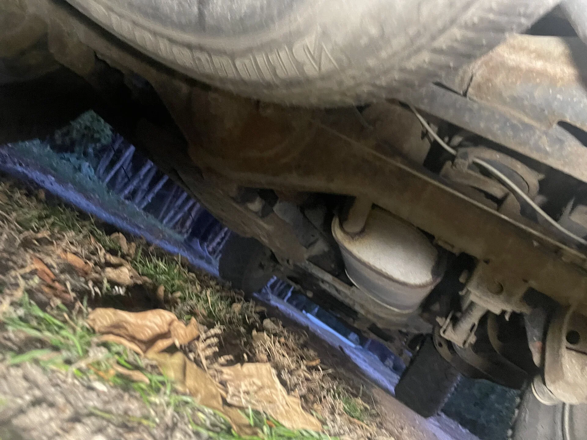

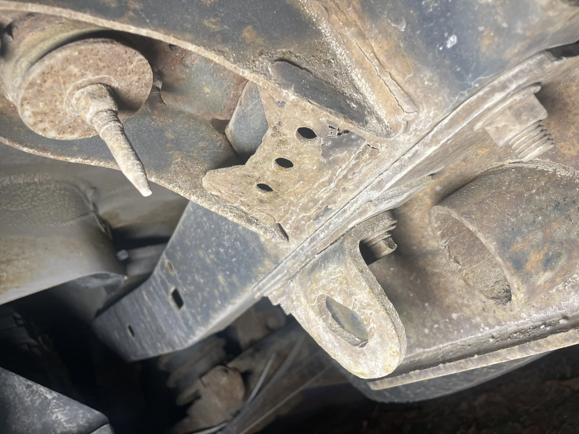

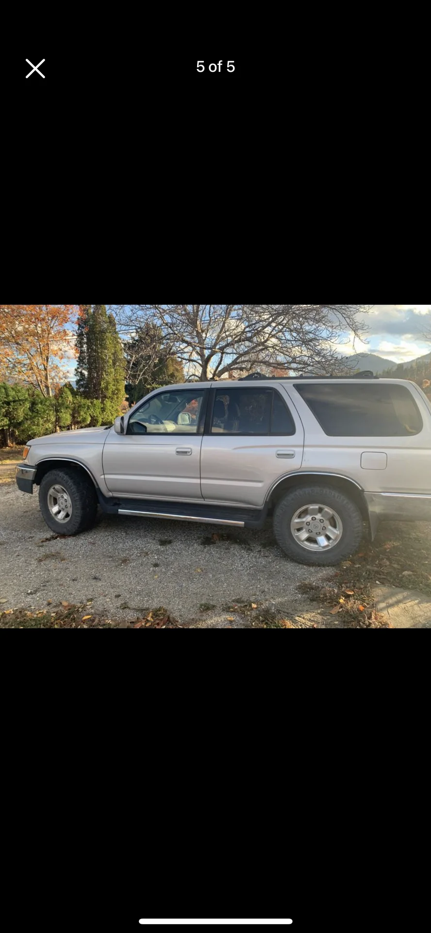

I need a new daily driver.
SR5 v6 4Runner, 320,000 V6 Manual transmission.
This vehicle popped up for sale down the road from me. Asking $5900. Should I buy this? I’m looking for a new Daily driver and am not looking for a project at all! The vehicle has some body rust, and is well used, but runs and drives well.
I’m trying to buy a car that will get me from school and back reliably.
I don’t want to end up buying something that I’ll regret money wise… does $5900 sound reasonable?
Here are more pictures.

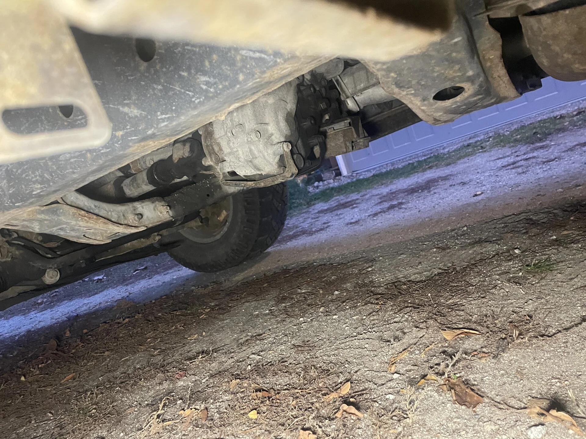

@Gimme a 60 Do you do vehicle inspection in your area? have it inspected and see if it passes including if any emission test. The price is not bad at all my 99 4Runner is pushing 380k miles ( reman engine @ 235k) the 5speed is a good thing to have.
If you do buy it replace the ball joints before you get too crazy driving.

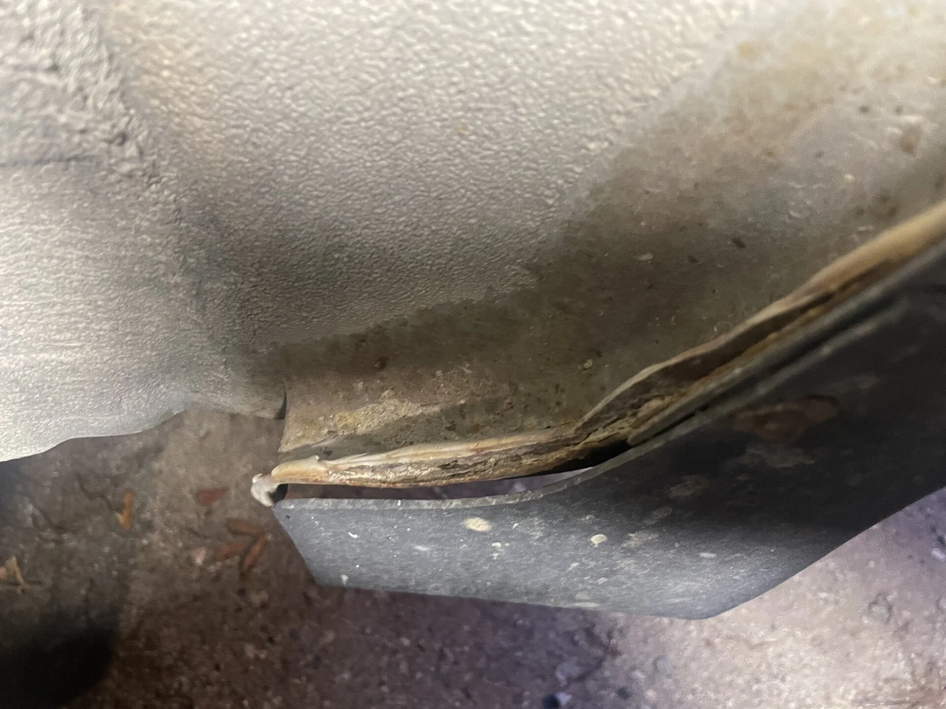

X2 on the ball joints. These have the crappy "fail deadly" design. Also check inner frame rails in the back, especially near the exhaust. They have a tendency to rust in this area. If the spare tire is in place, also up above it is a good place for rust to start.
I had one of these, and that's where the rust was present on it.
A friend had one of these in pretty good condition except the rear diff was leaking gear oil due to excessive rust. I though this was a weird place to rust through. He went to the trouble of replacing entire rear axle, then sold it.
Yours looks OK. Manual transmission is a plus. This model is highly touted by a lot of people as you probably know. Not great on gas but OK. FWIW, I didn't really like mine very much. Preferred FJ62 and 2nd gen 4Runner to it.
