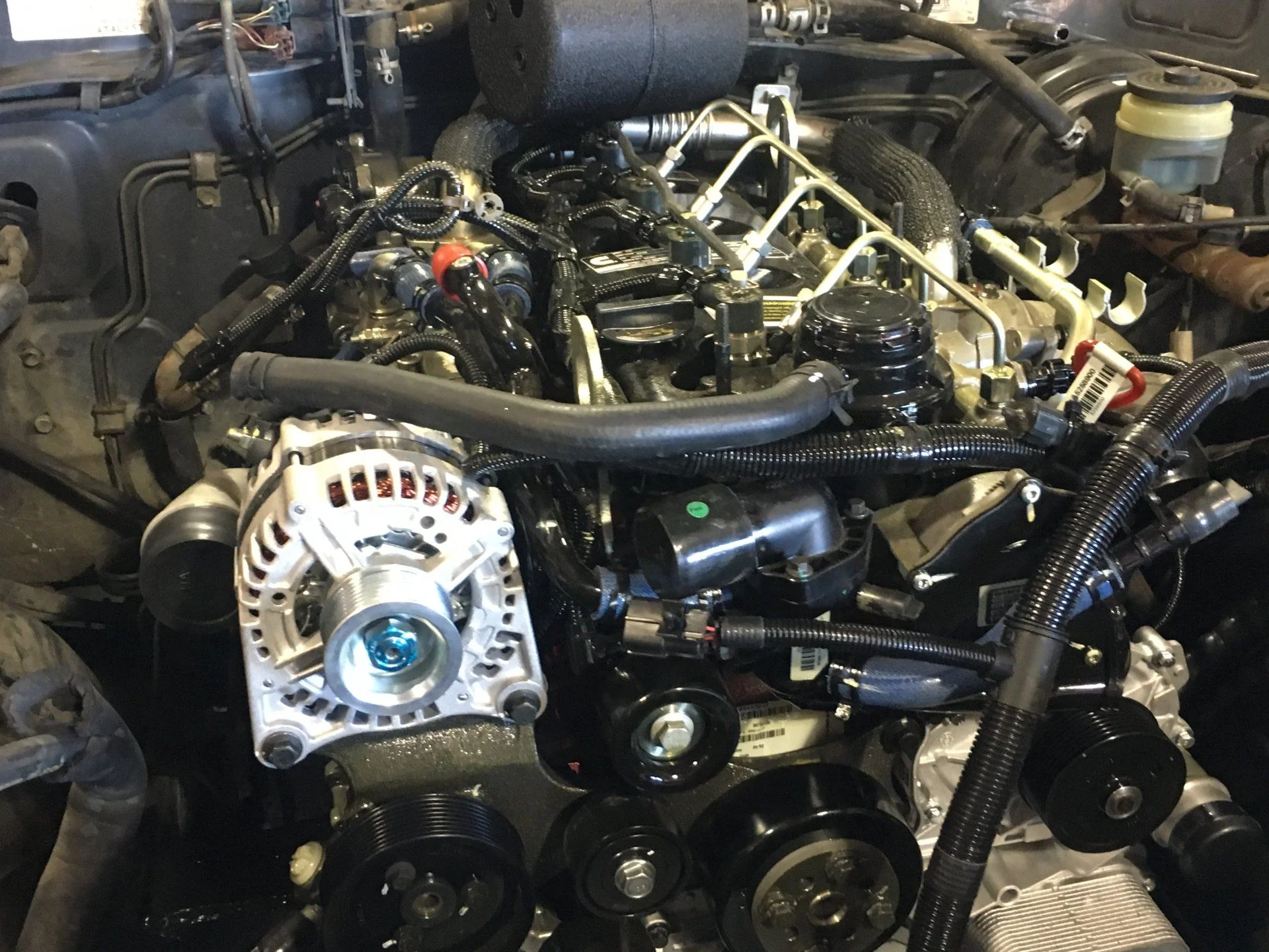

So you're looking for ones that come with an ECU in crate motor form (the 2.8 Cummins), or something that has aftermarket ECU retrofit support (the Cummins 4 ISB) or something that is mechanically injected and doesn't require an ECU at all (the Cummins 4BT).
The only other "American" 4 cylinder diesel I can think of is the Duramax 2.8 and that would be a one-off in terms of retrofits. One-offs are expensive and the opposite of plug and play.

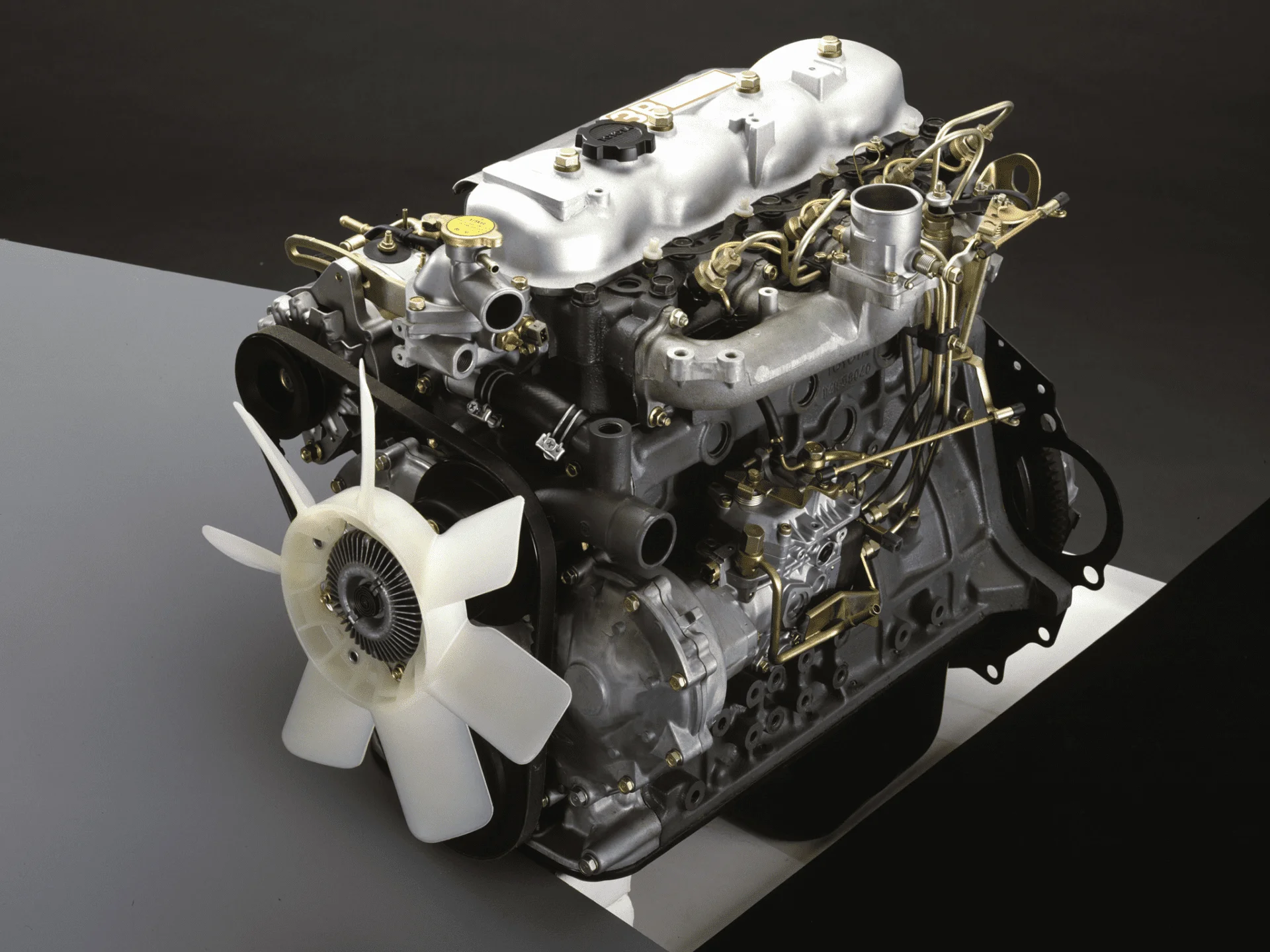

So let me clarify, it is a American 60 series with a factory 3B motor, I would get the whole rig.
So a BJ6x 3B motor? Slap an intercooled turbo on it and throw it in there. Post pictures. :popcorn:
Although that's a lot more straight forward for a re-power, but I wouldn't say it's "easy". Swap drivetrain, and fuel/exhaust systems over, swap in all the vehicle's 24V gauges and electric motors, lights/lamps etc...
I saw a post on FB. Real nice new Cummins 2.8 conversion into a 60. He had a shop do it and when the final bill came it was $28,000. Ouch! He loves it and claims to be getting 28 MPG.
Every North American spec (ie. Canadian) BJ60 I have ever seen is a 12 volt 3B engine vehicle, so perhaps no 24v issues as north west overland implies.
if you have a whole donor BJ60 then that's as easy as a diesel swap gets. Turbo and intercool so you can actually go more then 50mph
If you have a full BJ60 donor, then a very straight forward swap. Not a very powerful one, but there are turbo options and such.
