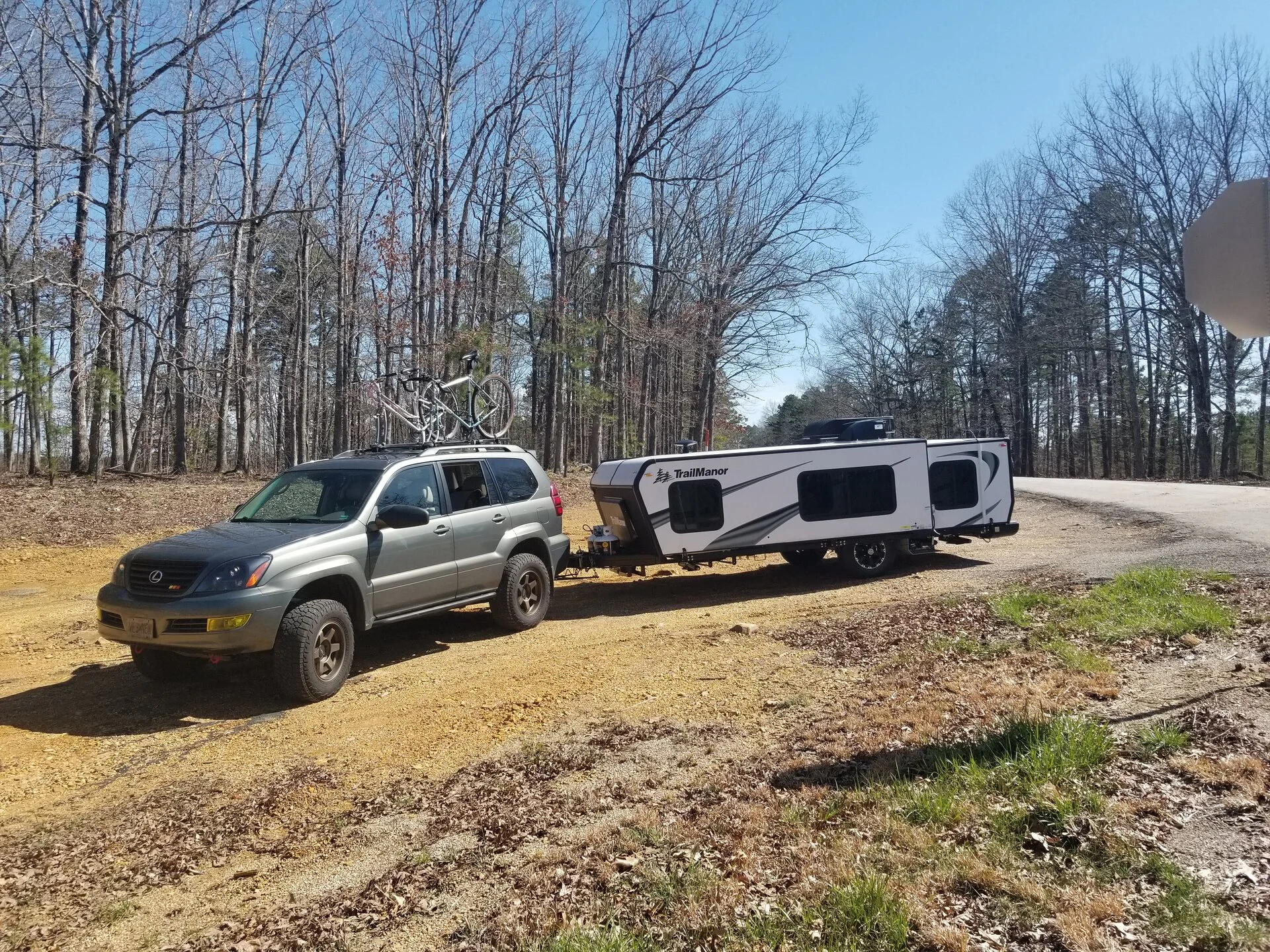

Gx and a Trail Manor… was my plan.
Please post a photo.
I believe your idea with the 2400 watt 250 LC would be excellent
We defintiely get some interesting looks pulling a oddball camper with an oddball rig like a GX :). The TM has been great, tows like a dream. 70 mph is no problems and I could tow faster if wanted. We've done 700 mile days in it.
LC250 power would be inadequate to run the AC, but would enough run the fridge (with propane as a primary power source) and forced air heat (propane as the source), plus lights, all evening. It would be perfect for cool-weather camping.
Nice man… I’ve looked into that camper.
Exceptional design. Low profile and light weight as well.

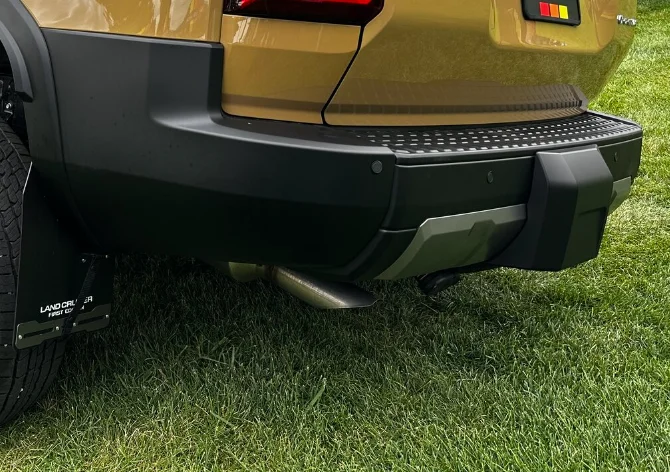

Perhaps look at the Tail pipe of the 250 it’s set far enough away from rear hatch (A metal dryer tube can redirect exhaust to the side if needed), then look at the design of the Free spirit Rear tent for Suv’s

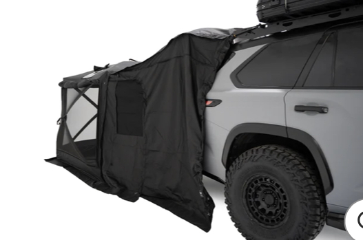

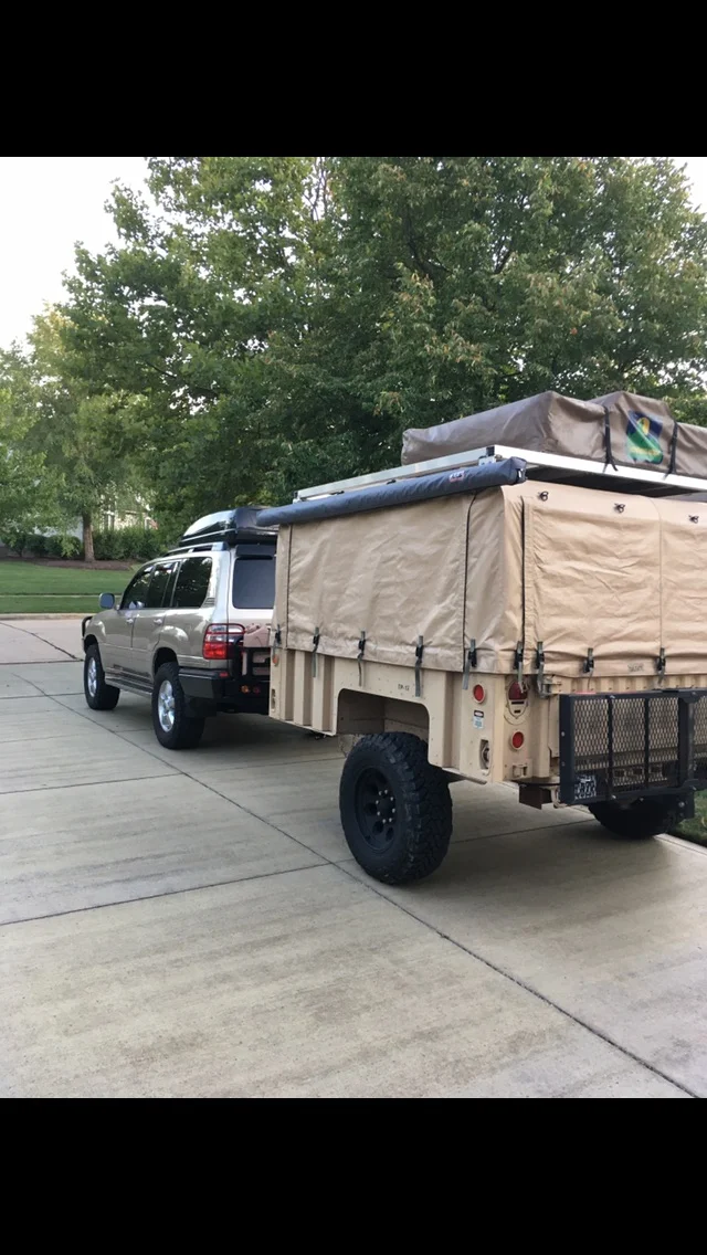

So here are some photos
Yes Id prefer a camper
Yet like many… A Rtt with annex, and a Awning enclosure is convenient to have on the trail or whenever.
A little heat and Ac is pretty cool.
Obviously………… Co2 is top priority above all else and a Co2 sensor would be used.
Redirect the exhaust away from the Rear tent… of course.
If safe… this is a neat option

This exhaust dumping into your tent at night or during the day will kill off your family....
I have been camping out of the back of the Cruiser in this fashion for over 20 years. I would say I have some knowledge on this subject. Your not inventing the concept. Neither of my setups enclose the exhaust to further direct the exhaust into your tent. Any amount of engine on time will spew tons of CO2 into your tent... the first one is higher up and a stand alone, the second tunnels the hatch tent into the cube exactly like the one you post. Both suck stopping CO2 dumping inside for even 5 seconds of engine run time.
Your right on the Toyota Hybrid, zero experience on this but I have camped all my life and experimented with Inverters for a long time. They just draw too much power to run constantly and a 2400 watt isn't as big as many may think it is. It makes zero sense to plan a base camp around an inverter, especially if it will intermittently start to charge the system. I do have a DC/ AC fridge and anyone with one knows not to run it off the inverter. Again, a conversion inefficiency thing. Run it direct of DC. My Dometic pulls 3 amps max DC. AC will pull much more, so again, unless you forget your DC cord at home, zero need for an inverter..
Run DC, solar and anything else but relying on a $55K ice motor, especially with a turbo, as a generator all weekend IMO. These vehicles will log engine idle time and anyone with common sense when buying a newer hybrid vehicle will check this. I'm thinking if this is your thing it may be much cheaper overall to just get a generator.
Have at it, just voicing my opinion the inverter/ hybrid system seems to have some cool possibilities, I would just research it first. At this time no-one knows how Toyota will let you run this system in the upcoming 250 LC, but I'm betting they restrict it more than you may think.
Not tying to rain on your parade, just saying you may want to research that dream before throwing down the $$$.
