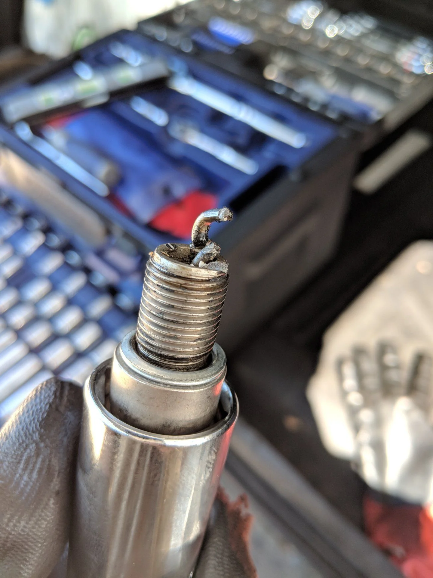

Oh, dear God!
Broken Valve that is floating around in the cylinder! I am basing that on the groove cut into the end of the plug.
Pull your valve cover and check the push rods and check the valve springs. You've got one loose!

Oh, dear God!

I've pulled the cover. Checked the push rods first and they were loose like I anticipated but not free or anything. Oh well guess I'll need to throw an LS in it.
If this anchor of an engine comes out, it's not going back in
This one's not just a head problem anymore. Whatever is rattling around in that cylinder has eaten the piston as well as the head, maybe even the cylinder wall.
