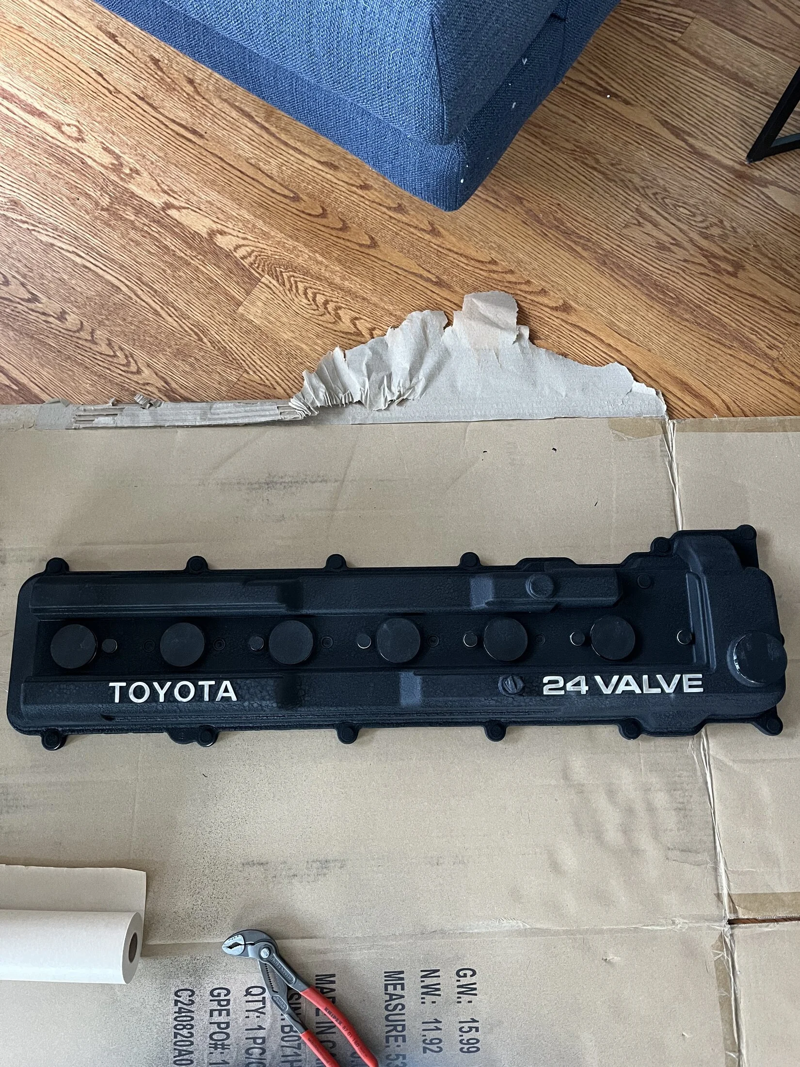

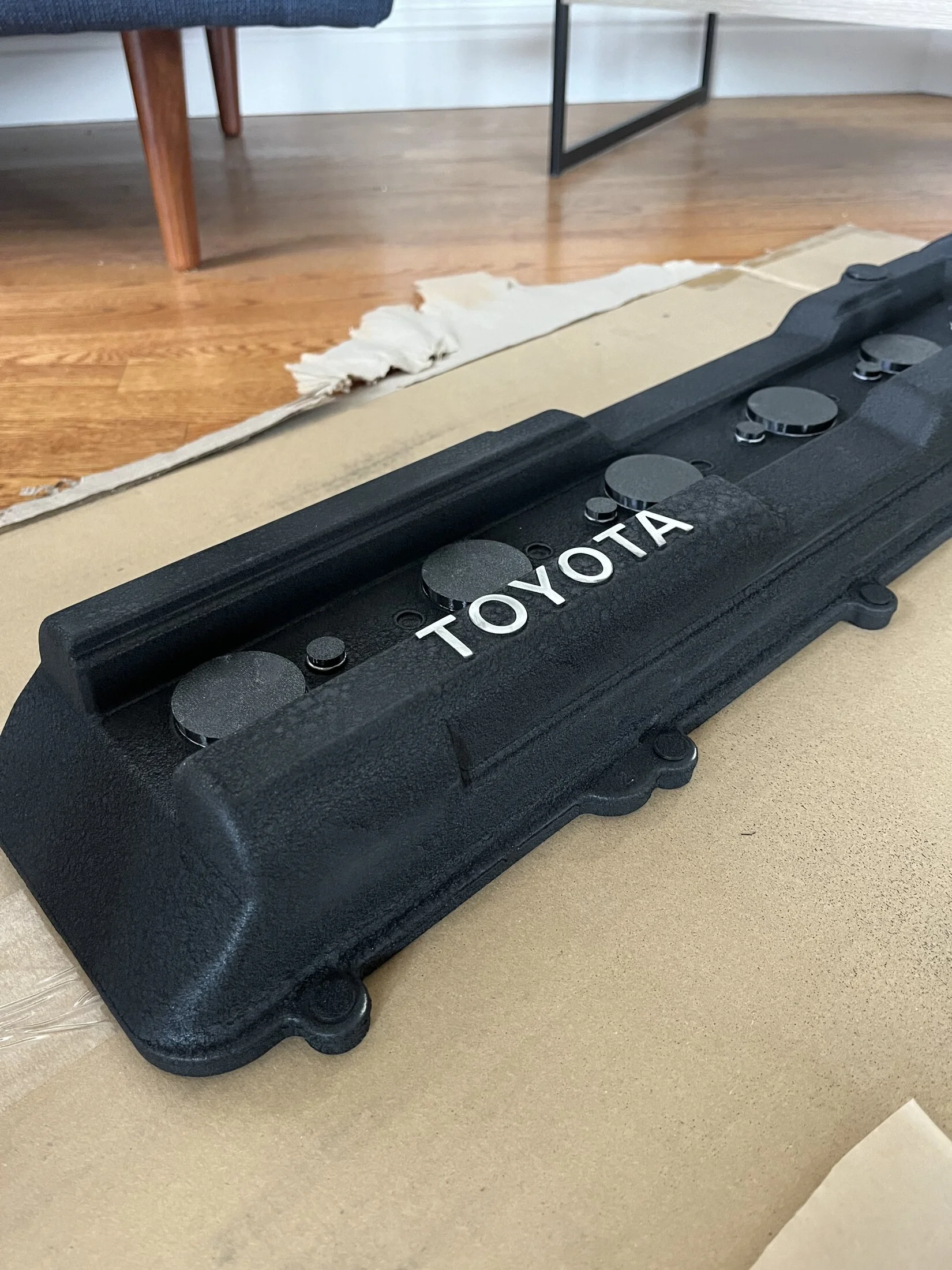

I just painted my valve cover, and decided to design/print some simple plugs to cover up all the holes in the valve cover while painting. No more laying down tape and trying to carefully cut around things! Just throw these plugs in and you're good to go.
Here's the print: 1FZ-FE Valve Cover Bolt Plugs (80 Series Land Cruiser) by godfatherofpancakes | Download free STL model | Printables.com - https://www.printables.com/model/1103083-1fz-fe-valve-cover-bolt-plugs-80-series-land-cruis
This will plug up every hole in the cover with the exception of the PVC grommet and the other oil grommet thing. So that includes:
  1. Plugs for all 13 bolt holes
  2. Oil cap plug
  3. 6 spark plug tube plugs
  4. 6 plugs for the plastic cover bolt holes
I printed this out of TPU and oversized the plugs just a hair, so they're a nice snug fit and won't move around or fall out as you handle the valve cover.

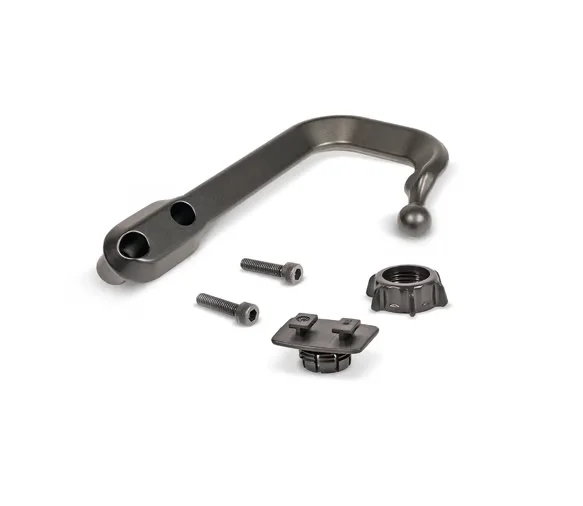

I am not a fan of RAM Mounts arms even though I use them I just find them to be wobbly. I despise suction cups to the windshield with every fiber of my being.
I'd like to have something similar to this for the pillar on both my 80 and 100. The ball at the end should be the appropriate size needed to attach to an actual phone mount that would go to it.
This angle isn't what I'm after, just the idea of having something fixed similar to how this one attaches to the handle on the pillar.

can you please post a link to this mount?

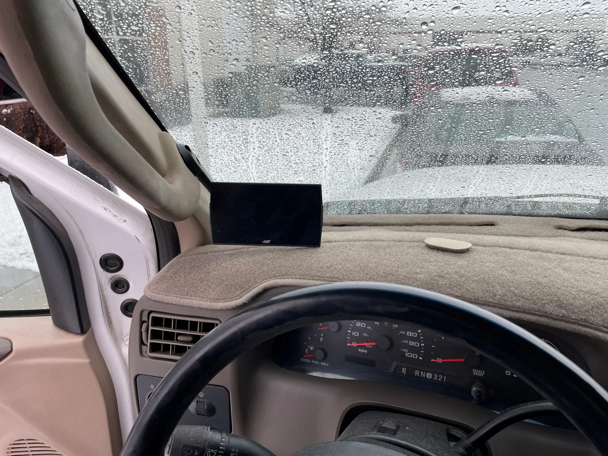

Appreciate the design and upload! Im just wondering if you've tried this over rough terrain? I printed one out as Ive also been looking for somewhere to mount my UV5R. It seems to stick out quite far from the dash and wondering if the weight of the baofeng will be too much for it. I am thinking specifically the legs that go into the dash wont be enough to hold it in place over bumpy roads. Ill give it a test myself but wont be able to get out until a couple weeks from now. Anyways, thanks again for sharing :)
I've driven through some washboard and did a easy/moderate trail without issue. It is a pretty snug fit so I think it will be ok? Time will tell...
What filament did you print it with? The ABS-GF I used seems to be pretty stout. I think I did 5 layers for the walls IIRC.
