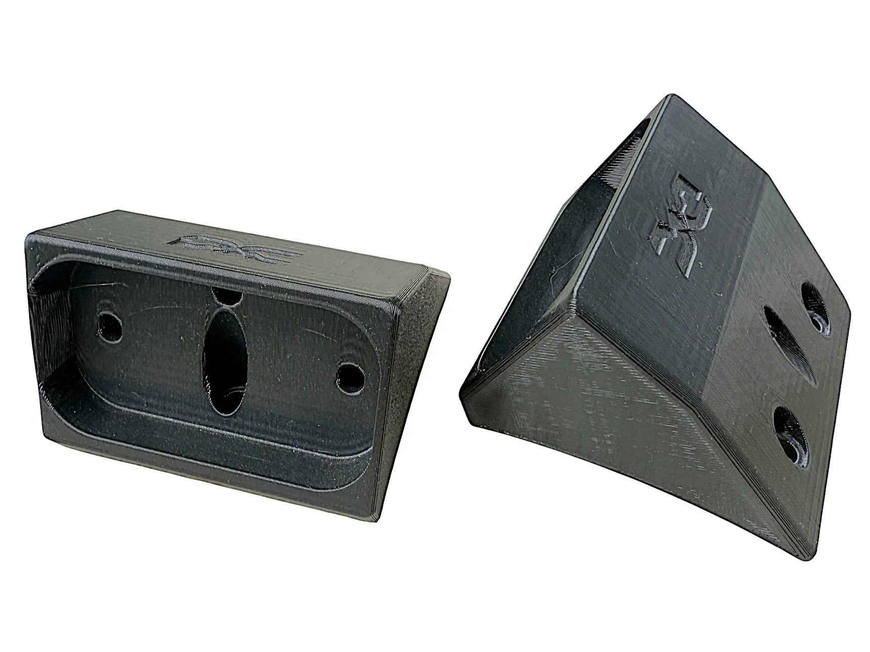

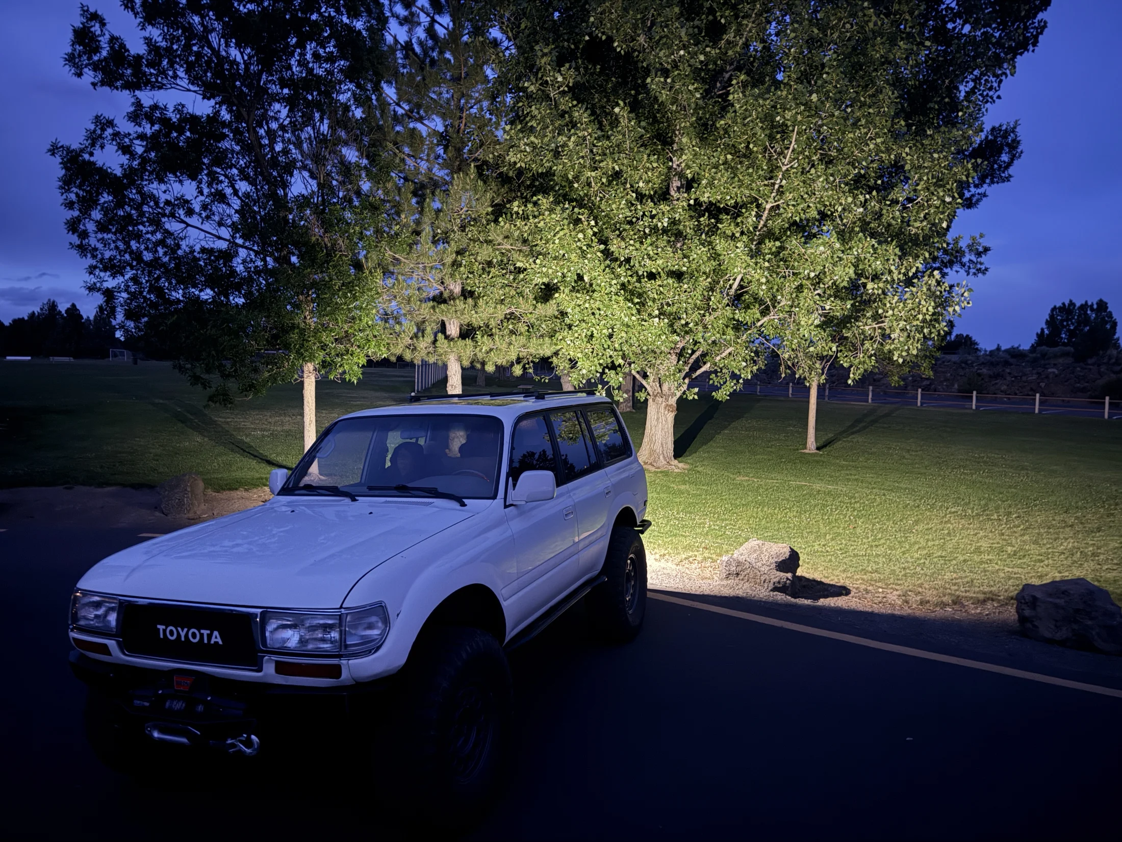

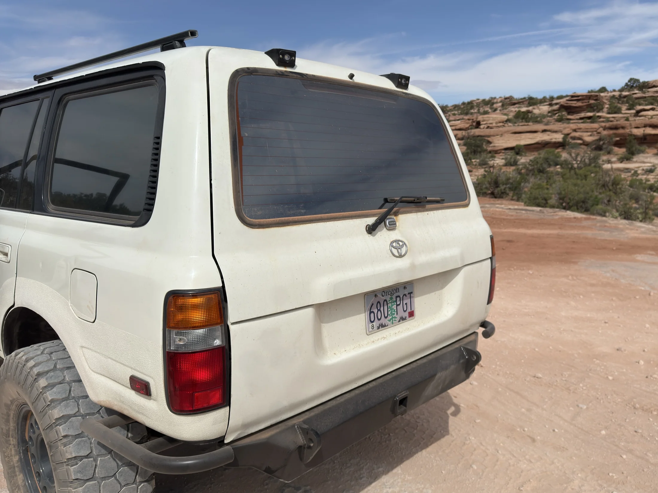

I created this product a few months ago.
80 SERIES LANDCRUISER, BACK UP LIGHT HOUSINGS (PAIR)
These lights work great for a back up and or camp lights, depending upon how you wire them into your Cruiser.
The PETG 3D printed light housings are attached using the factory rear spoiler mounting holes and fasteners. (3) Phillips fasteners per light, if your 80 does not have these mounting holes, double sided adhesive tape, or nut rivets can be used.
The lights are attached to the housing with the fasteners included with the Harbor Freight utility/rock lights.
Note: The Harbor Freight lights are not included with this kit, they can be purchased here.

very cool and clever. thanks for innovating and using exiting mount points!
