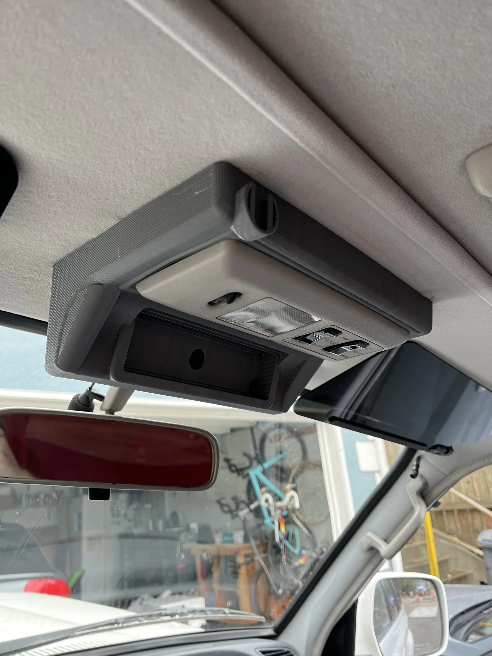

Pic of a console I printed:
It's not too far off, but hoping there's something even closer.
What is the plan for that console? That looks interesting.
Very cool. Thanks for posting the link to the STL! Hopefully once done you will post some pictures.

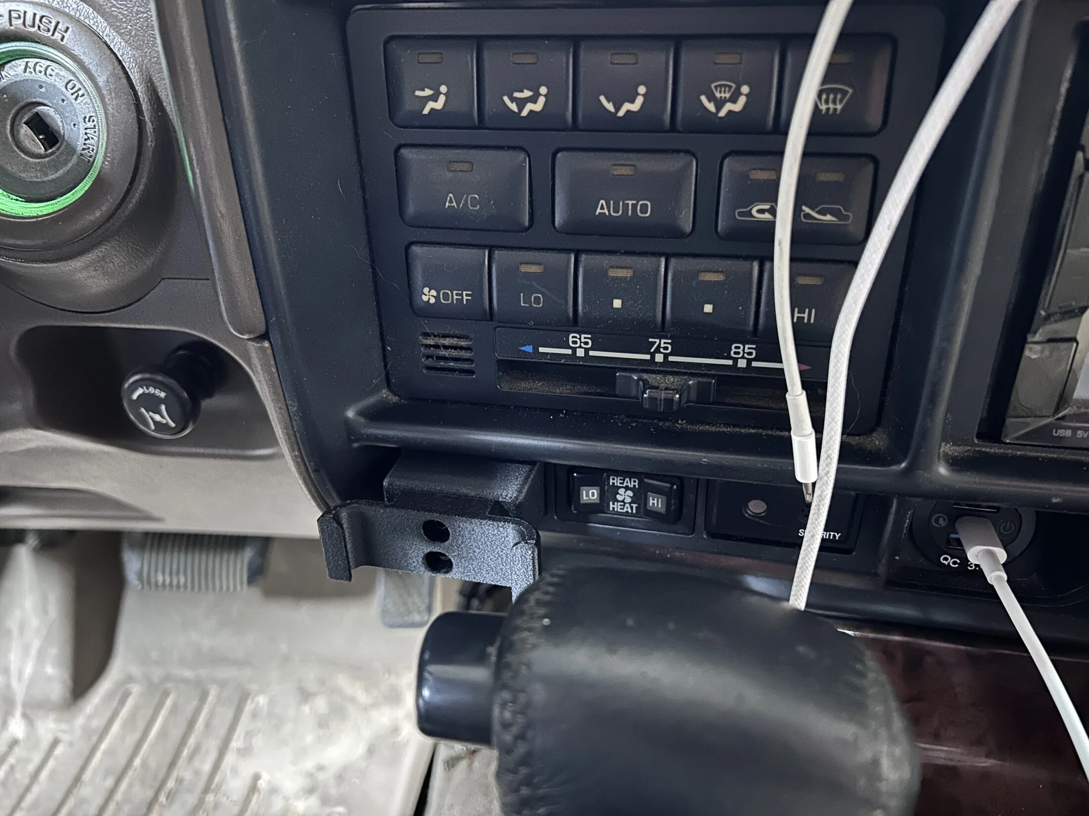

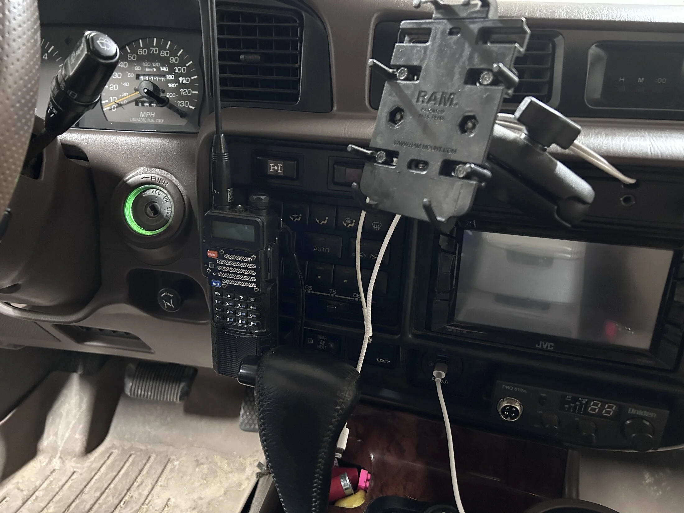

Just got my Bambu X1C a month ago. Decided I needed a mount for my Baofeng UV-5R and threw together this switch blank mount for it. Printed in ABS-GF.

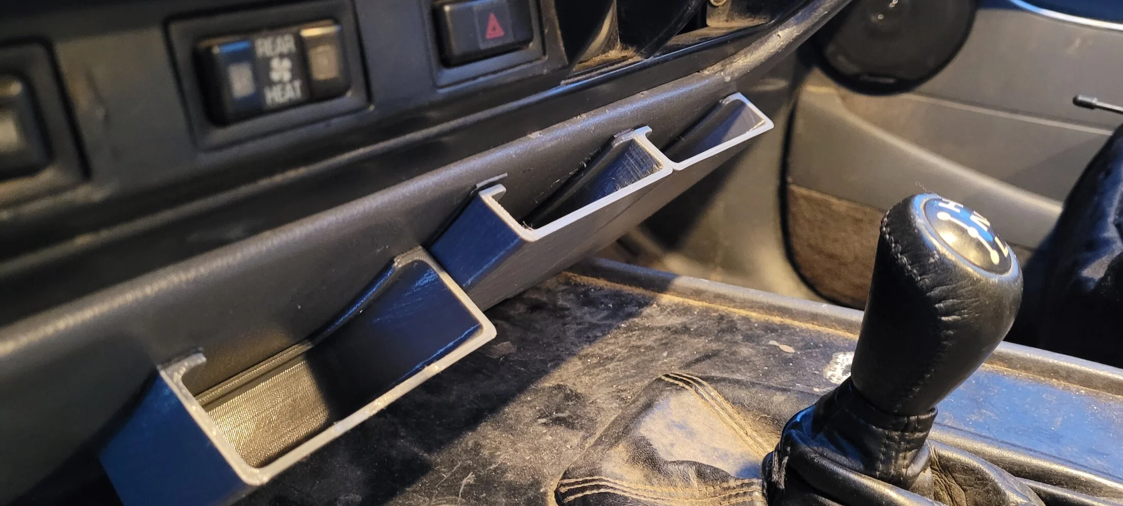

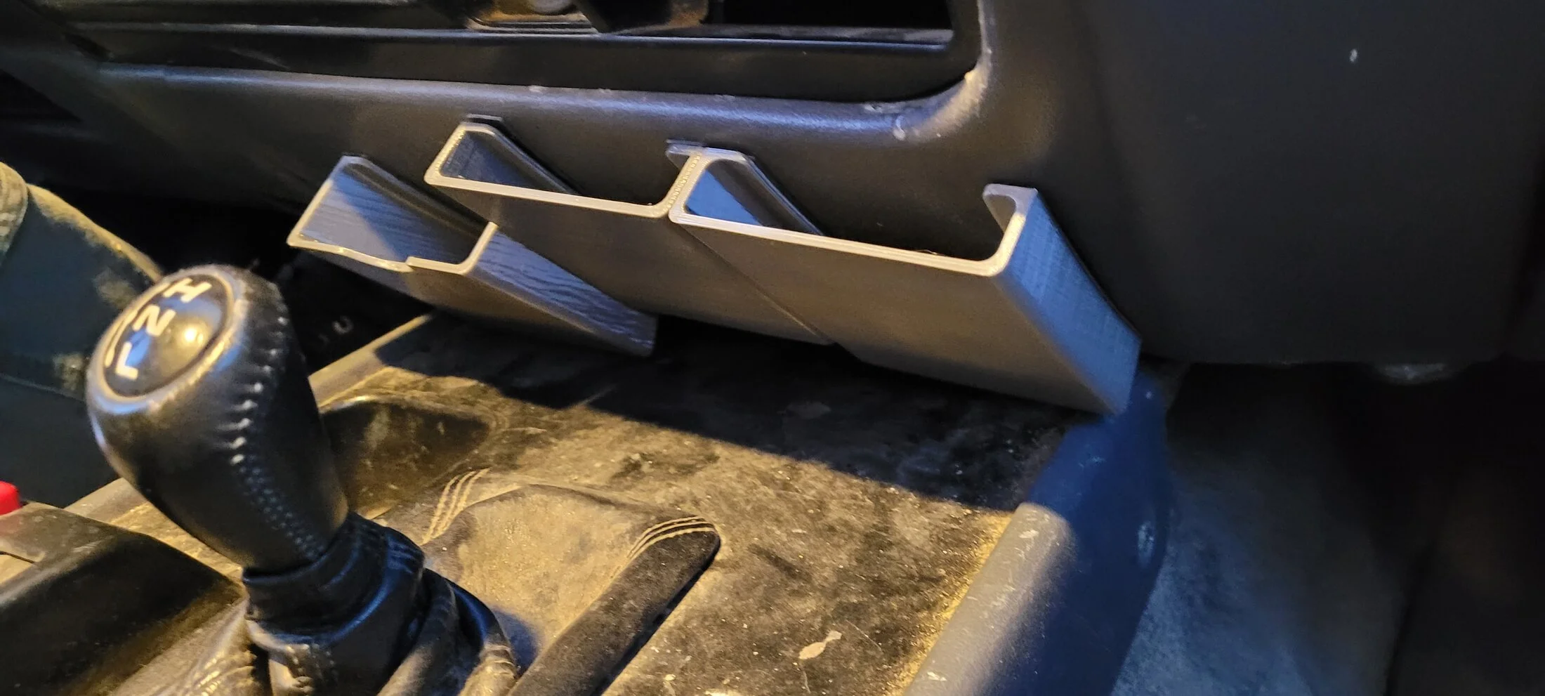

Hey all. Here's some stuff I designed (3ds Max. I'm a game developer/artist/tech artist). I'm curious what filament colors/brands people are using? I saw that the Oak interior can be painted 'bronze' to match, but I haven't seen any other info on the dark grey, light grey, or the off-white (cream maybe?) color these interiors have.
Early 80 series ashtray acc mount.
"Subwoofer" acc mount.

I'm also designing an overhead console that deletes the sunroof controls, houses a 12 gang control panel, a cb and has swivel map lights. I'll post that when the design is further along.

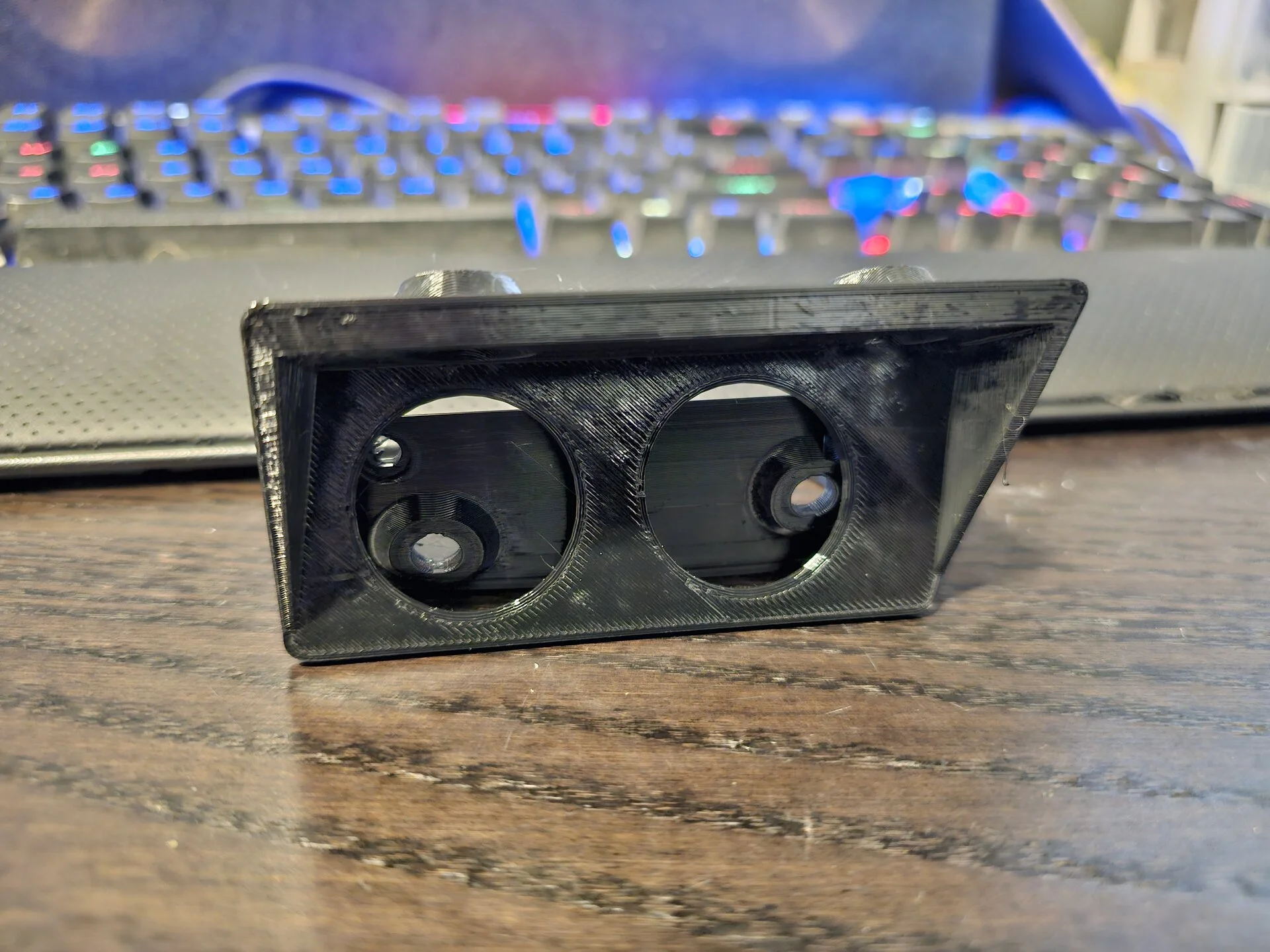

Hot melted a couple holster things for my 80 a while back. Two on the right are for phones, and one on the left if for my wallet. Nothing fancy, but makes my life a little easier.
Appreciate the design and upload! Im just wondering if you've tried this over rough terrain? I printed one out as Ive also been looking for somewhere to mount my UV5R. It seems to stick out quite far from the dash and wondering if the weight of the baofeng will be too much for it. I am thinking specifically the legs that go into the dash wont be enough to hold it in place over bumpy roads. Ill give it a test myself but wont be able to get out until a couple weeks from now. Anyways, thanks again for sharing :)
