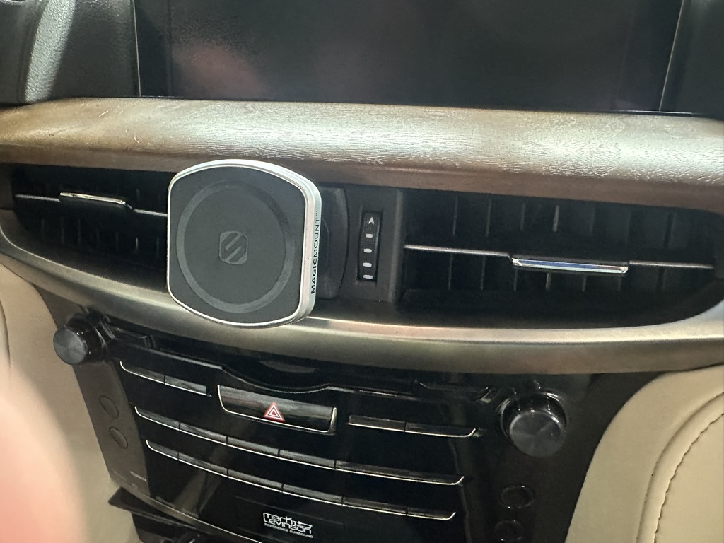

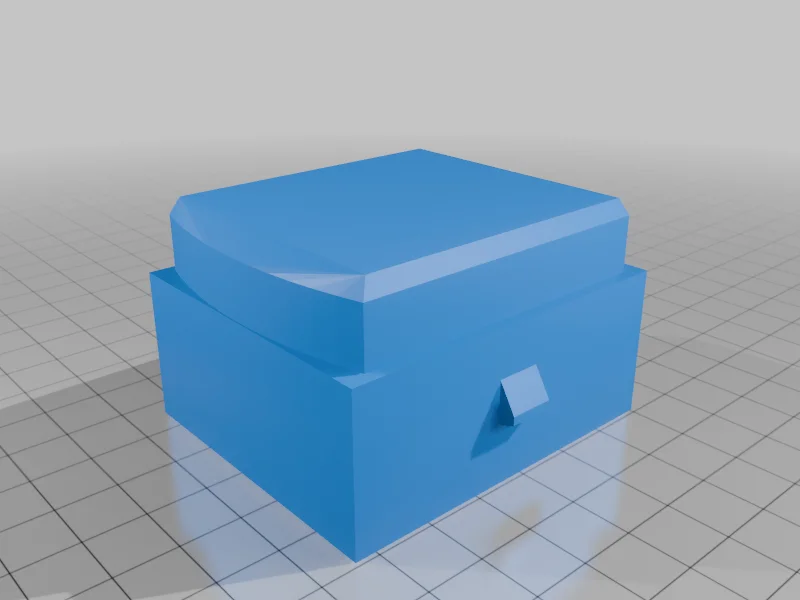

3d print that replaces the clock and provide a phone mount platform in the 2016+ LX570

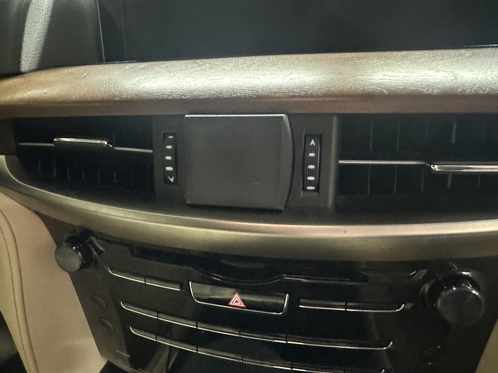

So wife recently got a used LX570 (hooray) after her GX460 was totaled. Upgraded it with the Grom Vline2 just like my LC. But unlike the LC, was having trouble finding a place to put her Scosche magic mount. She had the idea of "if only that clock wasn't there it might make a good spot for the phone mount". Challenge accepted.
Thingiverse link here.
Brilliant! How much flex do you get at that spot?

Stability of the blank there? Rock solid for a phone. The clock is held in with two clips that are pretty snug, but not screws unfortunately. I wouldn't say you could do a tablet there or something with similar weight, but for a phone it feels great.

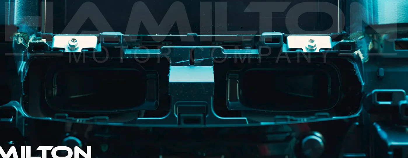

Do you suppose there's a way to add hardware to secure it back to the factory support between the two vents shown below?
My thought is that if it were strong enough you could have a bar with a track that mounts to your clock replacement block where multiple devices could mount. Primary desire would be phone, ham radio head, and microphone.
Ohhh, that's a good thought. I'm almost certain there would be a way to do this. I'll take a look next time I have that dash part off and let you know what I see.
