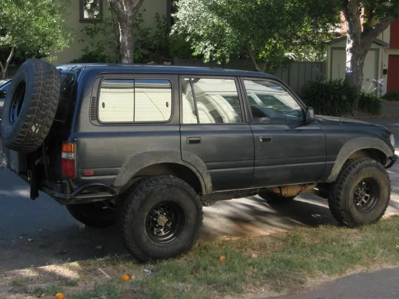

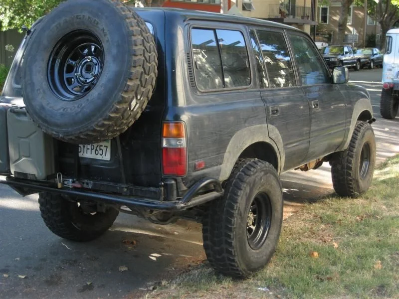

So - i went with the 4wparts steelie 16.5s and mounted up the 37s with no weights-no beads.
There is a very slight wobble at 45 that disappears pretty quick---then ran em up to 80 and they were fine.
showed em to a buddy who ran them in the military on hummers and he right off the bat noticed my one rear tire wasnt mounted directionally like the other tires. duh.! one look and it was pretty obvious the center treads are directional. Im going to have that one swapped in a bit and will report back if its the culprit of the slight shimmy.
of note:
- these ride ALOT quieter than my BFG mts.......slightly more noise than my Toyo ATs.
- they measure out to 36.5 unloaded-which i was pretty psyched about since id really like a true 36 for running 2.5" lift.
- mounting- they are really tough to seat according to my installer who "didnt like" how they were sitting. Hes pretty anal-and tried another method and got them seated how he liked. So for anyone with wobbles--double check that the seating is perfect. On these 4wp steelies---the fit according to him was "really tight".
i will be hitting the dirt this weekend and will report back. So far tho--the narrow 12.5" width feels real similar to the 295Toyo Ats i was running before. I have yet to do any camber/caster adjustments and its not terribly squirrely....but a slight difference possibly due to weight when at highway speeds.

The 37 militarys are really not a true 37................i got 36.5" on a unloaded tire...............and 36" installed on the rig. So given their 12.5" skinny profile--a lighter rig on 2" lift should work easily. If you are more rockcrawling centric----then obviously a few inches more lift or spacing from there would give a bit better result in the rocks. However-COG wise you are sacrificing if you are more expedition oriented and value steep angled traversing etc. Imho-- going up to a 37" and any lift should be coupled with some added width to compensate for COG changes. 4"bs is about minimum to consider and if you really value stability.......3.5" would be even better if you can live with the "lowrider" looks of your junk sticking out.
