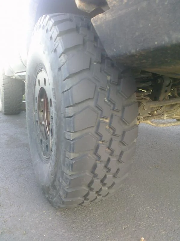

E,
Got any tread shots? I suspect it resenbles the projects, dezert guys love those things for the thick sidewalls... Have a few buddy's in SoCal who race with those, used they are a pretty $$$.

Didn't have one on hand, so had to run out and grab one.
Interesting tidbit, the center lugs are all different lengths. They seem to get progressively longer then smaller all the way around the tire (repeats a couple of times).

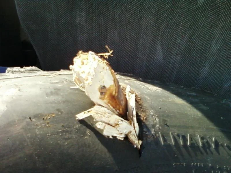

What the hell is that?
I'm guessing it's a tree root or other piece of organic matter that has decided to become one with the sidewall of his tire.
