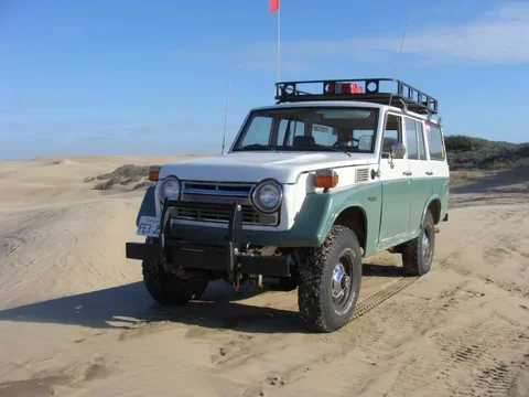

Here is a pic of my current build, I don't have one from the side with everything put back on yet.
4 inch hell creek springs
Bilstein shocks
Stock length anti-inversion shackles
33 x 10.5 tires
I went this route because I wanted room to grow. When I was looking at lifts, I read through aloe of threads. Most threads stated that people who had installed 2.5 inch lift eventually upgraded to 4 inches. So I skipped the 2.5 and went with the 4. I'm happy with the clearance.

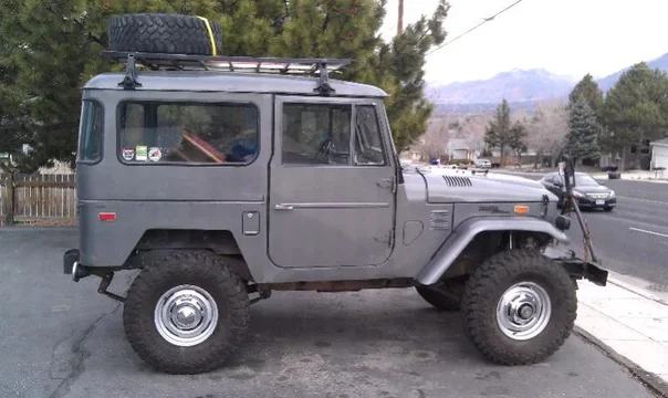

2.5" OME springs
1" lift ant-inversion shackles
33x10.5x15 BFG MT KM2s
It's actually a little lower in the front now as the front springs, which are newer, have settled some.

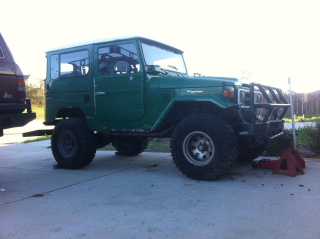

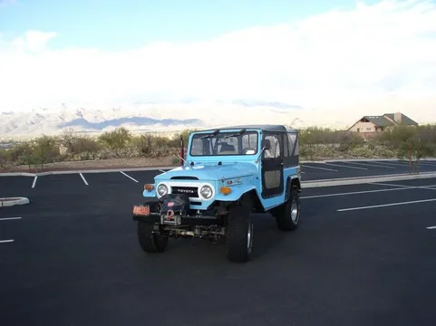

Here's mine my springs are Downey 4 inch but I took out two leafs from the front and one from the back. This with cut fenders stock steelies and 33x10.50s is a perfect ride. I had a shackle lift before and am with most guys go big the first time. Save time and money.

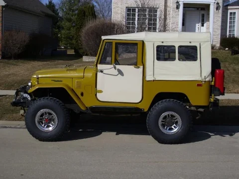

2.5" OME with 3/4" over anti-inversion shackles. HD winch and 22 gal aux tank.
This is my favorite truck on the board.
How did you get those rims and what width are they?
On the mustard yellow truck, are the shackles in the front upside down? The second one wasnt there yet.
Yes, they are upside down. It's on my list of things to fix. They were that way when I bought it. I didn't really pay enough attention when I swapped the front springs. That would have been the ideal time to do it.

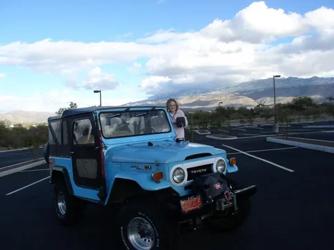

2 1/2" with 33s:

This is my favorite truck on the board. How did you get those rims and what with are they?
Thanks! The wheels are widened stock rims. I'm guessing they were widened sometime around 1972 or 1973. They were like that when my grandfather bought it in 1973. Back then, I guess it was pretty common. Nowadays, it seems like there's only one or two places around where you can get it done.

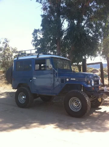

4" lift sua oem springs that need replacing bad on 33 x 12.5 x 15's Extended shackles and anti inversions. That it what was on it from the po. I would never go above 33"s for a road/trail combo rig. Not purdy but its mine and paid for lol

Mustard what is the front bumper made from? I like it I mean for a simple bumper. I like the color of your rig too! Mine stands out like a sore thumb and I can't hide from rebels and others around here ha ha! But one has to pay the government to change vehicle colors.
