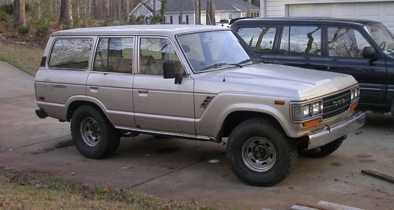

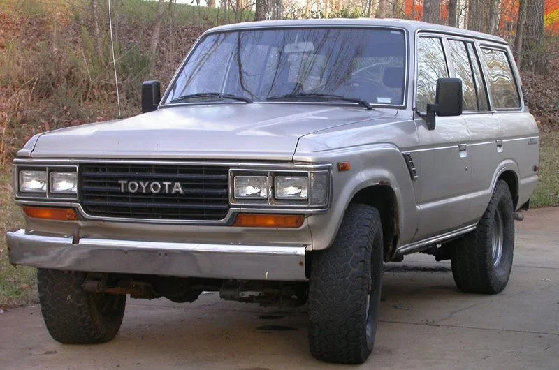

FJ62 on 33x12.50, stock rims, no lift, I have heard them rub before but not too often, free cast offs from my buddies jeep, Front BFG ATKO, some kind of mickey Thompson in the back
I am running 33 12.50 on 16 inch rims with a 2inch lift and the tires still rub in extreme conditions, or if you have a canoe and 2 other people going around a sharp corner.
