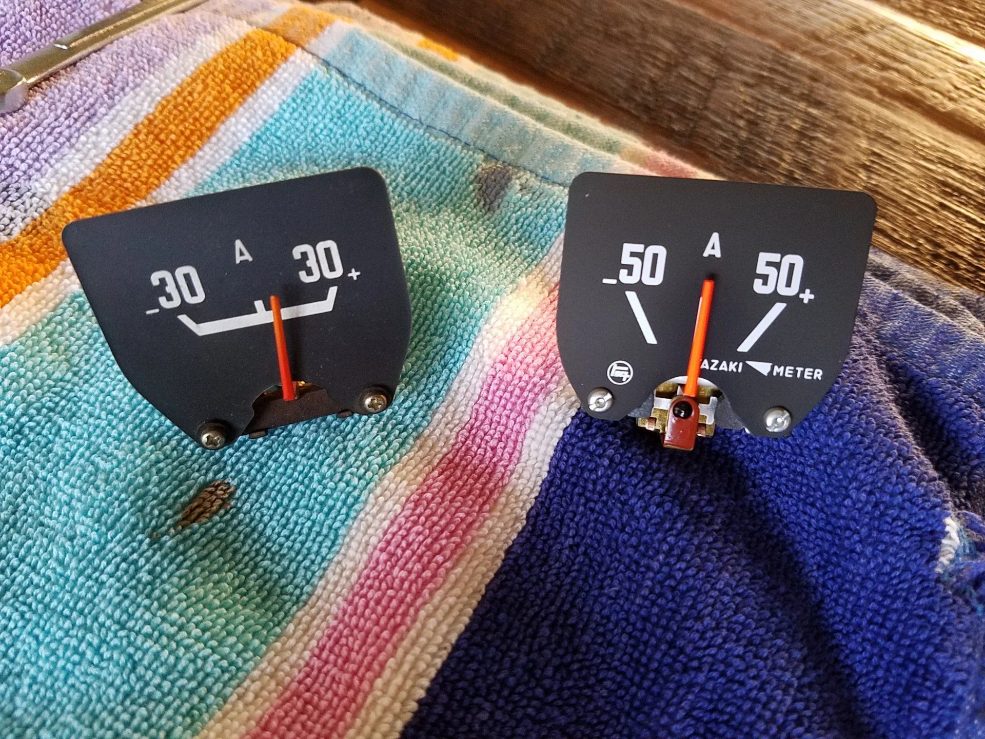

My speedometer is not working after I replaced the old speedometer cable with a new one. I think the old cable had not been properly attached over the years and wore the inside where the cable attaches to the instrument cluster. With that I ordered a new cluster and it came with a 50 amp meter, put it in speedometer cable attaches just fine but the FJ won't start. Actually had smoke coming out of around the amp meter. Pulled the new cluster and put in the old with the 30 amp meter and she starts just fine.
Can I get a 30 amp meter to replace the 50?
Thanks, Craig
Can't you just swap meters? Are the dimensions different. I don't have a 50 amp meter to compare and I can't tell from the photo. The 30 amp is connected directly in line with power to the truck, whereas the 50 amp meter uses a shunt.
I was hoping I could just sway meter but the dimensions are different! The 30 amp won't fit into the holes in the 50 amp cluster. I feel like I just wasted $400.00.

You can not just use a 30 in a 50. And visaversa. You will burn em up.

its sounds like he already smoked the 50amp.
I have a 3rd generation cluster with a 30amp meter. Isn't there a way to modify 50 AMP external shunt into 50 AMP internal shunt ?
I read where the 4th generation change was the AMP gauge changed from 30 AMP internal shunt into 50 AMP external shunt
Two different clusters. The 50A is not really an amp meter. There's a thread about how to make it work on here somewhere. Maybe in the big thread on clusters, gages and stuff
Like was said, the 50 amp uses a shunt and the needle really measures a sample of current flow. The 30 amp , all current flows through the meter. So, by putting the 50 in a 30 place, you may have fried the internal wiring depending on shunt design. A basic function of the 2 designs are below.

Specifically Post #301. I plan on fabricating a fusible link and sub-harness to the ammeter with the two 5A fuses for my '71 FJ40 build. I already have a NOS 50A ammeter.
The 50 amp meter uses a coil to drive the needle, high amperage can’t flow thru this netter.
The 30 amp meter doesn’t use a coil and can handle 30 amps.
My preference has bee. To shunt the 30 amp meter for my 1975 Landcruiser as it allows more needle movement.
