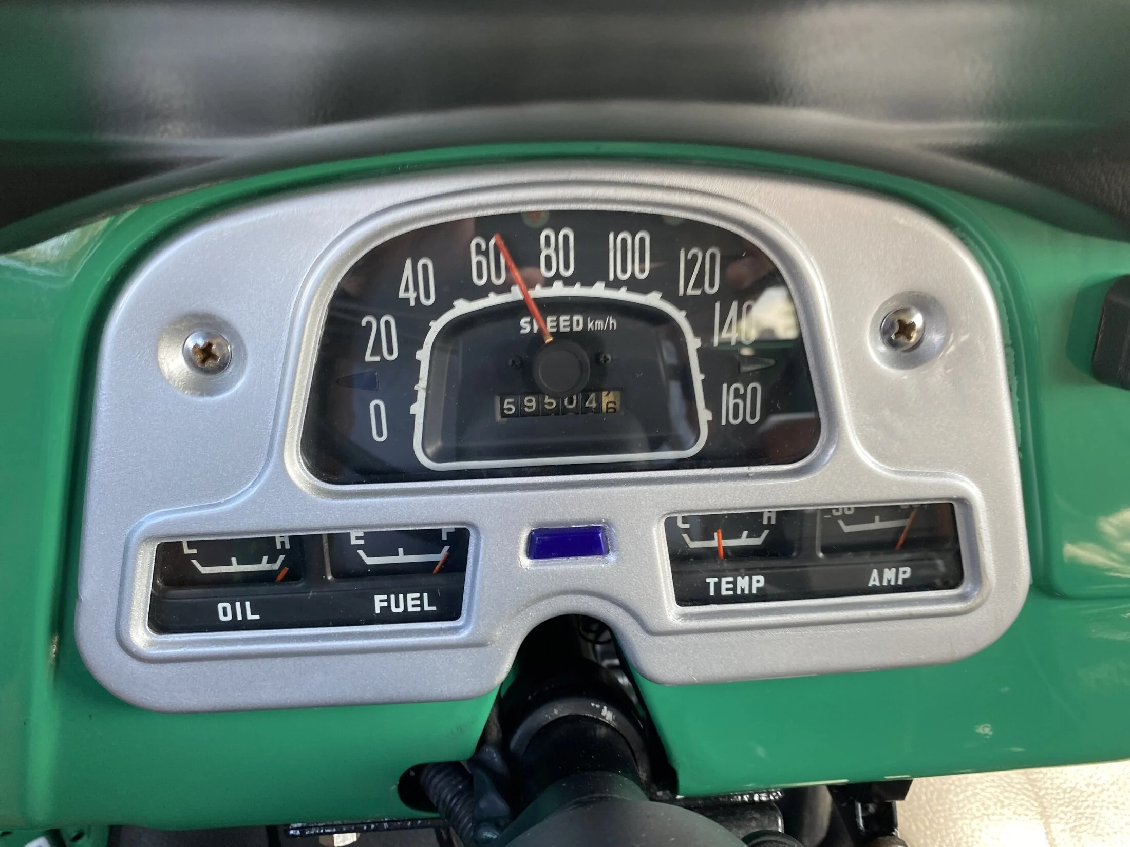

Can you folks please help me understand the amp gauge on the dash? At idle the needle sits dead center but when driving it pegs to the right. Is this normal? Thanks gang.

Nothing I have had over the decades has showed a pinned needle as in your photo
Just noticed your oil pressure is up there as well… ONLY thinking out loud…is this a 24v truck?

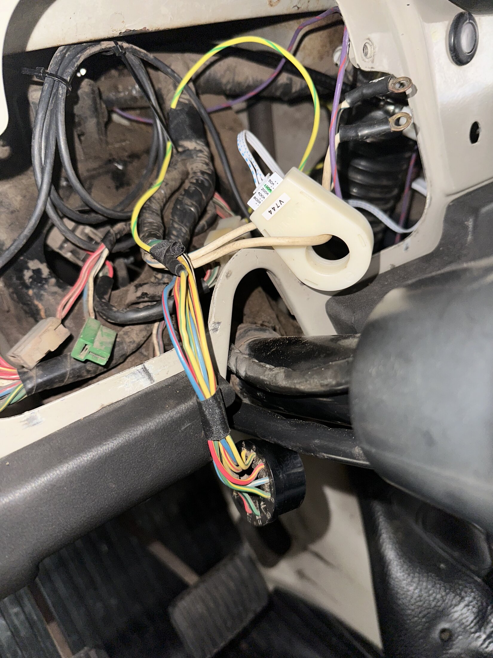

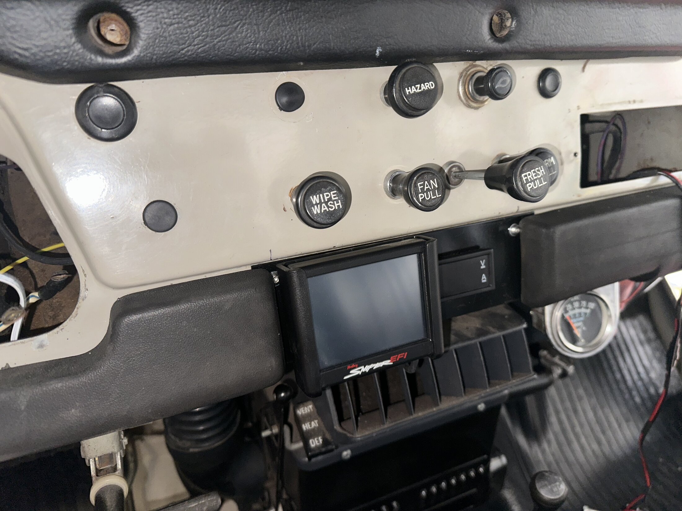

I added a cheap digital amp gauge to my 76 FJ40. It’s the type that has a ring on it that goes around the wire you are testing. I put it on several different places, at the battery, on the sniper power wire, and ended up putting it on the wire coming from the amp meter on the gauge cluster. My gauge cluster meter showed pegged at 30A but the digital gauge shows 15-17A. So I was satisfied I was not burning up the wiring.
Now, what was consuming all that current, that will require more investigation.
The ring sensor for the amp meter.
To the right of the sniper screen is the digital amp meter installed

Hi Charlie. After your initial response I realized that my oil pressure also pegs to H upon start up. I originally thought the gauge indicated the oil level Low and High.
