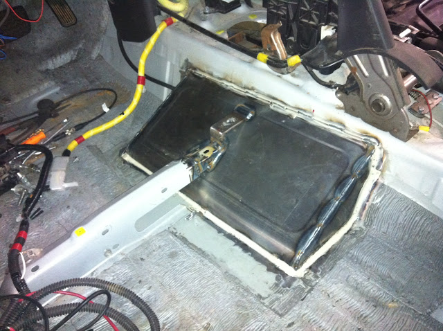

The floor and seat mount were knocked out today (sorry for the iphone phots..camera battery was dead).

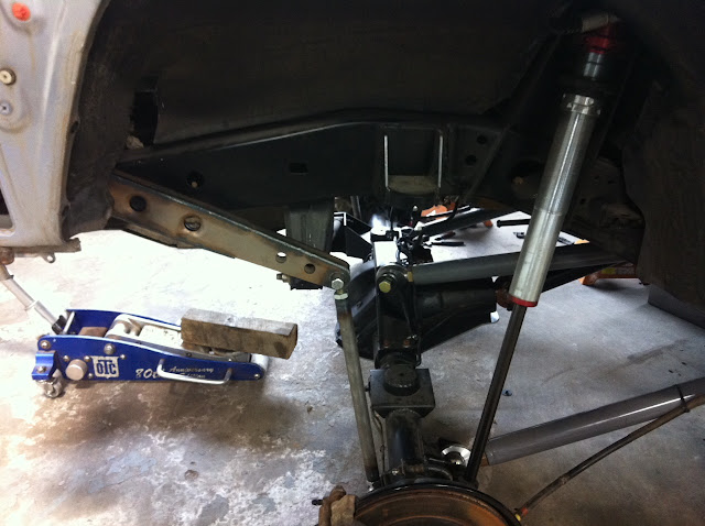

Very Nice, did you see the pic of Nicks rig flexed out at Roundup? You gonna turn that into a trailer rig or keep it a driver?
Yes, saw Nicks photos from the roundup, looked like it worked well. Definitely like the paint scheme he did.
We started off with the same rear setup, at the begining of this project, and ended up selling it. Still did a 3 link, but altered the geometry towards the characteristics that we were looking for and ran coilovers to yield more travel and articulation than MT's "kit".
