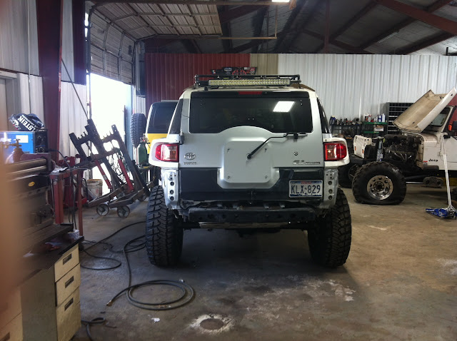

Nearly 11months to the day after dropping the FJC off, it drove for the first time
Suspension is smooootthhh :bigthumb:
Dave also got one of the rear fenders knocked out
Got plans for a rear bumper or shortening of the back end of the frame?
No, Stan's bumper will be going back on for now and with the auxilary tank there isn't much room to be had there.
A few years down the line when I no longer need the FJ as a part time daily driver the rear setup will be changed all together. Longer wheel base, rear frame will be chopped off and a custom one made up to better accomodate a trailingarm/4link setup and a fuel cell inside. Really need more uptravel in the rear (currently only 5" up and 10" down) to better match the front setup in the long run. For rock crawling the 3 link is suitable, but more uptravel is really needed for the high speed stuff.
Didn't realize all the limitations with the FJC frame and crossmembers until we started trying to fit the 3 link in there as no one had posted info on them previously. Hopefully this build has helped showcase some of the rear end issues for folks down the line.

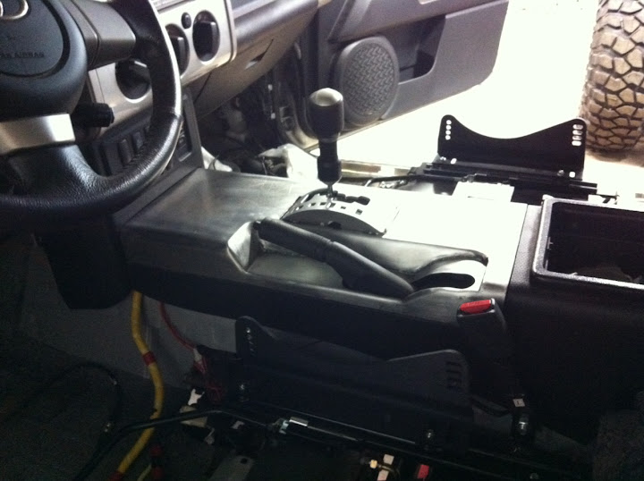

Just like aviation pre-flight check lists, I'm going to need a pre-obstacle cheat sheet on the steering wheel to figure out what ratio I'm in, whether ADDs actuated or not, vsc turned off, etc. Thats normal right :confused::steer:
