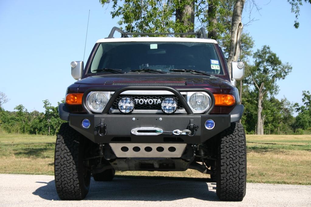

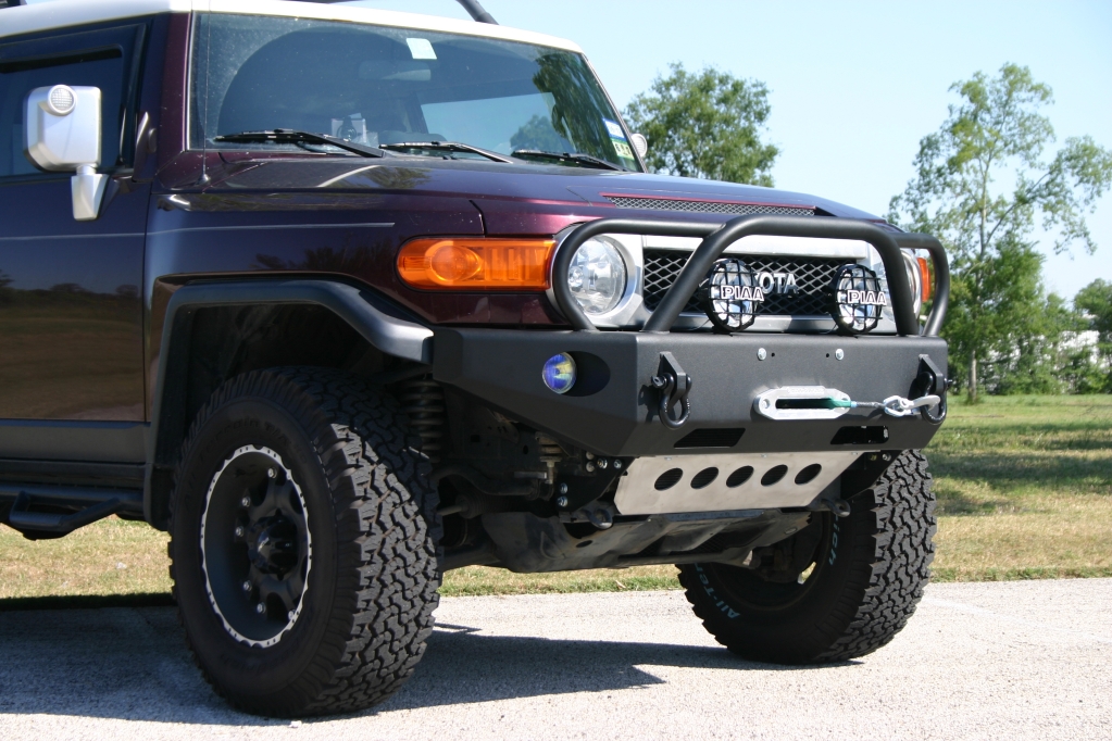

Thanks to ShrockWorks for the new front bumper that my FJC will be sporting.

Ha, I think the frame showed me first that it likes to move over an inch from where you set bump...tires and UCAs were getting to friendly with the fenders. Forgot to post up the shots of the bumper. After I get it powdercoated winch and lights will go in.

Looks fantastic, seriously well done. Really like the way you incorporated the bumper into the upper frame/shock hoop/front clip support system (??? sorry for the nomenclature errors). Beautiful rig...:beer:
Thanks Jerry. Need to meet up with you for an east coast wheeling trip at some point. Lots of work still to do on the FJC, but its definitely a pleasure to get out and drive the thing these days.
I love that front bumper! Man this ride is sweet! Great job!
Thanks. It has been a really enjoyable project.
