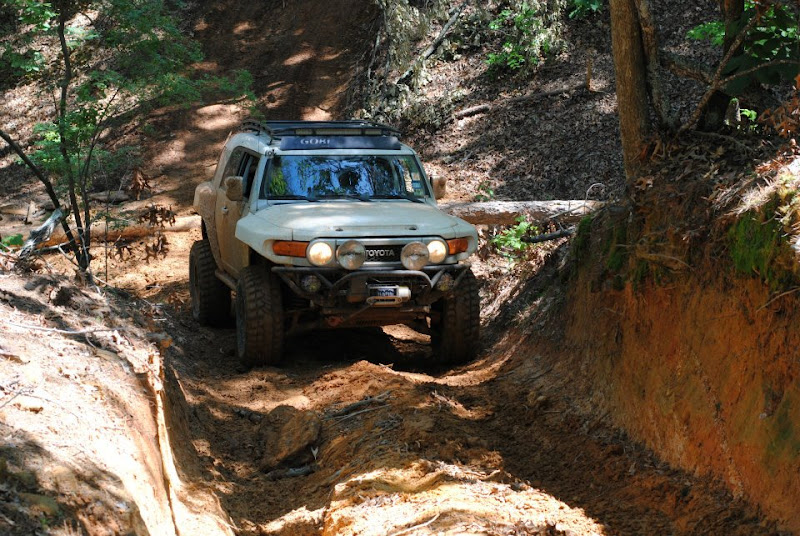

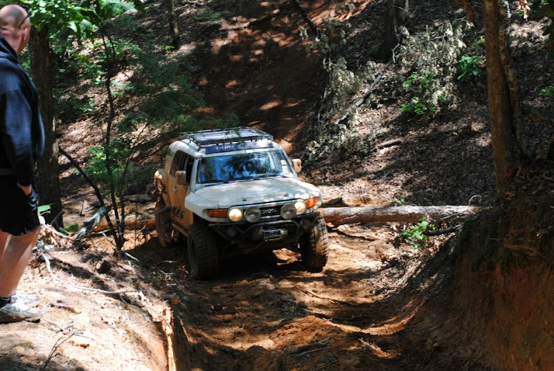

Suspension exceeded my expectations. Was a blast in the go fast stuff and actually performed much better in the rock garden than I expected it to. Cycled freely and had a lot more traction in there than I was anticipating out of an IFS setup.
:lol: if I had any more decent pictures to post I would have tossed it up. Turned out my passenger was way too comfortable in the seats and rarely got out for pictures. That coupled with my ineptness at using the gopro cameras and killing one made for limited shots and a whole lot of useless video that I've got to go through and edit. Don't think I got any of the rock garden on video, but I might have some of the high speed stuff on there.

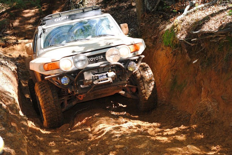

Can't believe how stuffed the front is in that pic. That's incredible.
Setup works really well, even untuned. I anticipated having some issues with certain parts, but everything really exceeded my expectations over the weekend.
X 3, equally impressed with that shot, very impressive indeed...:beer:
I was surprised at how well the front cycled in the rock garden more than anything. Worked really well all around, small changes here and there will be needed to dial it in, but there is only one big project left up front to finish it off.
