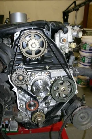

Hi,if i remember right,the waterpump on the 2LT-E is driven by the timingbelt,not the otherbelts.
simon
simon
Nope. Definitely not the timing belt.
It's the double V-belts off the crank pulley and then to the alternator/vac pump that turns the water pump (at least on my 2LT-E)
As to your question on the fuel filter.... My check engine light comes on if the filter is clogged. It also doesn't make power like that at all. ;) I have an el-cheapo screen filter before my Toyota fuel filter, and I clean that at every oil change. The fuel filter I'm changing about every 25,000 miles or so.
Dan
