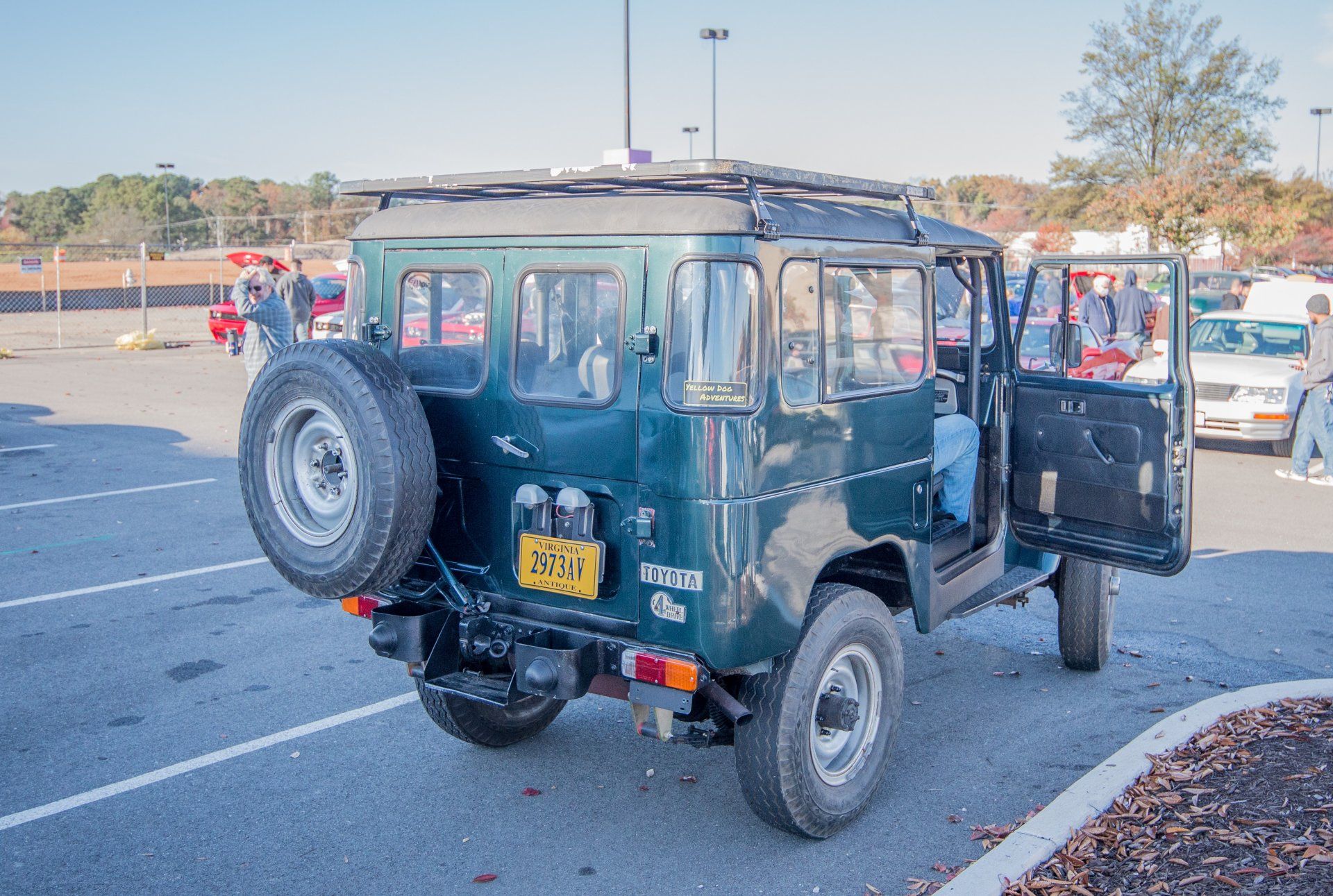

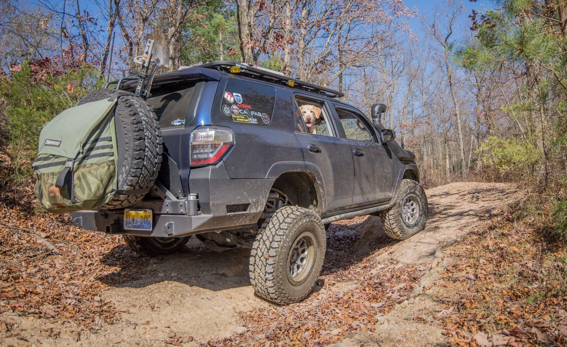

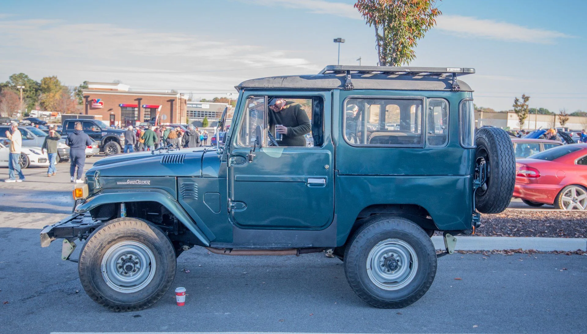

Rig pics attached along with my other toyota, yes aware of the rear shackles.

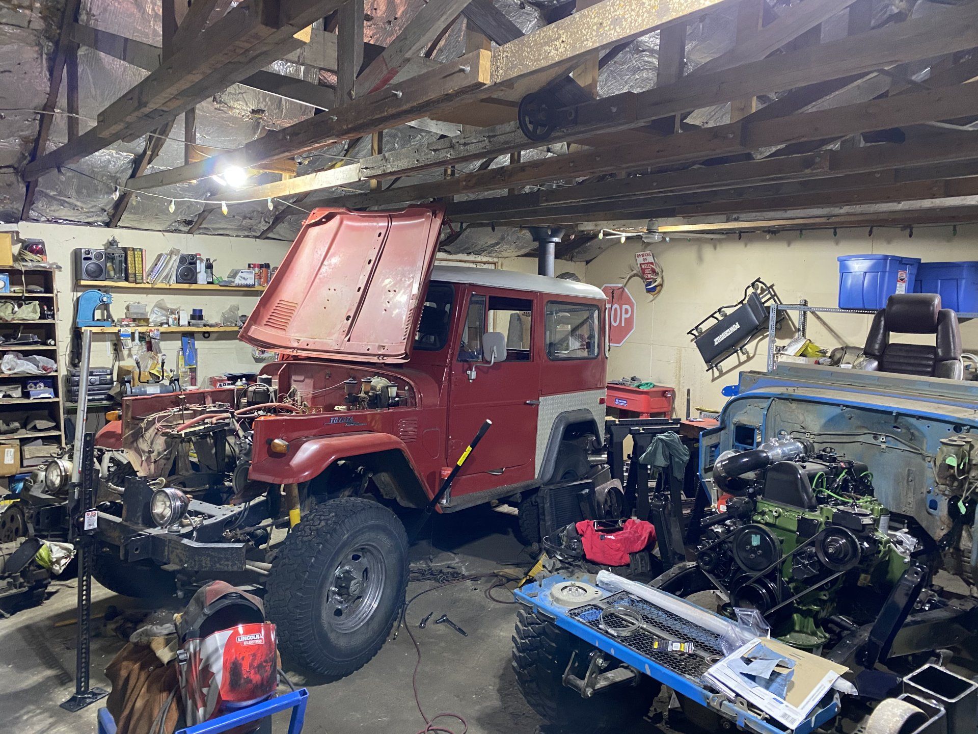

i’ve got an om617 going into my long build but it should be pretty sweet when it’s done. it’ll be more efficient and probably more powerful but it’s taken a lot of work. the 2f with sniper would likely be easier but i never liked my 2f much. it was never very strong and so very heavy. i loved my diesel when it was in my car which was 700lbs heavier than the fj40. it’s such a smooth motor and was just a joy to drive. it’s in the blue one now

the ability to add power has me leaning towards the om617, what about it has taken alot of work? other than making it look as good as yours does

i did a nv4500 behind mine. with the right gears i think this will be an awesome set up. i did rebuild the moto though so i can add boost. honesty an injection pump and turbo will significantly increase power and when compared to performance mods on even a chevy 350 it’s pretty cost effective. mine was about $1700 cad to put a custom pump and a bigger turbo on and will give me about 30% increase in power. the engine rebuild though wasn’t cheap. for about the same price you could put a new cummins in which will be a more modern engine. it all depends on how far you want to go with it. getting f it all to fit with the longer drive train and you’d need a spring over to clear the oil sump has been the work.

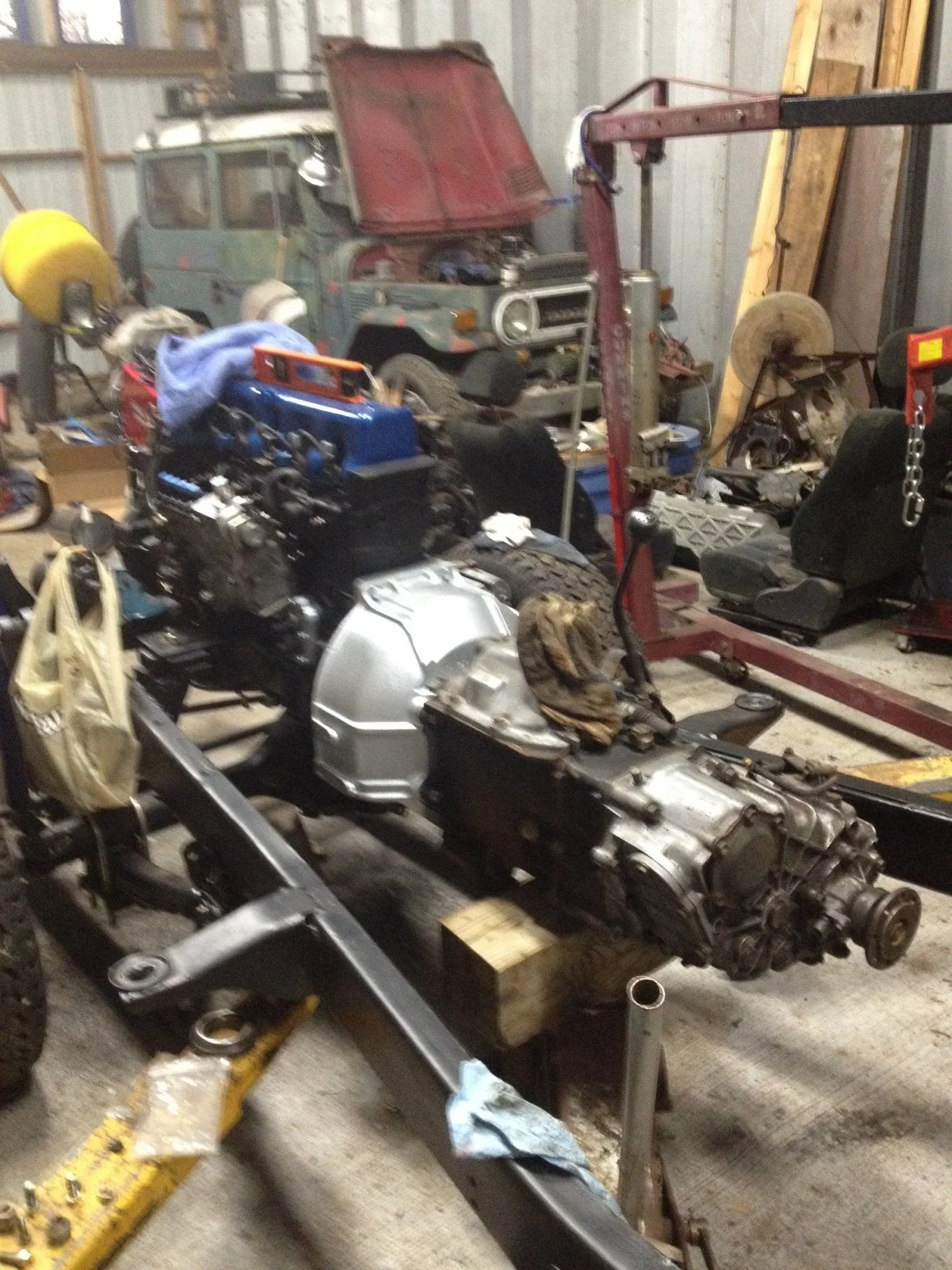

I’m putting an om617 into my 79 fj55. You might check into Doomsday Diesel for adapters and upgrades. I’ve been happy with his service and products. My adapter came from 4x4 labs since I’m using an H55F transmission. Doomsday has adapters for om617 and just added VW . I know bezel police, the 40 in background is upside down.
