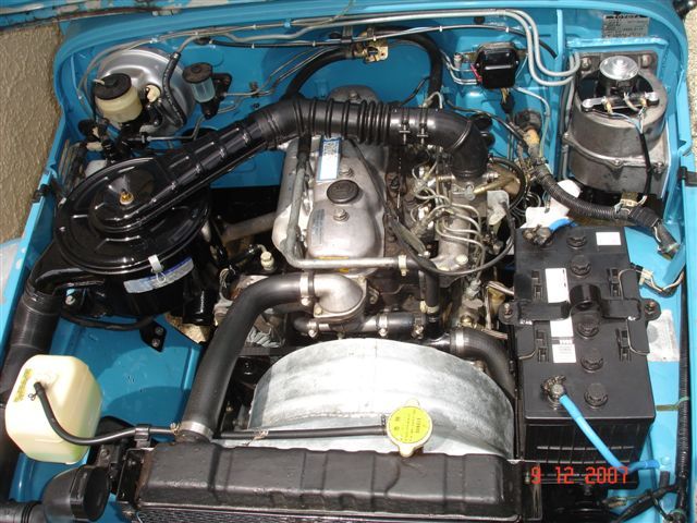

I imported it from Oz so it is an import which was "assembled in Japan for the Australian market". (I understand Toyota Australia imported theirs fully-assembled while Toyota NZ imported theirs as CKD.)
I don't think mine looks quite like that. This is the engine bay:
I'm working on the body/chassis etc now.

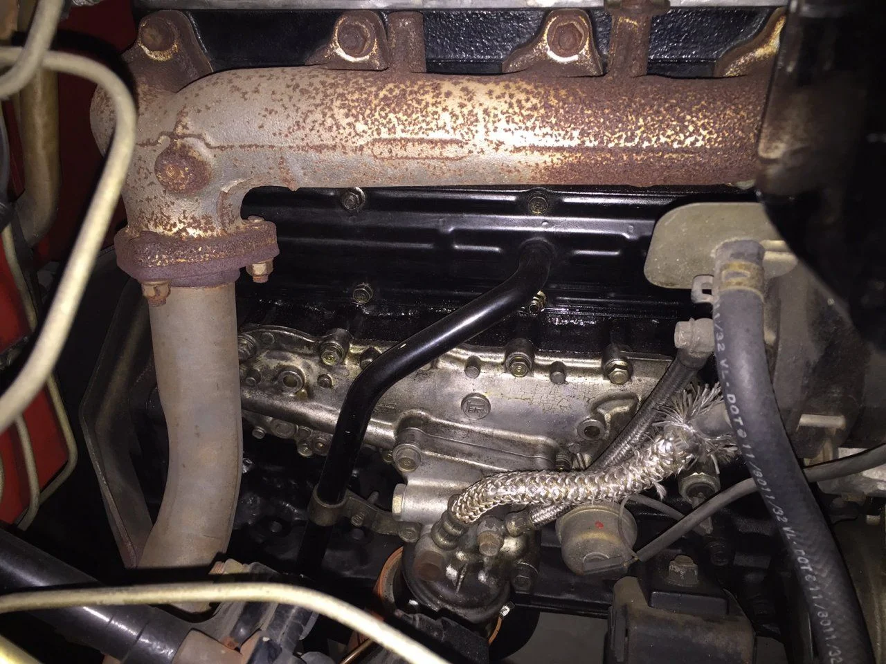

You may have already figured this out by now since this thread is quite old, but my 2B has the 3B-type alloy oil cooler. It is an early build 2B, which shares a number of parts with your B. Mine also has the 3 bolt exhaust flange pipe.
You may have already figured this out by now since this thread is quite old, but my 2B has the 3B-type alloy oil cooler. It is an early build 2B, which shares a number of parts with your B. Mine also has the 3 bolt exhaust flange pipe....

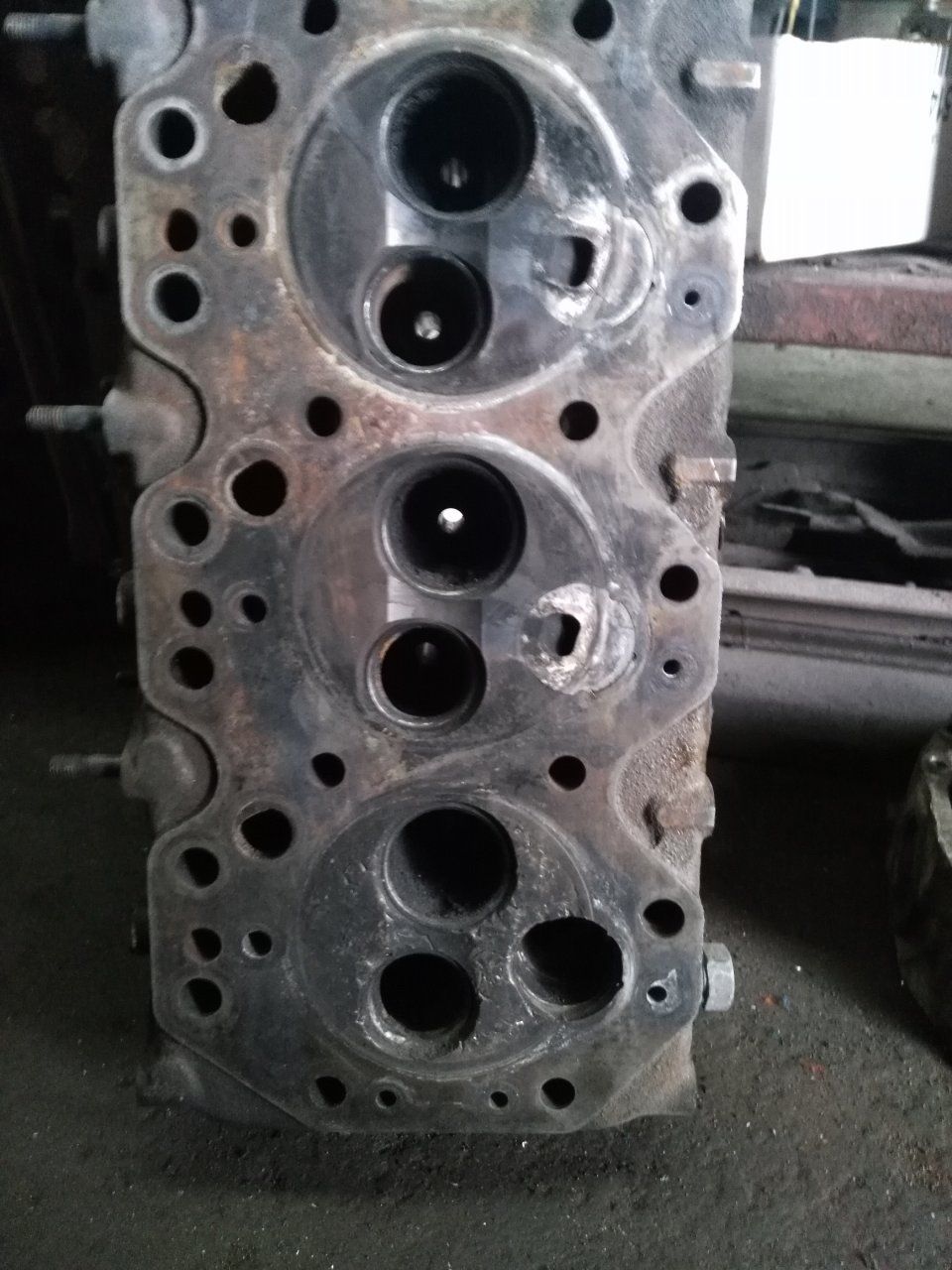

I had a precup blow out on my 77 b series and do some damage to the head cylinder. Attached is a photo of the aftermath . Is this a head cylinder replacement or can I get lucky and replace the precup and damaged piston? The missing precup has a chip around the rim. I'm affraid machining it would make the hole too big. Id like to save the money and just replace the precup but worry that chip with cause pressure issues....
Any help is hugely appreciated!

Replace all the precups, as they all look cracked. I would be concerned about the valve seat as well, but should be replaceable.
If it were me I would bring to a reputable rebuilder and have crack tested as has seen some impact and if let them fix if feasible. Valve seat will need a replacement or reaming? and face will need a kiss from a grinder anyways. Hard to tell from pics but is the bore round? Damage to the bore where the precup sits?

It looks to me like the missing precup has belted out the side of the recess that it was seated in.
The "head gasket sealing ring for that particular cylinder" needs to seal right across the new precup when it is fitted. So if I'm correct, unfortunately the hot gases will now have an easy bypass path past this "ring".
So I think the head is now "junk".
Sorry to say..
