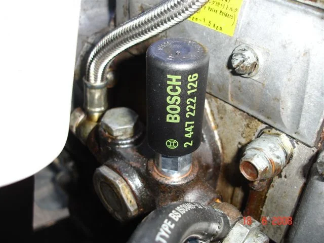

Here is a photo of my latest Bosch primer pump installed:
This primer pump is sold under any of the following Bosch part numbers:
  • 2 447 010 033
  • 2 447 010 038
  • 2 447 222 125
  • 2 447 222 126

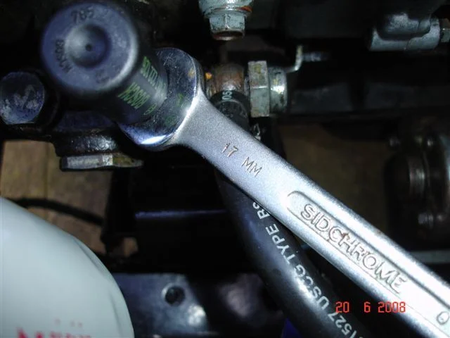

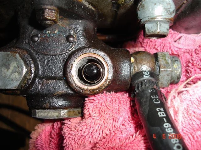

When you install it, you should replace the little copper washer it seats on (Bosch supplied one with my new pump), and you need to be careful of the spring and check valve that sit beneath it:
Unlike the OEM primer pump, this type is easy to install/remove because it requires a smaller spanner (only 17mm) and the hex is long enough to allow that spanner to be moved around obstacles as you turn it:
PS. - The thread is M16 x 1.5 so if you have a primer pump with this thread (and the entry-hole looks like it's made to accomodate a spring and check-valve stem) - then it should fit your engine.

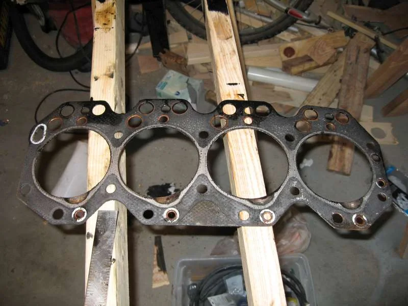

Does someone have a picture of a new 3B head gasket? I can post a new B gasket pic so we can compare. The 3B head will bolt onto the B block, but whichever gasket you use is going to block water. Mine was running this way, so they will run. I just dont want to put another 3B head on a B block and end up with the same problem a few months from now
Mike​
Mike​

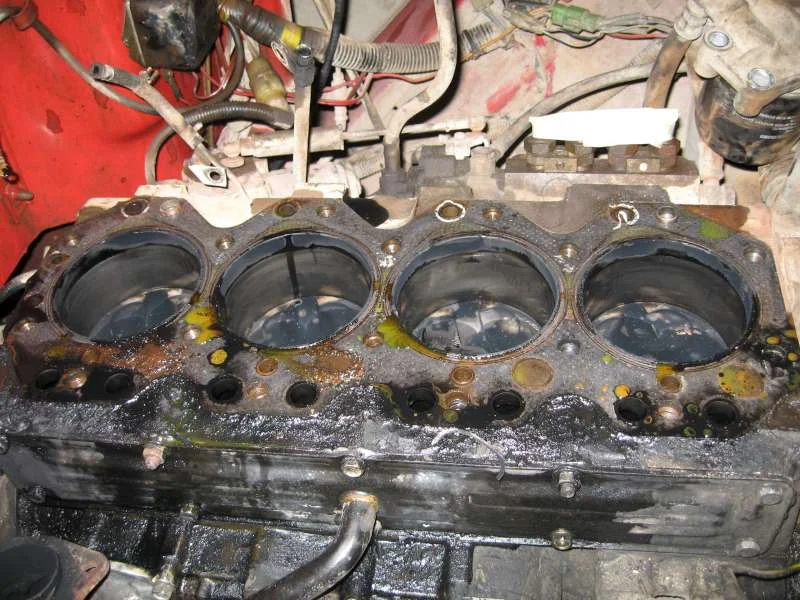

My 3B head gasket matches the head exactly, so if the B gasket doesn't then the heads shouldn't be swapped - it may work, but not as its supposed to.
Here are pictures of the 3B gasket, block, and head:

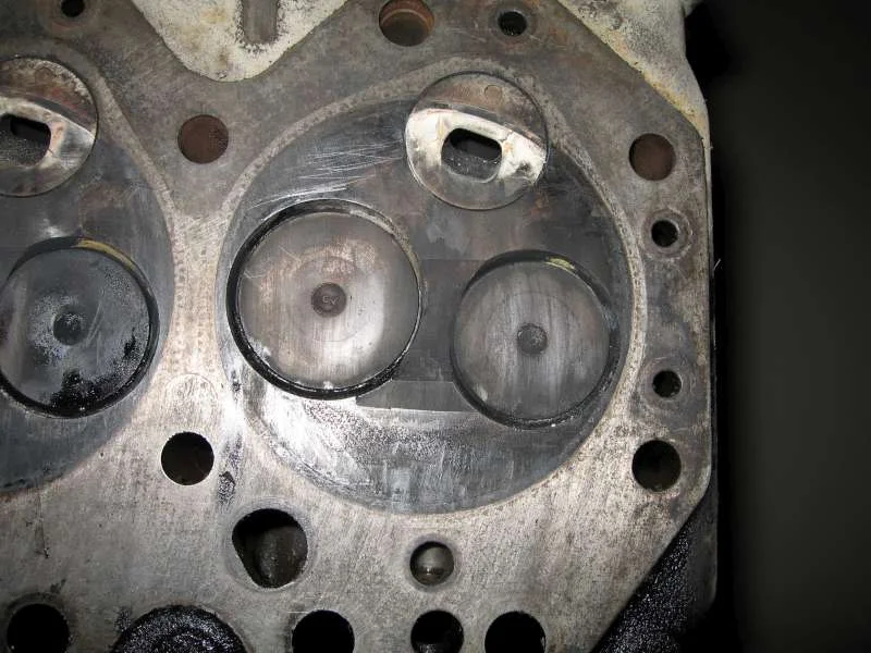

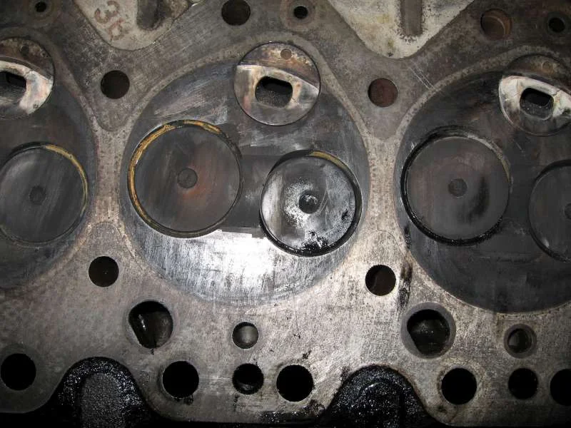

Just a bit further on the B/3B head and head gasket issue. I have a spare B engine that I bought years ago, had all 12volt accessories (glowplugs, alt, starter and edic) and a 3 bolt exhaust manifold. It also had a spun main bearing and a nearly new (less than 1000km) commercially rebuilt head (no cracks, new precups, Injectors, et al).
My thought was to use the head as a temporary spare on my daily driver when I pull the original 3B head for a leisurely rebuild this summer.
I just pulled the head (the part number cast in is 11111-56020) (I think it's a 1980) and compared the head gasket that was fitted (marked B-2B) with a new 3B gasket. A slightly different outline (different manufacturers) and the 3B has a 107mm cylinder hole with the B-2B having a 102mm cylinder hole. Overlaying them, all the holes (coolant, oil, bolt) seem to match spot on and the cylinder bores are concentric. I would think a 3B gasket could be used on a B in a pinch, it would only very slightly lower the compression ratio (until it builds up a carbon block).
It seems the heads should swap well, the exhaust ports seem smaller than the 3B gasket, and possibly the valves are a bit smaller, does anyone have the inlet and exhaust valve outside diameters for the 3B?
Any thoughts?
