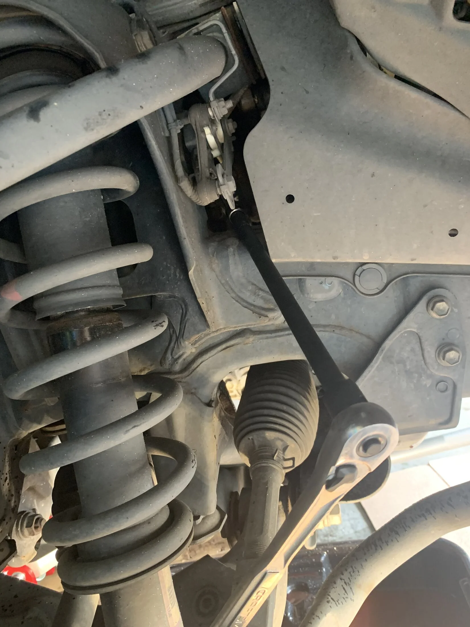

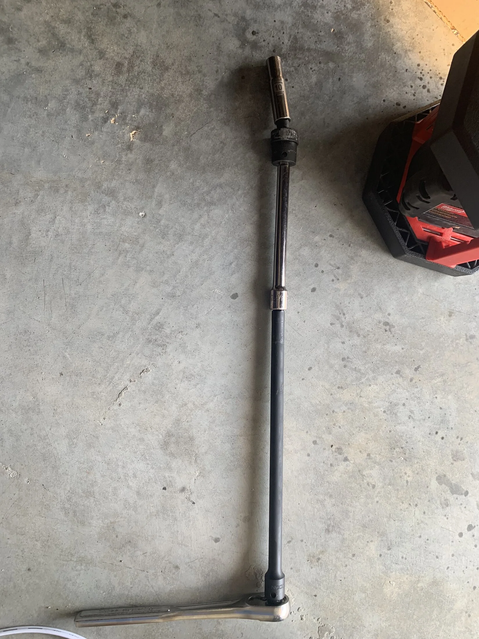

Also, if you want to drain the coolant from the block, you have to access the drain valves from the front wheel wells. there is 1 drain valve per side. The passenger side I think is the harder one to find, but you can see where I went in from this pic and the amount of extensions and a joint that I had to use in the pics below. Notes that these are brass (I think) valves so don't go torquing them down like crazy.

Yeah the height sensor hardware looks like it gets in the way of block drain access. On a cruiser it’s wide open.
gotcha, I also just let the coolant "waterfall" down...since it was impossible to get a tube onto the port.
I had a pan to catch the waterfall of course.
