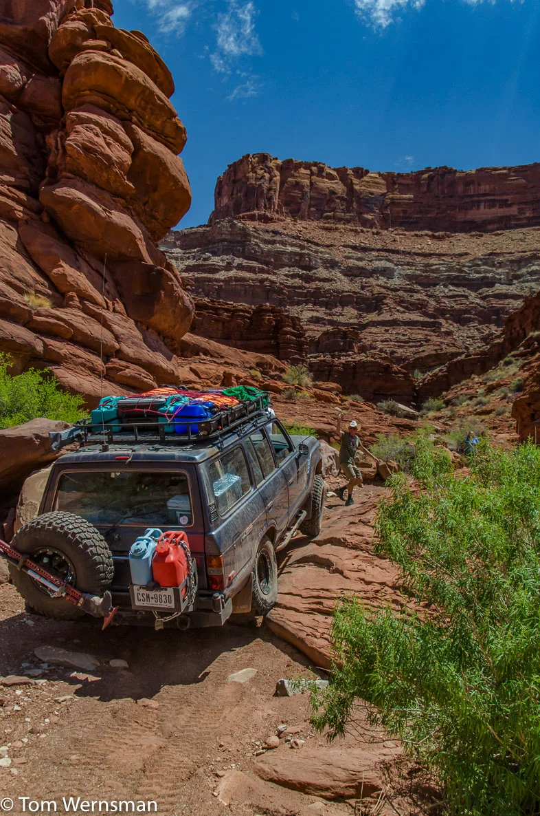

My FJ60 will remain my difficult trail Land Cruiser. I would never fill the wheel well, because I know how much articulation I need in order to get up rough rocky trails. Especially when I have loaded her down with 15 gallons extra fuel, 20+ gallons of water, a 75 Dometic, food, beer, 2 tents, tools, spare parts, clothes etc. It has 33 x 15 x 10.50s. I've done the Maze District four times, the Needles twice, The Hole in the Rock "TRAIL" once, and many more. I have never needed 35s. But then, I don't like mud. I like rock and sand. My 2018 Land Cruiser has 20 inch Black Rhinos with 275/55/20s. I will use the 200 on milder runs..... White Rim, the Henrys, South Coyote Buttes, Toroweap, and so on. So I want new wheels and tires, but I don't want to give up any precious room for my wheels and rear axle to mover around. Probably bump it up to a 60 is all and stay at 275 or go 265 because of the straight line traction of a slightly narrower tire. I am currently looking on eBay.

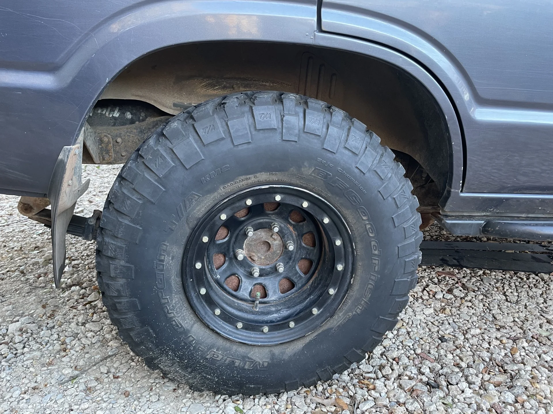

far right is my 200, the middle is my 60, the one on the far left is just to "poke" a little fun. I don't want to even know what the offset is on my 60, now that I know about it.
The picture that @lx200inAR posted above shows why geometrically that a larger diameter tire wants a lower offset. It is related to the kingpin inclination angle built into the upright of the suspension. We can drill deeper into the why and geometry, but might be more compelling by example. TRD Rock Warriors were made for a 32.7" tall tire, and is why they are +50mm offset, versus the stock +60mm offset for a stock 31.5" tire. Project this inclination angle out for larger and larger tires.

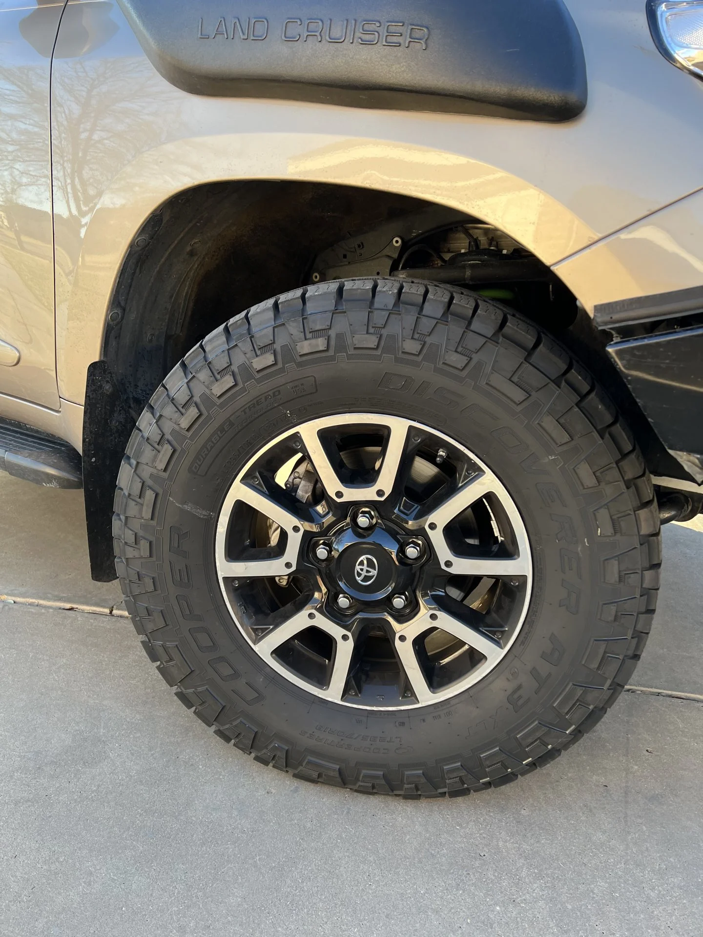

Sure, there still needs to be clearance and granted mine is on the aggressive end. My picture was only to show even with the vehicle slammed (it'll still tuck beyond that), that I've done the due diligence to flex out the suspension and it clears without rub.

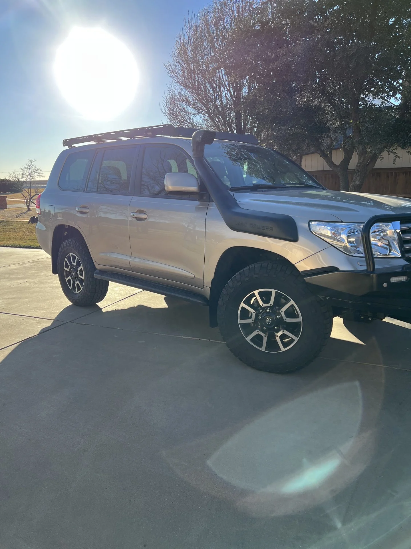

Switched to an A/T and thoroughly enjoying the switch. My current driving situation requires a fair bit of highway driving and M/T tires are not a good fit for me anymore. Went with the Cooper Discoverer AT3 XLT (295/70R18.) So far I’m very impressed by how smooth and quiet these tires are.
Still haven’t made my mind up whether I want to switch to a 275/70R18. Not sure if I’d be able to squeeze out a bit more fuel range stepping down in size. A comprobable A/T in a 275/70R18 (KO2) is the same weight as the cooper in a 295 (59lbs.)
Also don’t know if the 275’s would look small on the 200 with the amount of clearance I have in the wheel well right now.
The manager at the Discount Tire I went to said I have 30 days to decide. Decisions, decisions…

That looks great! I like the 275's we have on ours but I am only running the OEM 10mm spacers in the front, if I had a true lift and I were shopping for new rubber I'd definitely be going up a size. That said, there are a few here who are running 275's with a lift so it is done and it looks ok with the proper offset wheel or with wheel spacers. I doubt you pick up much in the way of fuel economy by stepping down a size so I vote you keep what you have there.
How was it fitting them? I see you still have mudflaps. No spacers?
Not too difficult, just have to play with the alignment. Definitely still need the KDSS relocation. I removed the stock mudflaps and put in some generic ones. They don’t bulge out like the OE mudflaps.
