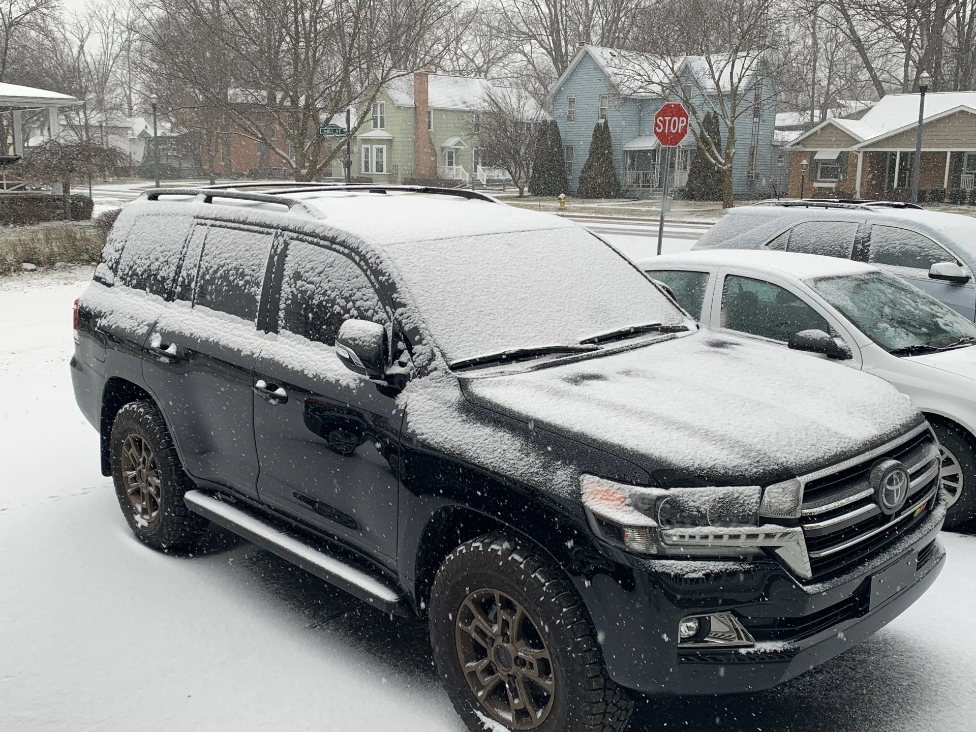

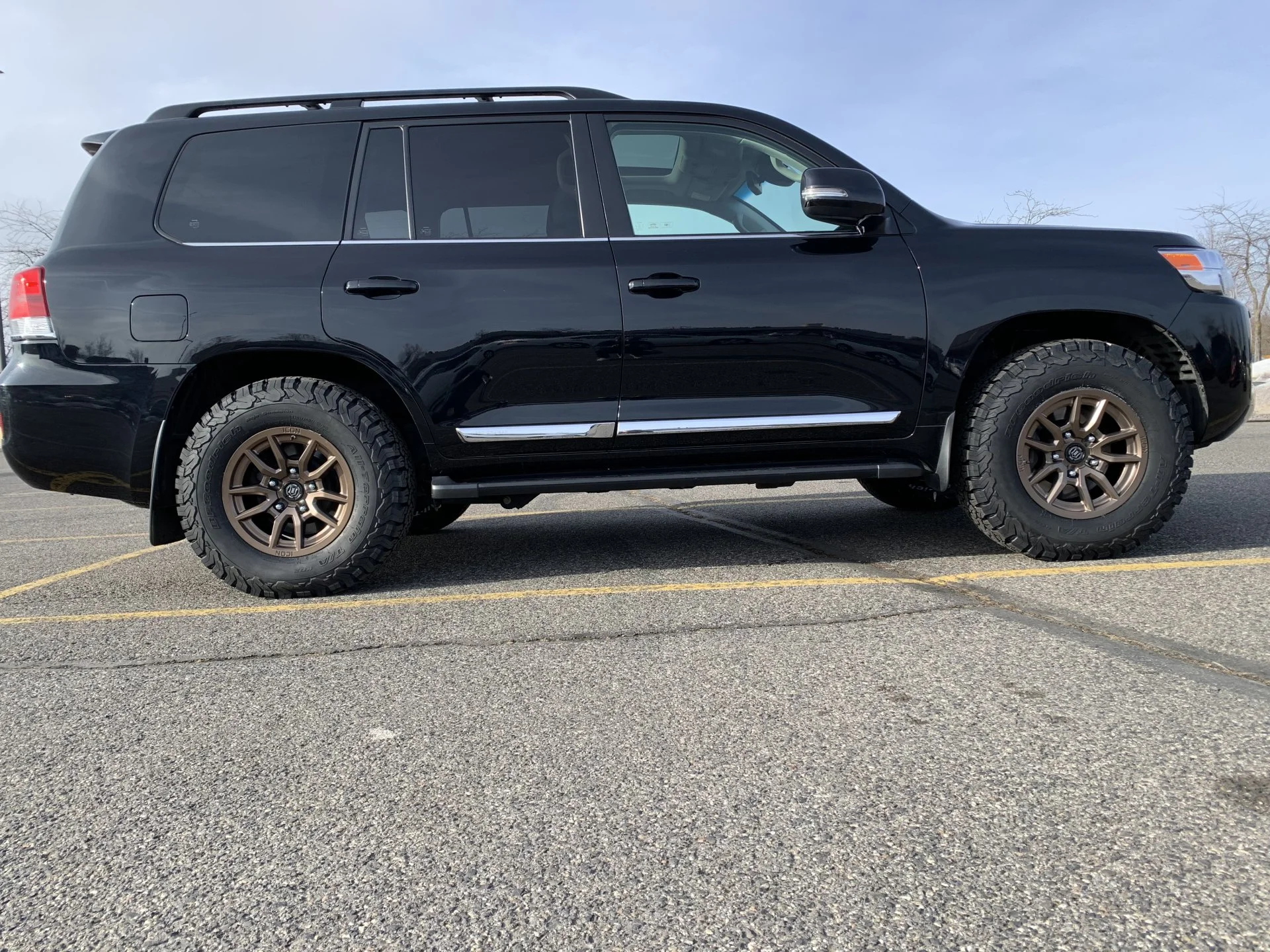

Just added new Icon Vector 5 17x8.5 +25 w/ BFG KO2 285/70/17 E with no lift. Really happy with how they turned out. Very slight rub at full lock on the mud flap. Not too worried about it.
Any pics from the front or back?
I am looking at wheels/tires now and just curious what that ET25 offset looks like!
Check out my stance thread.
