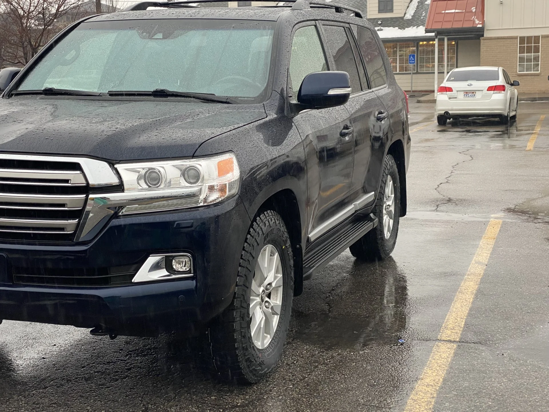

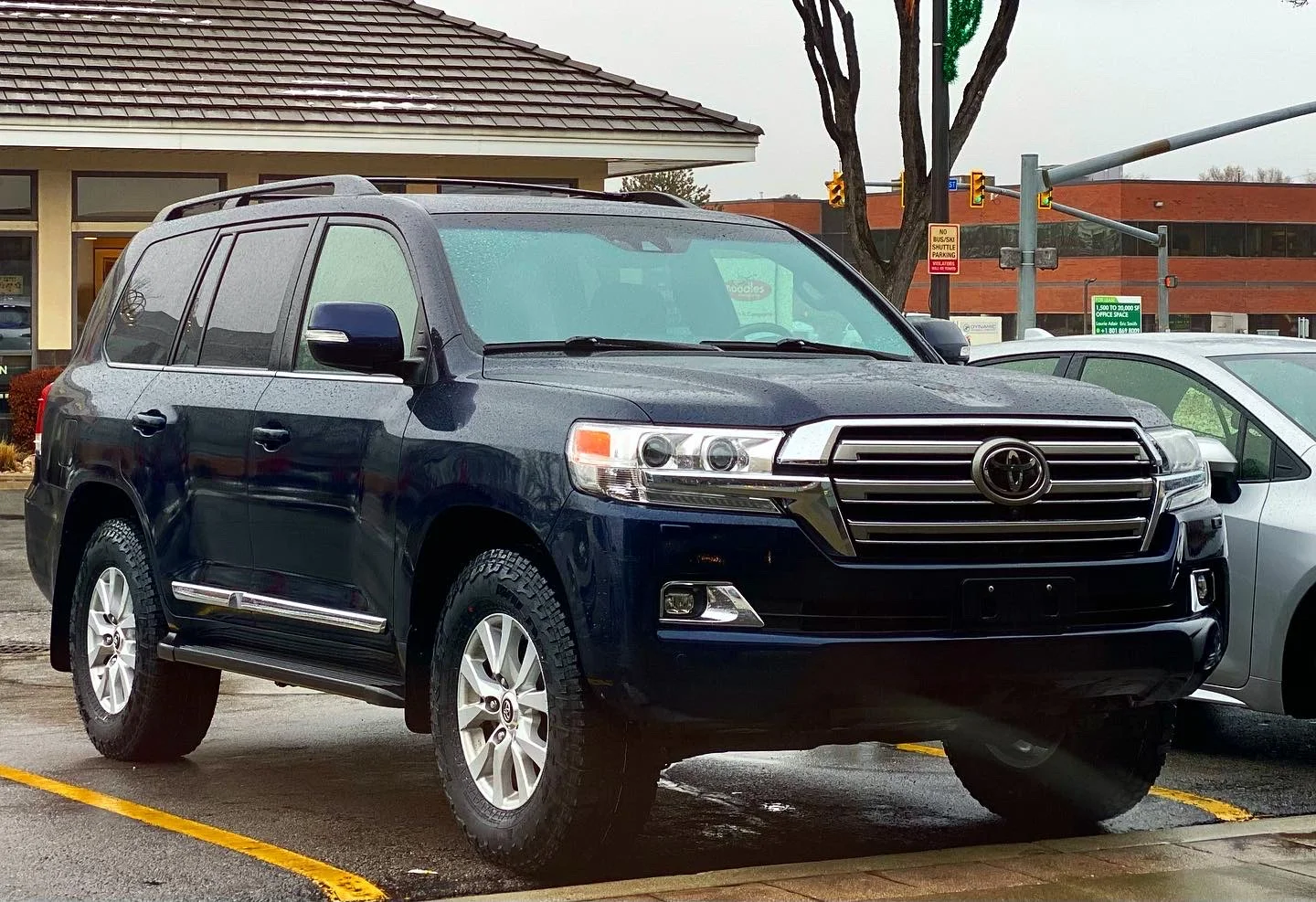

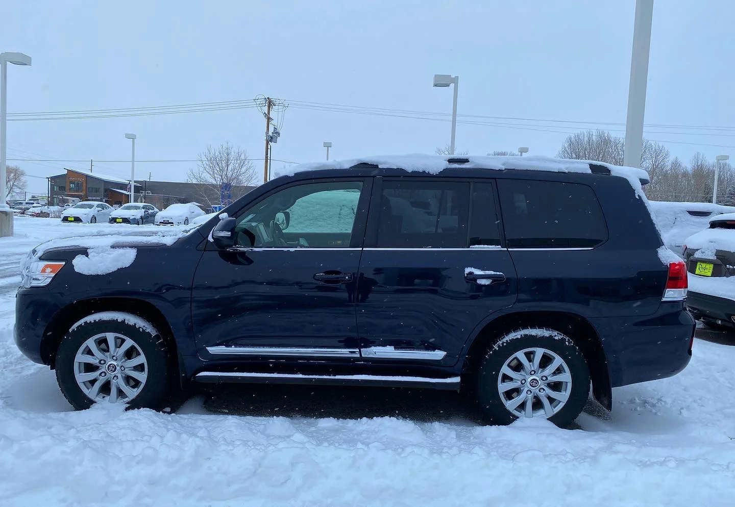

I'm in SLC too- 2016, fully stock right now. Had Falken wildpeak AT 275/70/18s installed on stock wheels last week and getting the coil spacer installed at LHM Toyota tomorrow (hopefully). Without the spacer there's a very light rub at full lock turned left. I assume it is the mud flap.
Discount tire almost didn't want to install the tires because they were sure they'd be too big for the wheel well but I assured them it'd be all good. They were amazed they fit after installing but still had concerns about kdss rubbing at full right lock but I haven't had issues with that.
Haven't wheeled or gone full articulation
Snowy pic is before. The rest are after.
The guy before me had 265/65/18s Toyo open country on it so were pretty measly

Those look great. I little forming/trimming I am ok with. Thanks for pictures and feed back. I will post up as soon as I get mine done. I'm still waiting for UCAs to come in before dropping it off for the install.

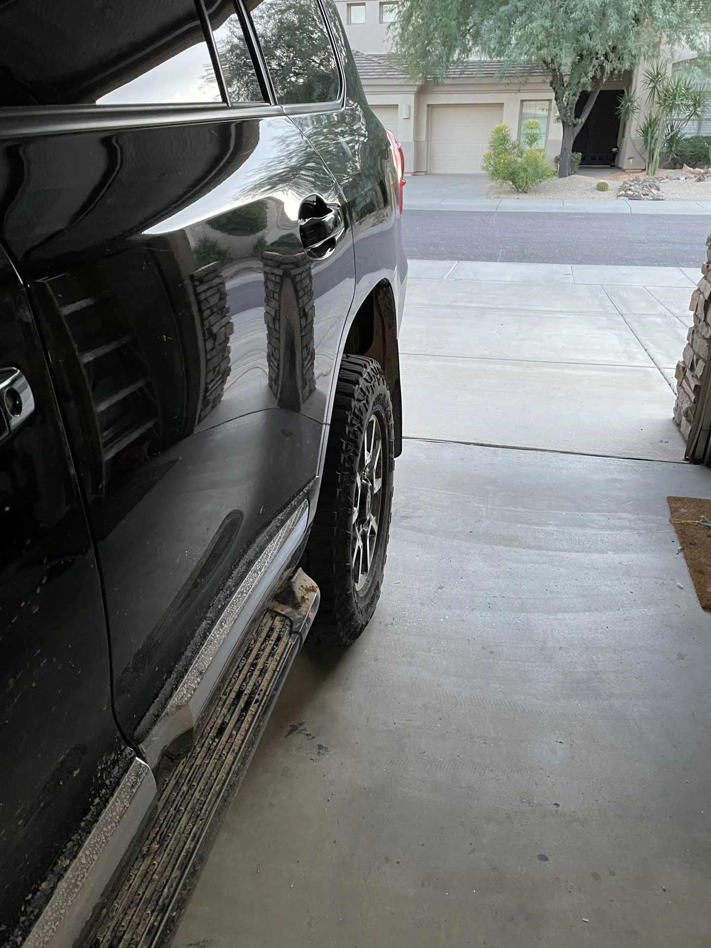

Can’t find a wheel set that like that fits the way I wanted. I’m trying spidertrack spacers. Here is before and after, is this a bad idea? All of the 9 inch wheels with 25 or less offset are to wide for my taste. Any suggestions would be great.
So you want more poke? Icon make some +25 offset. Then there are lots of tundra fitments in +18, 0, and even -values.
No, I want the same as now. The only wheel I have found that is close is the Oz rally raid but would poke out another 10mm.
Ah, so wheels in the 40 to 25 offset range.
Alphaequipt has +35 in 17@ and +25 in 18”
Method has +35 in 17”. Icon has +25 In 17”.
Or a 1” to 1.25” spacer on stock 60mm 18s.
Evo corse has a size with this offset as well.
