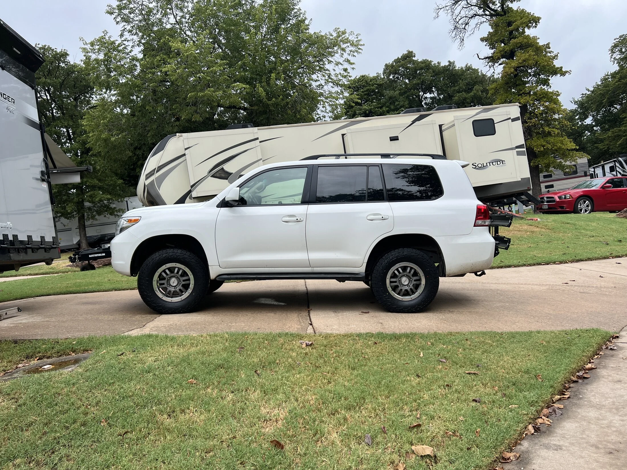

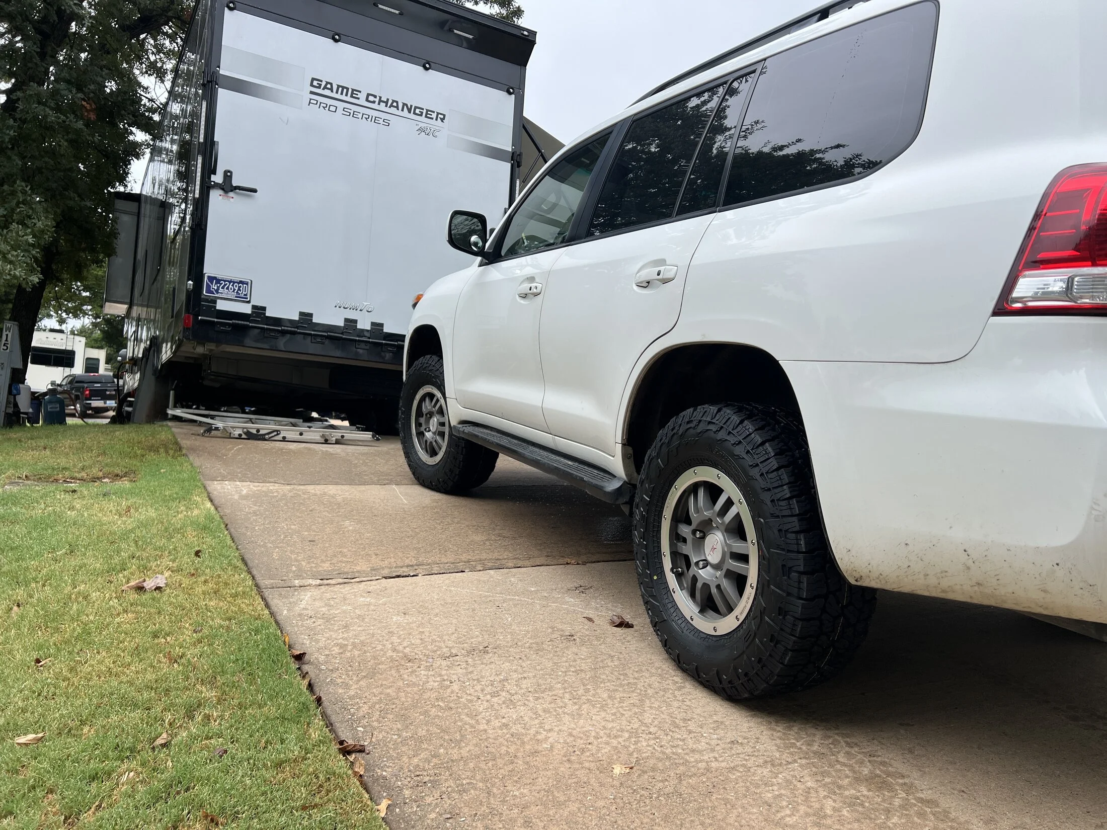

Wildpeak AT4W in LT 285/70r17 load range C
I previously had Toyo AT3 in P285/70r17. I had planned to go up to a 285/75 but I am taking a 1000 mile trip next week and didn’t have the necessary time to sort out fitment of a bigger size. My compromise was to get the Falken, which is running slightly larger than other brands.

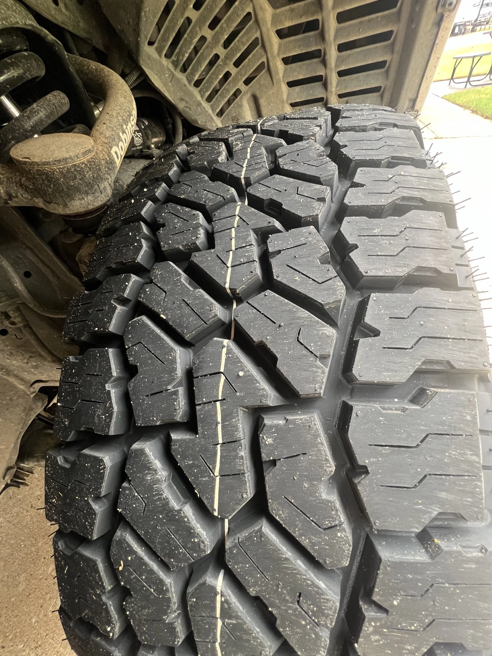

I have wanted to put LTs on the vehicle for sometime. The SL Toyos were very soft; I was able to flex the sidewall just pushing with my thumb, even with the tire at 36 psi. The new tires have a slightly increased whirring noise at low speeds, but seem quieter on the highway. I assume the noise is due to the change to LTs, more aggressive tread pattern, and 18/32” tread depth. Road imperfections are more noticeable, but are far from harsh. Note that I do have Dobinsons MRA suspension, so I am able to adjust accordingly but have not done so yet. I was concerned about the weight of this tire, but the truck handles it like a champ. The increased weight is hardly noticeable, especially with the improved handling from the stiffer sidewalls. They seem well balanced and smooth
I am very happy with the decision both from a driving and aesthetic standpoint. I still have some size envy, but new tread plus slightly bigger diameter will do it for now. I am hoping to lower the front ride height soon, which should help as well.

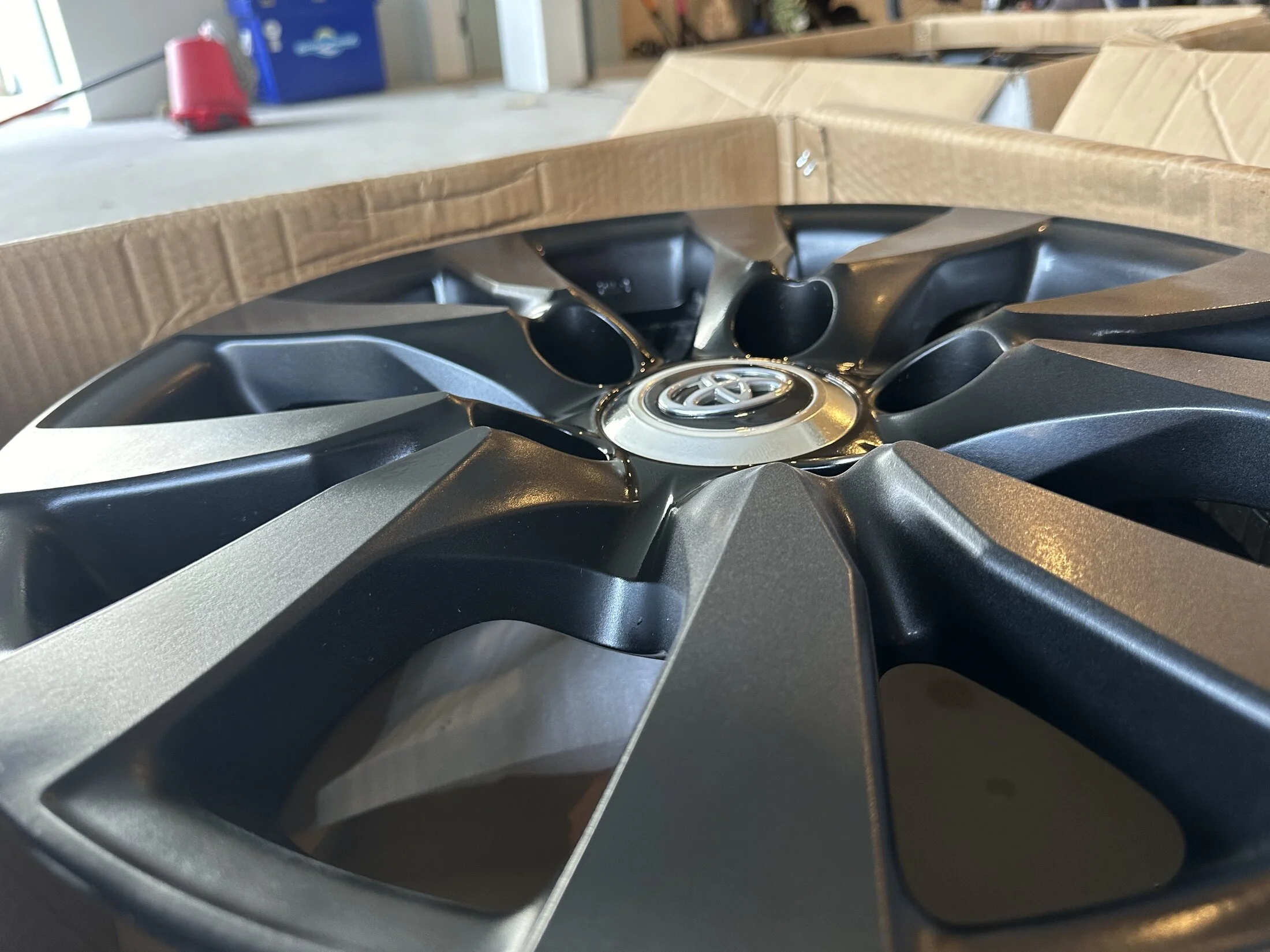

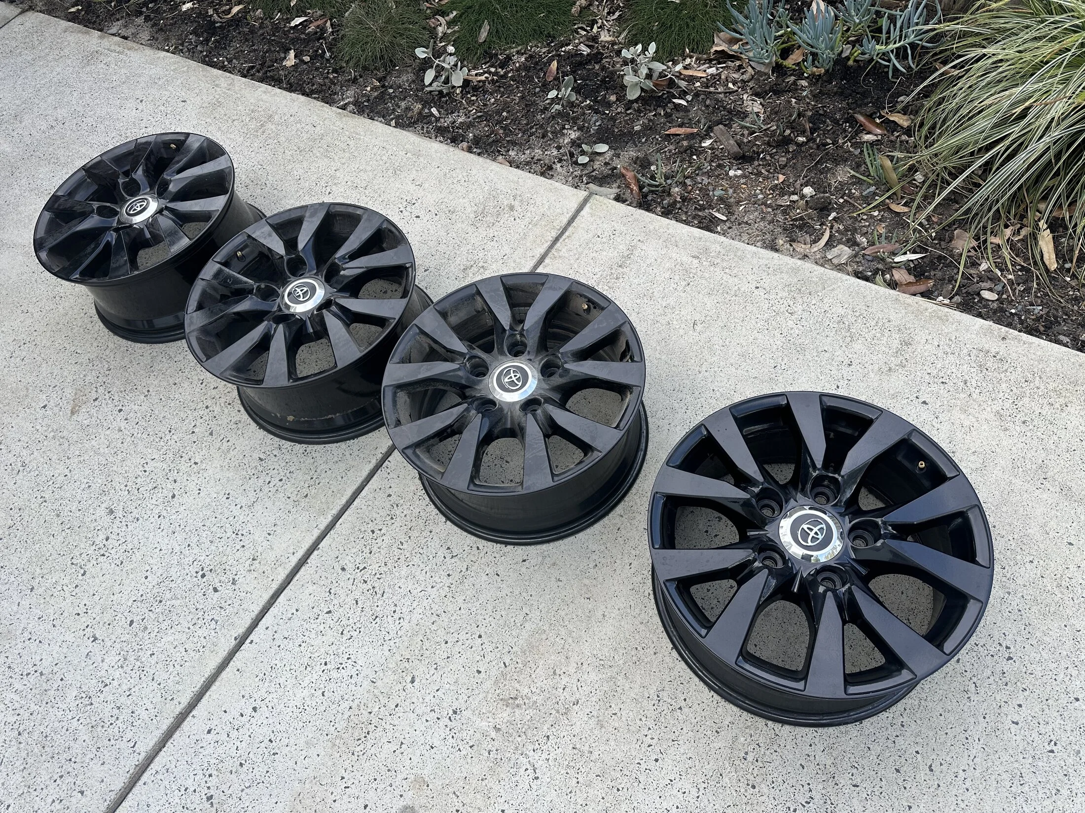

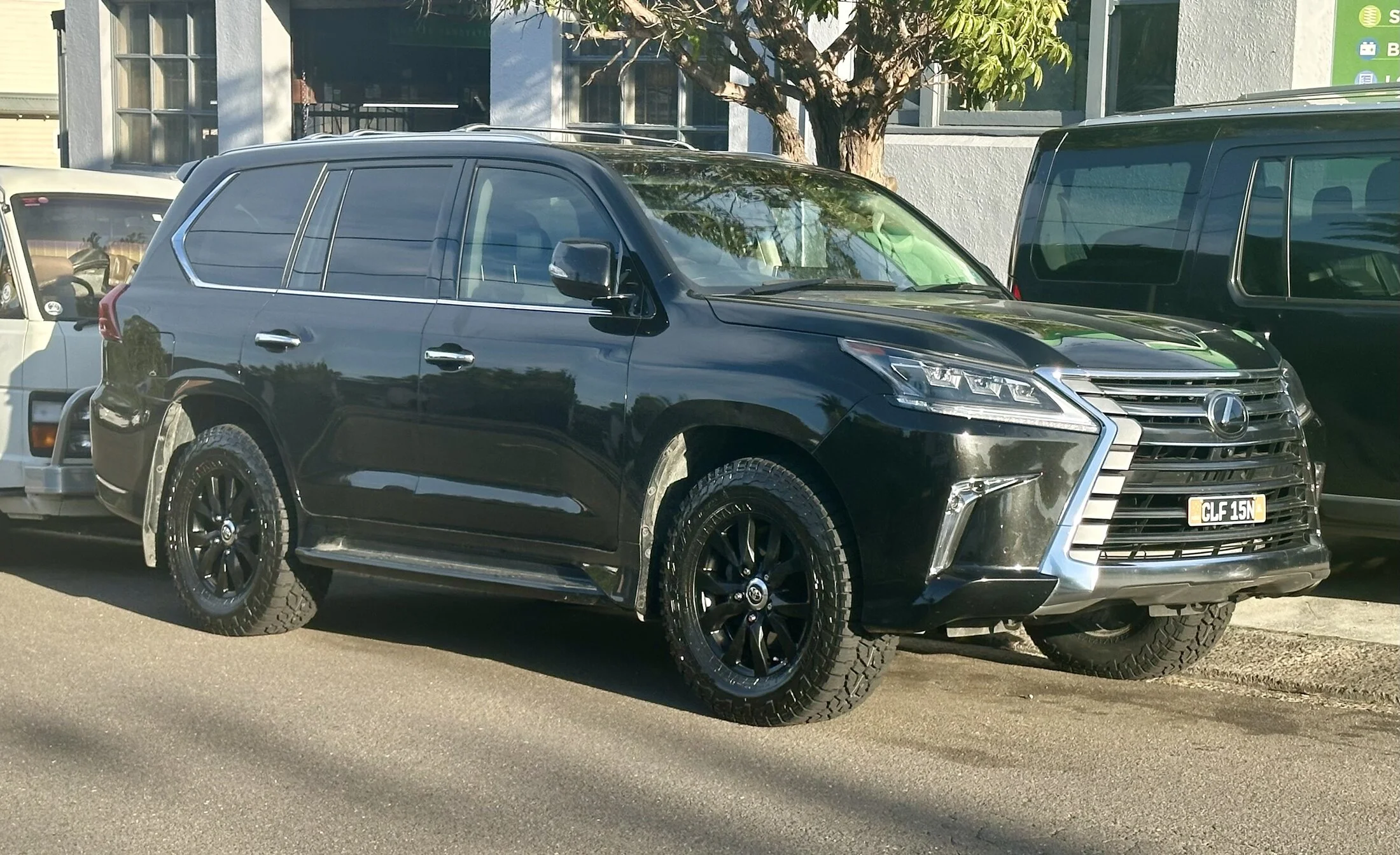

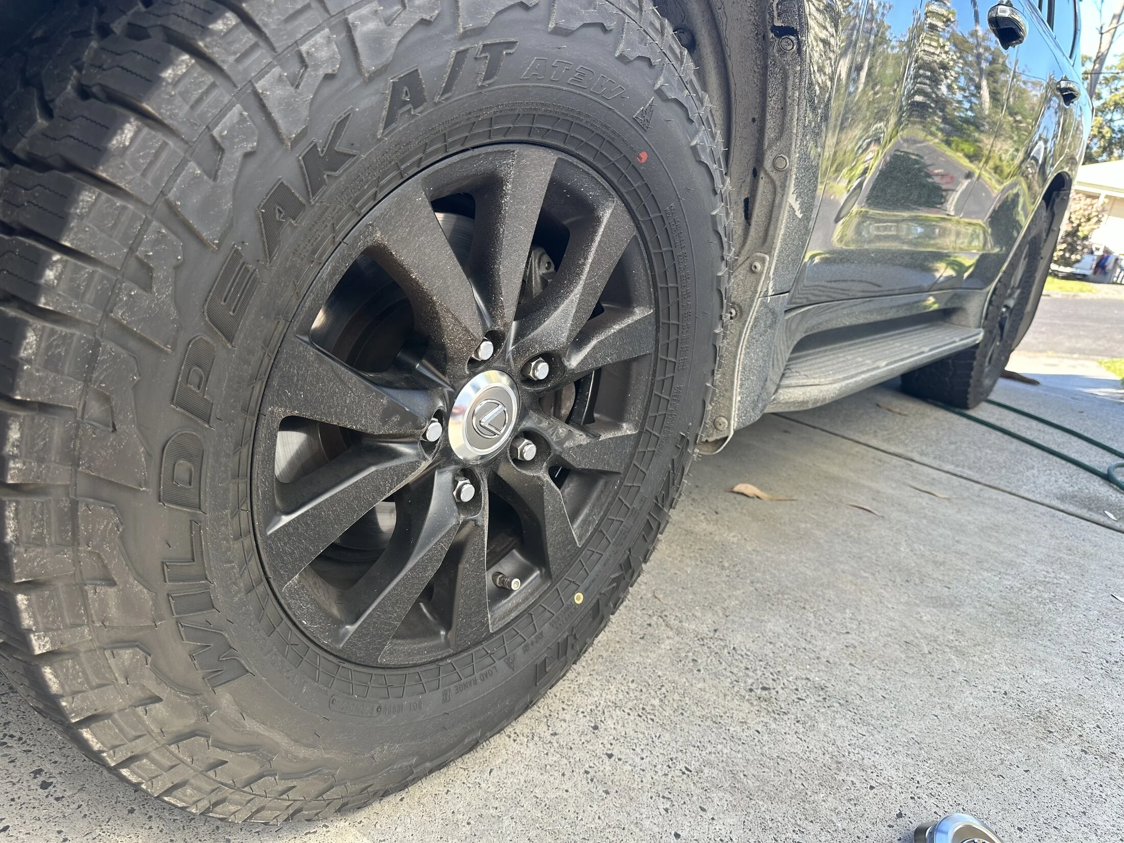

I realized I should have posted my new tyre / rim setup here for the forum, sorry to double up. I bought some LC rims which were powder coated with black gloss, then sprayed them with a satin finish as I don’t like the gloss look. Picked up 5 for $400, powder coated 3 weeks prior.
Apparently my new Lexus centre caps are being delivered tomorrow to replace the Toyota ones on now. QUESTION: is there an easy way to take the centre caps off the rims without taking the rims off the car?

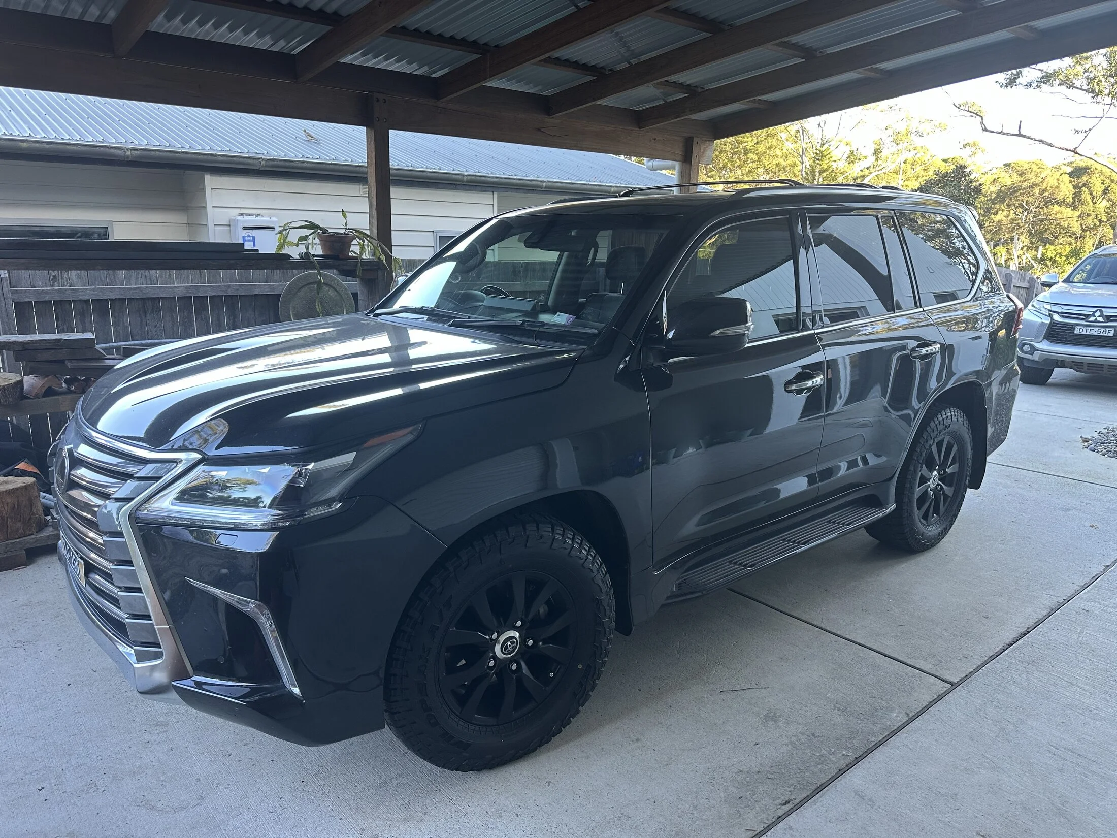

I then put 285/65/18 on, Falken ATW3, load range E. They are at 40-42 PSI. If I could run them lower for a cushier ride I would but I think they are still more compliant than the 21’s on before. They have completely changed the look and attitude of the car. Looks and is a far more capable truck now. God knows why they had 21’s from factory. They are 4% bigger than factory diameter at juuuuust under 33 inches, and it works out pretty much the same fuel usage on the freeway. No additional noise on the freeway, you can notice the extra weight of the tyres though.
Some pics:

Gang, is there any tips on removing the LC rim centre caps, without taking the rim off the car?
The new Lexus ones have arrived and I don’t want to destroy the ones on now taking them off. Though am tempted.
Not really. Maybe wait until you do your next tire rotation if you don't want to make an extra wheel removal. If the originals are installed properly there is a metal ring helping to keep them in, that can't be removed without taking the wheel off.

Success!! I was going to paint the centre caps a darker colour, and get black wheel nuts, but I actually love the contrast to the black.
Same thing for the chrome on the car, was going to black out, but I actually prefer the contrast to the black paint now.
