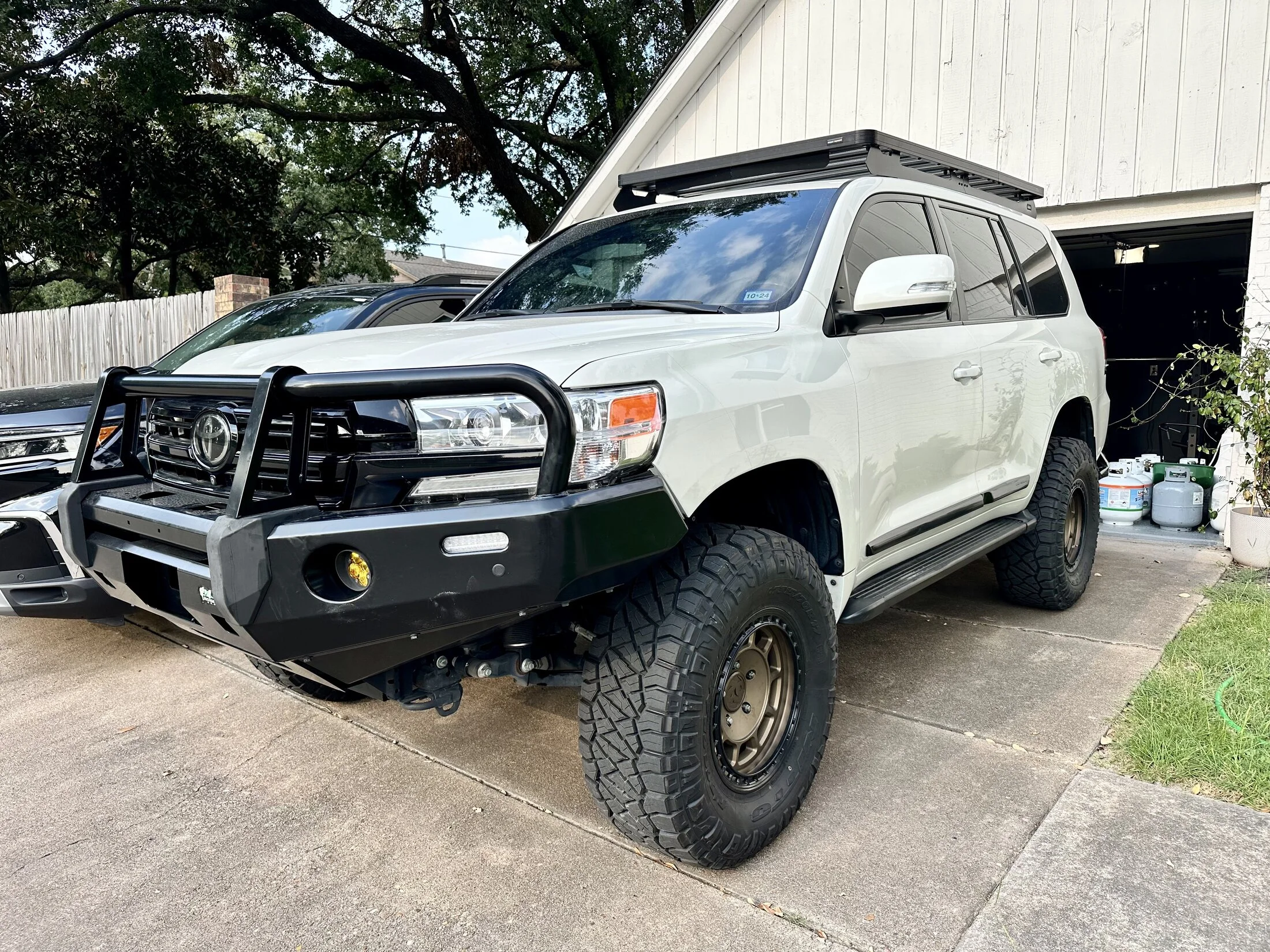

As long as you have the wheel offset dialed in (anywhere between 20mm-35mm) you"ll clear the front driver KDSS and body mount with a lt285/70r18. Its a no brainer for me to go with this 34" size.... other then the price Toyo charges for their lt285/70r18.... total
highway robbery lol.
Regear using the complete front and rear 3.90 diffs from the 2008-2015 cruisers is a very affordable way to go and stay all OEM quality. Somewhere around $1500-$2000 total for drop in OEM diffs is a fantastic option if you plan to regear with the 8spd.
I was planning on using a 1.25” spidertrax spacer if I go with 285/70. Good to know I can use the earlier diffs for the 8spd. I may do that in the near future if I can keep it under $2k. In the meantime, I just don’t want my Cruiser to feel sluggish and burn thew fuel at a rapid clip.

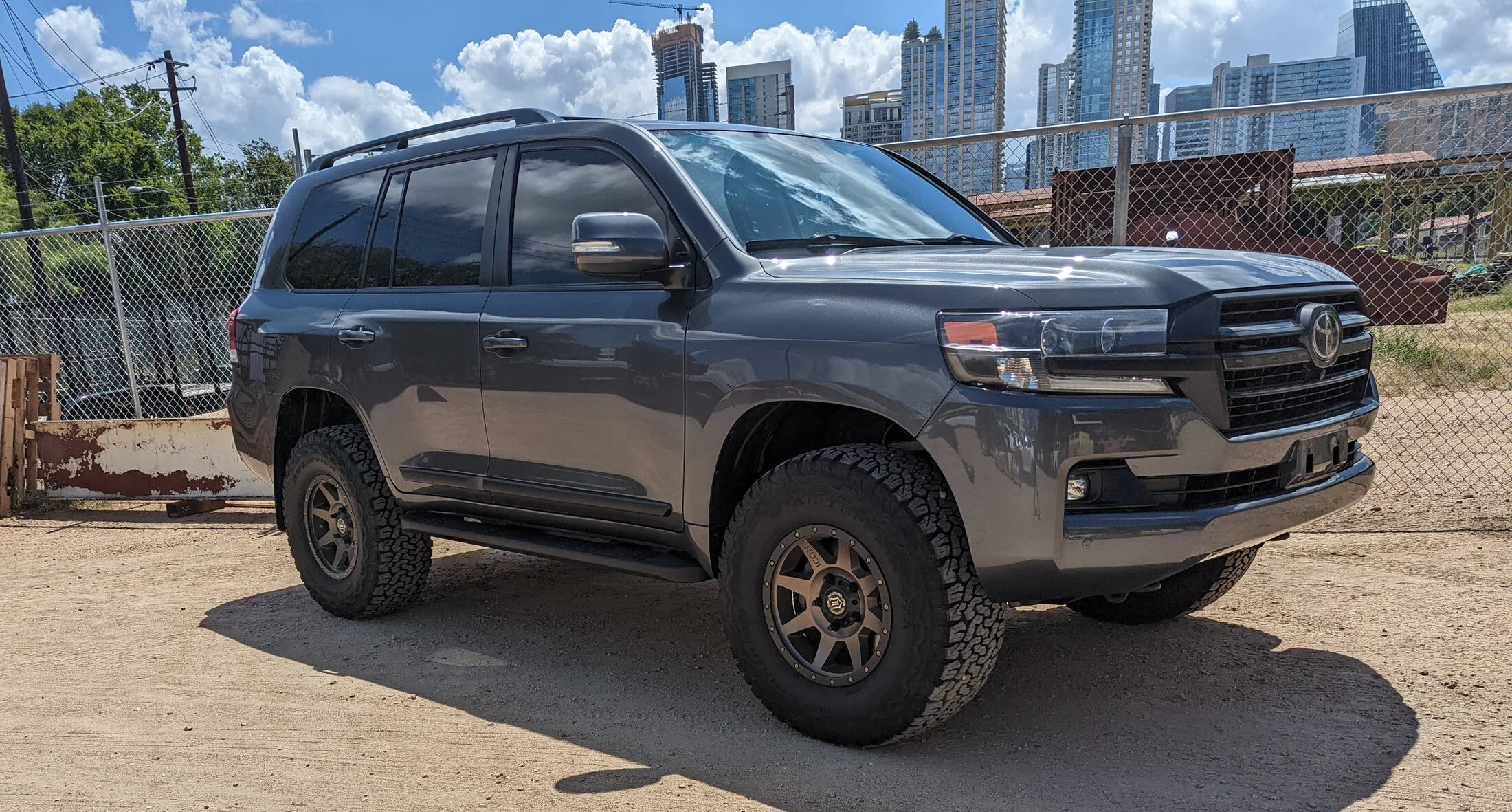

Just got this back from the shop. It can be done but it was a tight fit. Running ridge grapplers 315/70/17.

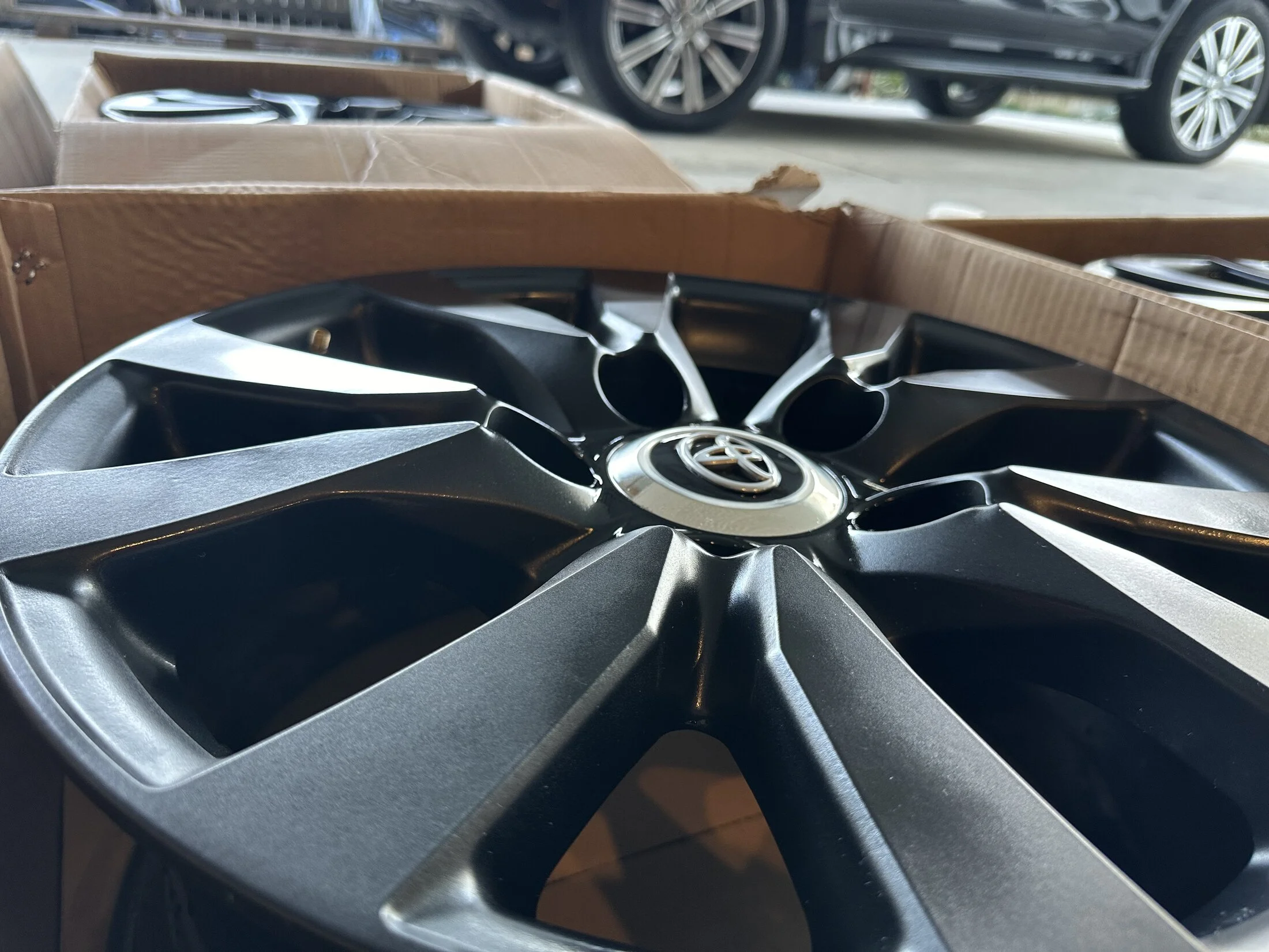

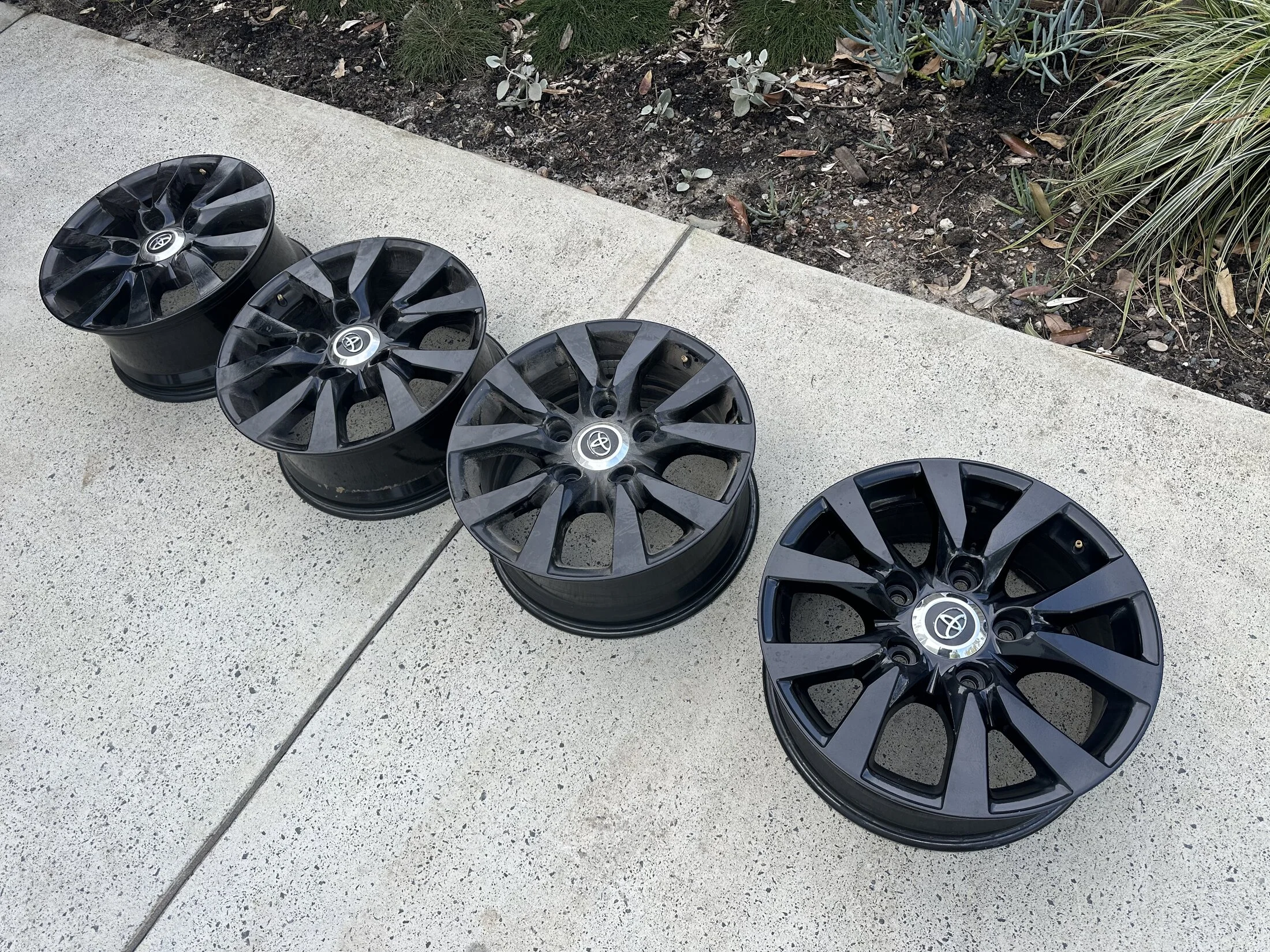

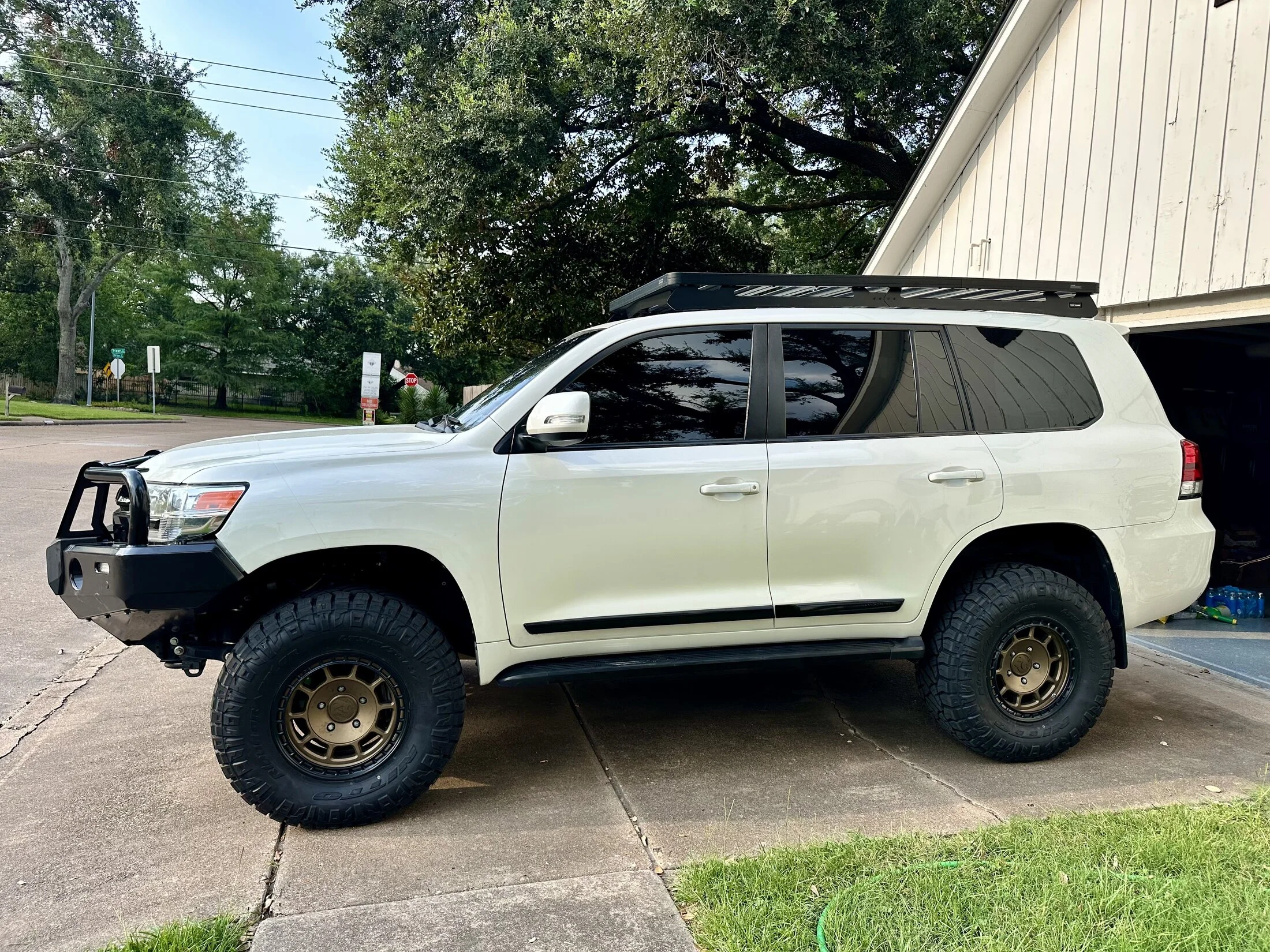

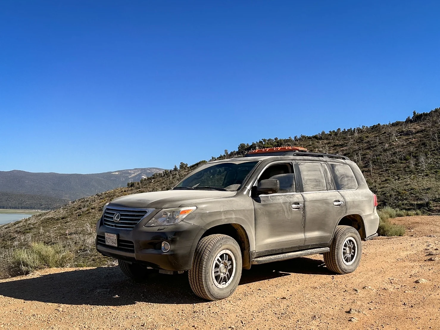

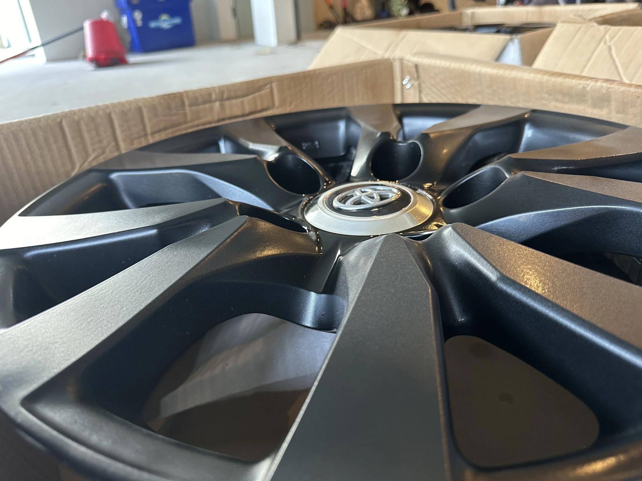

After reading through this whole forum, pretty much every post, I decided to go with some LC 18 inch rims for my ‘16 LX. I found a set recently powdercoated in gloss black, which I have now sealed with satin finish as I like the matte look much more. Im super stoked how they came up!!!! Pre and post photos below.
Next week, Falken ATW3 going on 285/65/18, can’t wait to feel the difference from 21’s I’m hoping they are a lot more smooth riding. Main reason though is to be able to air down for sand.
