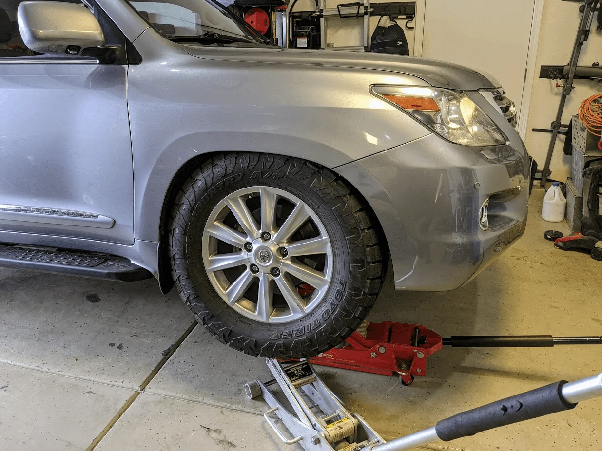

Sorry i thought you were talking about stance. Can i have a photo of the "poke" with your setup? Or direct me to a post.
I think this is what you're asking for. I think the ride height is about 4" higher than stock.
With Tundra arms, RW wheels and 285-75r17 tires, they still fit in the fenders. Wider offset wheels will probably have contact with the fenders.
