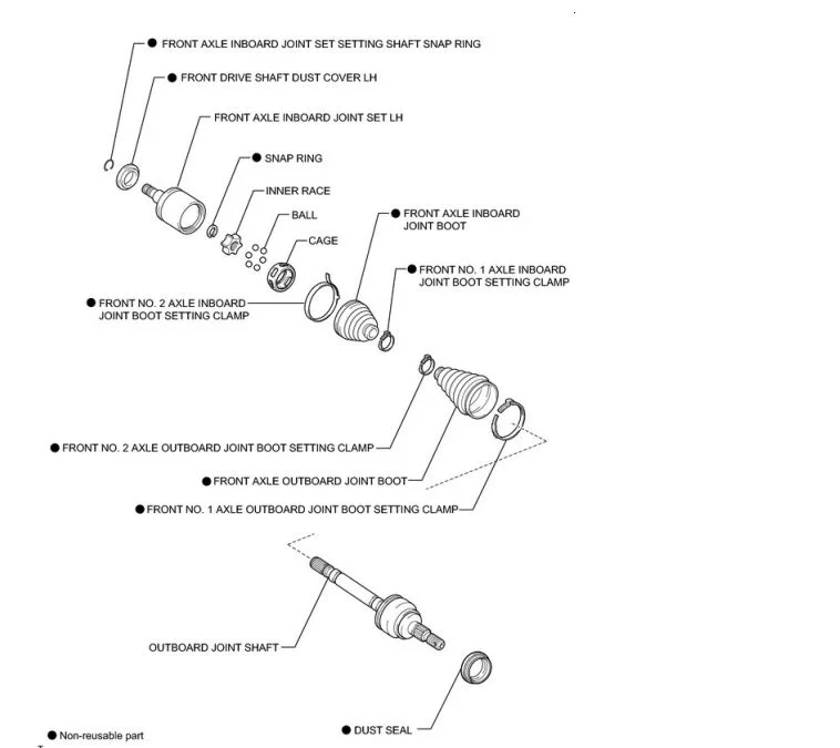

On to the Cv's. Bought them used off ebay. Figured I would refresh them with new boots/dust seals. Any reason to do more disassembly than that to inspect them? If anyone has good resources for servicing them, would love to take a look at it. Thanks!
Since they’re of unknown condition I’d pull everything apart and clean it well then carefully inspect the balls and cages for any scarring or wear as that’s where you’ll get clicking. Might check the FSM to see if there are any other specific checks recommended.
Thats what I figured. Getting the inner off is simple enough, but oddly enough there is very little about disassembling the outer out there. Even the FSM shows just the internals of the Inner.
Did find this video that seems to be the way to go. Funny shout out to land cruisers in it. But its all predicated on breaking a clip, and doesn't really go into reassembly. Although I did find another video referencing a "zip tie method" but It didn't seem like they put the clip back in. So Ill probably just clean the outers as well as I can without reassembling and then inspect them, unless I'm missing something.

The snap rings are to my understanding designed to be replaced, so breaking the clip I think is fine. The replacements should be cheap to order.
That said to be fair I've not broken apart and rebuilt a CV, so you're probably wise not to trust anything I say here (or probably anywhere, honestly).
FWIW if you're still reading you may be fine testing the CV by simply extending it at all sorts of various angles and rotating it. If the balls rotate smoothly then it's probably fine. You're really just checking for imperfections in the ball surface that would be signs of wear and an indication you should replace them and/or the cage or inner race.
You can usually manipulate the joint in different directions enough to look for wear on any of the relevant surfaces. The challenge is getting enough of the moly grease out to have a good look at everything.

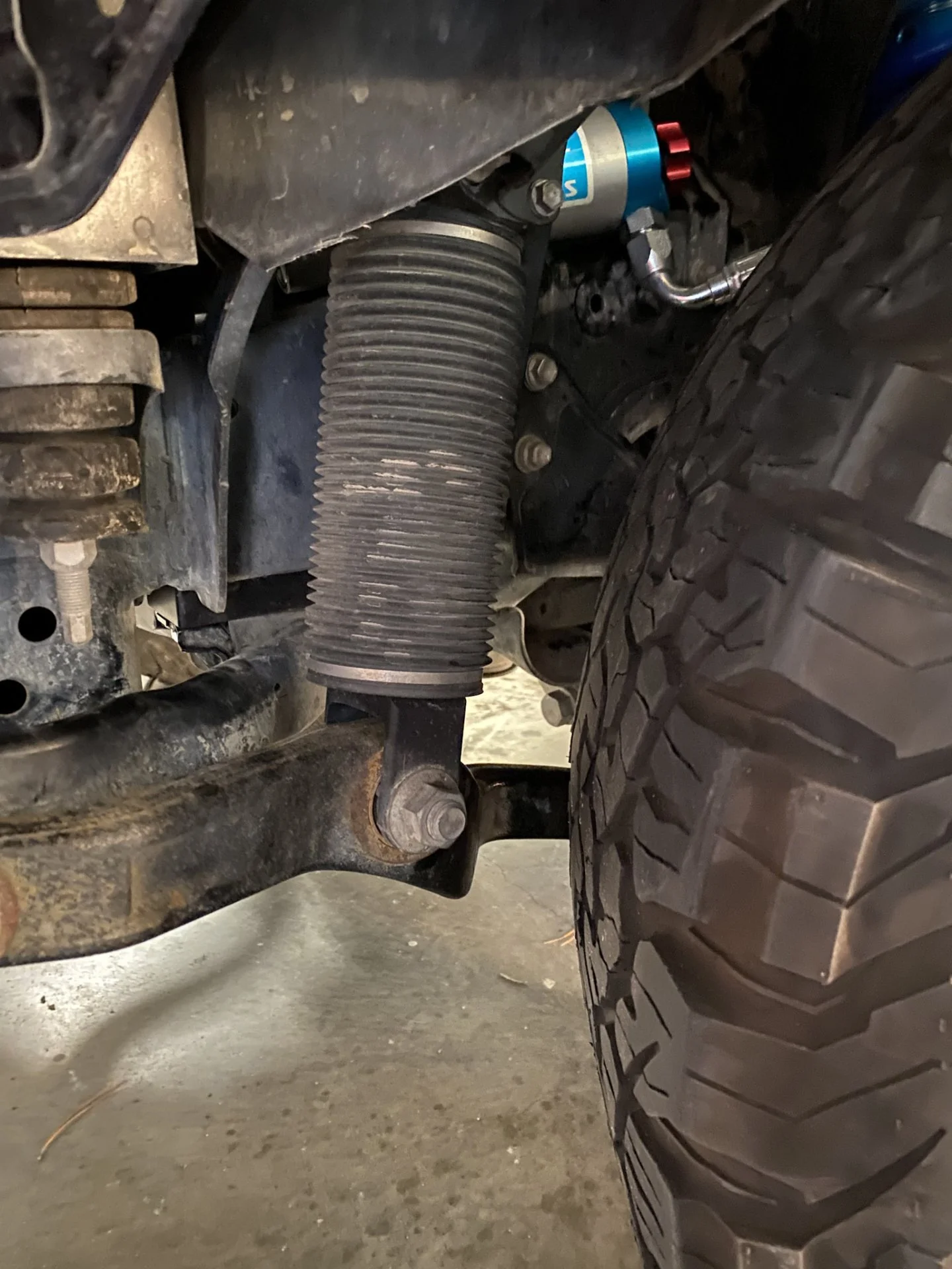

With the aluminum spacer inside the LCA cradle the flanged bolt head (and washer) press directly against the inner metal sleeve of the end link, so it is held tightly in place. I used the Toyota front diff mount bolts to do this and we just cut like an inch or two off the end so they wouldn't bottom out... I had them available since I installed a DD kit a couple years back which came with longer bolts.
On the plus side if you did shear the bolt off your handling would get squirrelly until you fixed it but it's not like that bolt holds anything else important in place.
Pre-bent links would be ideal IMO (along with a KDSS relo that moves the mounting point another 1/2" or so further forward). Unfortunately nobody has made them to my knowledge. Alternately I suppose you could fab a cradle extension and weld that in place, but personally for maintenance reasons I'd prefer a readily available replacement option (like new weird angle end links) than a completely custom job (like a welded LCA)

The only advantages of welding a new bracket into the LCA is to provide double shear strength and some protection to the bolt head. So long as you have a good 1.5" spacer in the cradle, you shouldn't *need* to do through the effort.
If you feel sparky BDS makes some adjustable length Tundra end links which may work. Someone else on the forum used them and said they work though they had to grind a small bit off the very top or else it would hit the nut on the tie rod.

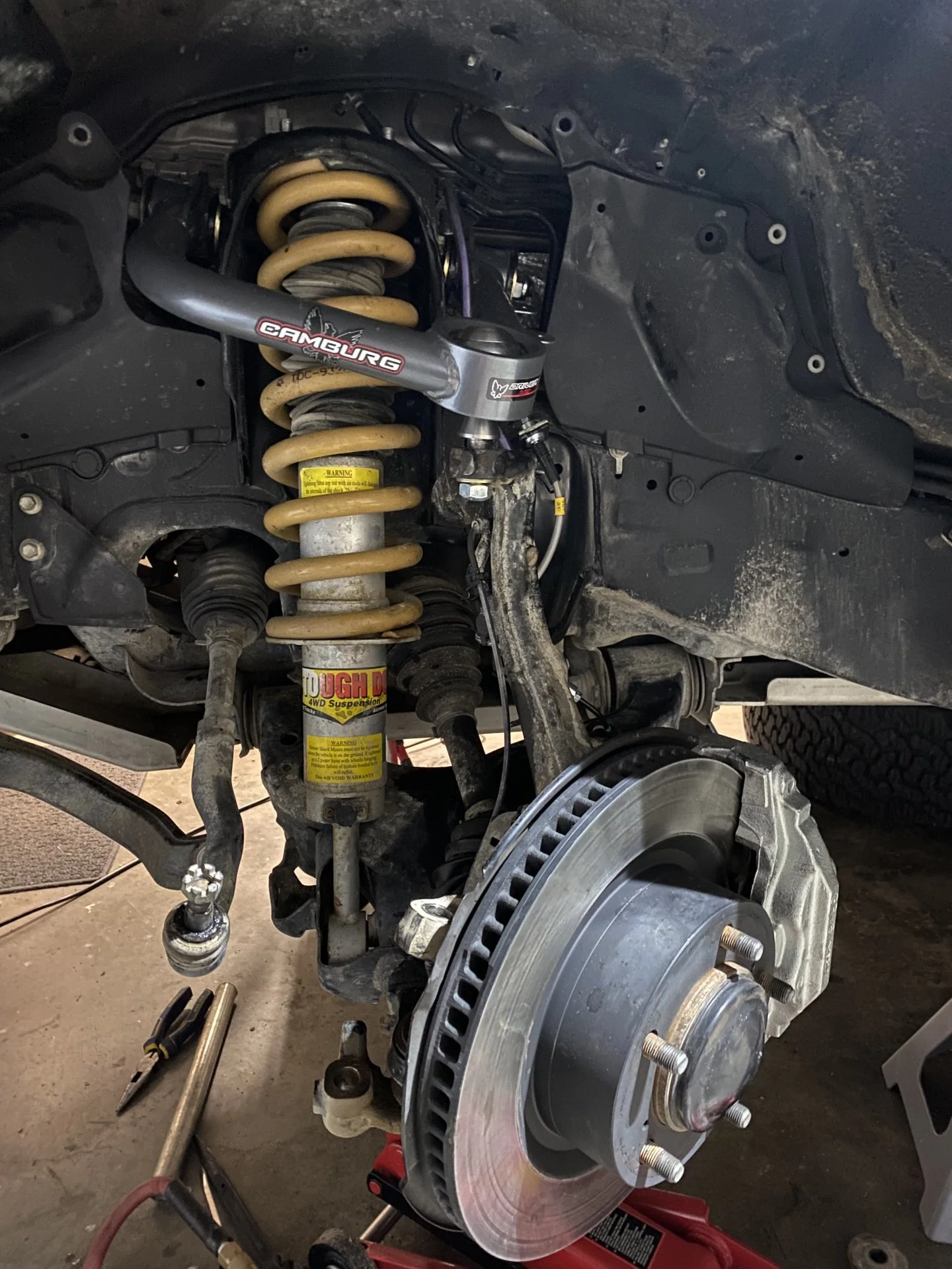

Here is as far as i got, UCA installed loosely on the driver side. Yes i didn't have the abs on the outside of the UCA which meant I got to unclip it and re route it. Was surprised I couldn't get the toughdog strut out, even with disconnecting the LCA from the steering knuckle.

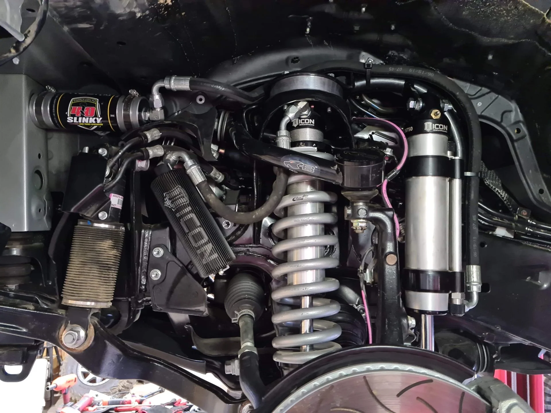

One last question for now, where did those who have reservoirs mount them? KDSS definitely in the way of where they intended on tundras mounting them.

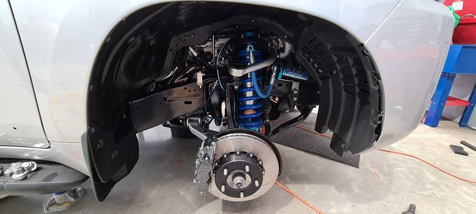

Easier if you remove the plastic splash guards here is mine on the busy KDSS side with secondary bypass
On their 200 series kits king provide reservoir mounting brackets that put them on top of the frame above the 2 - 12mm bolts that hold the small plastic splash guards on. On the KDSS side it sits inboard of the stand-off on the frame.
If you dig around for king 2.5 installs on 200s you’ll see pictures.
3.0 IBP with EFM but you can see the res (Extended and finned)

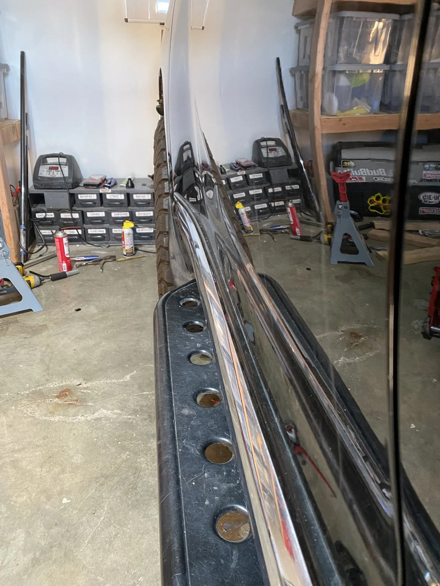

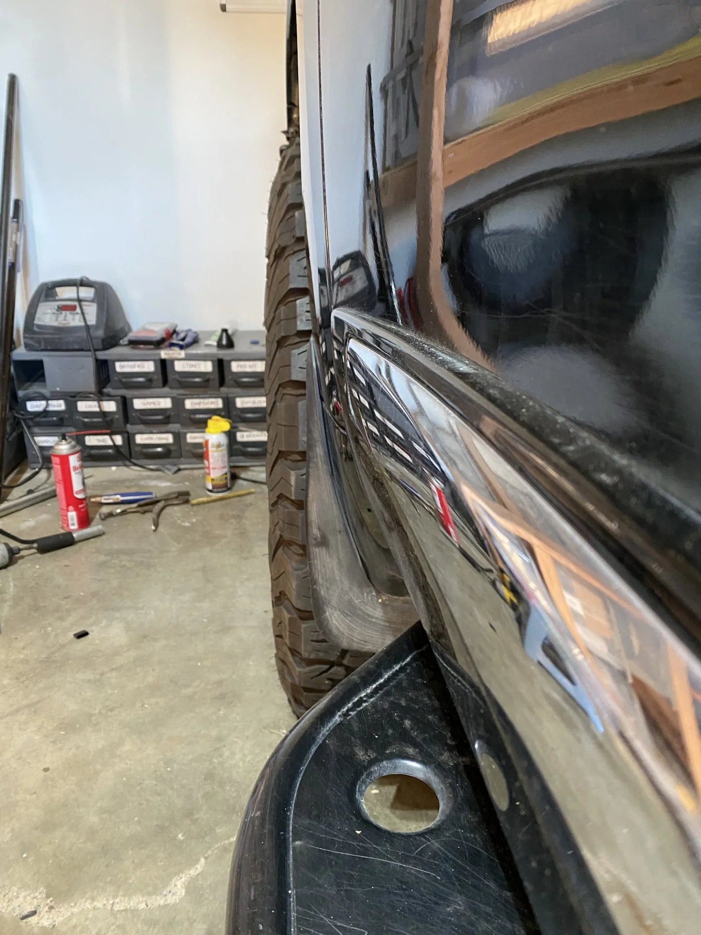

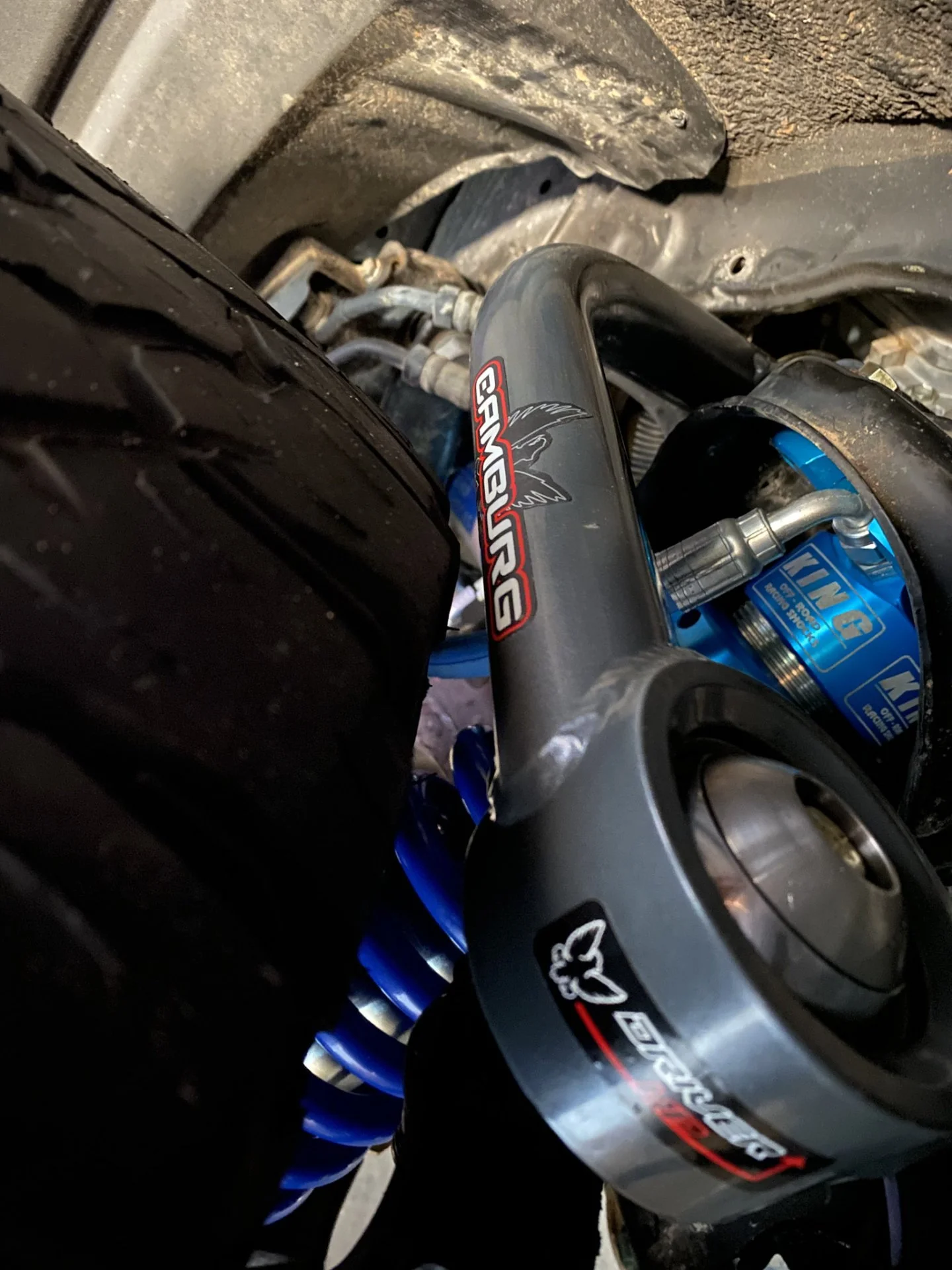

Able to make more progress. Procured a 315 70 17 KO2 of craigslist and had it mounted on the spare to check fitment. It is a pretty worn tire, but looks like it should fit decently with some fender persuasion. Still need to reattach the sway bar. But at least it makes me feel good enough about ordering 4 more of them and not being hosed with useless rubber. Some comments
- Really happy with the track width
- The camburg UCA's maybe werent the best choice. They seem to be larger than most around the upper ball joint, getting very close to rubbing. And they don't have as much adjustability. We will see post alignment if I regret capitalizing on a good price for them.
- Still waiting on axle seals to replace the ones i damaged while trying to pry out the CV. For future noobs like myself, I got the second cv out with zero prying, just a 2lb sledge. Passenger side is easier than driver, start with that one.

Man the rear area of your front wheel well is a really tight fit there. There's a lot more space in the KDSS arm though. Any idea what your caster is set to? Seems like it might be awfully low. Remember the body moves independent of the frame/suspension so what barely clears when parked often will rub when bouncing around or turning.
You might need wheel spacers to git rid of that UCA rub once the tire bulges and moves during normal driving. I don't know how long the studs are but you may be able to get away with a 5-10mm spacer that just fits between the wheel and the hub without going to a full ~1.25" spacer with its own lugs
