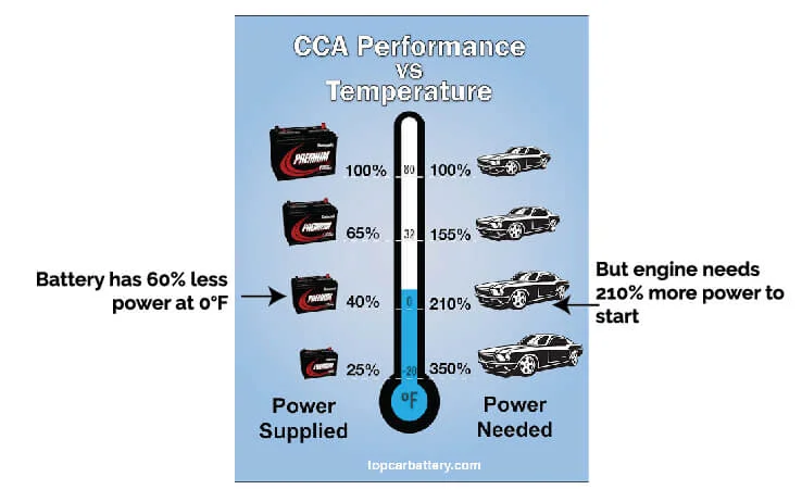

Yep, cold affects your cranking amps for sure. And if you have a bad cell, it usually shows up at the worst time. LOL.
Here's an example of battery versus cold. Of course this depends on your battery chemistry etc, but call it a "generalization".

Ahh interesting! Thankfully very rarely do we get frosts where we are in the Winter, so I haven't had to deal with it. Gets very close to 0°c overnight in the Winter though. And come to think of it, my cranking does sound laboured, though I just thought it was the oil becoming a bit higher in viscosity due to the cold. Be interesting to run some tests with this. Maybe wrap the starter battery with an old towel or blanket, make it a hot chocolate in the morning (jokes 🤣) but see if wrapping it up with something improves the starting performance. A lot of folk from colder climates would be interested to know the results I reckon.
