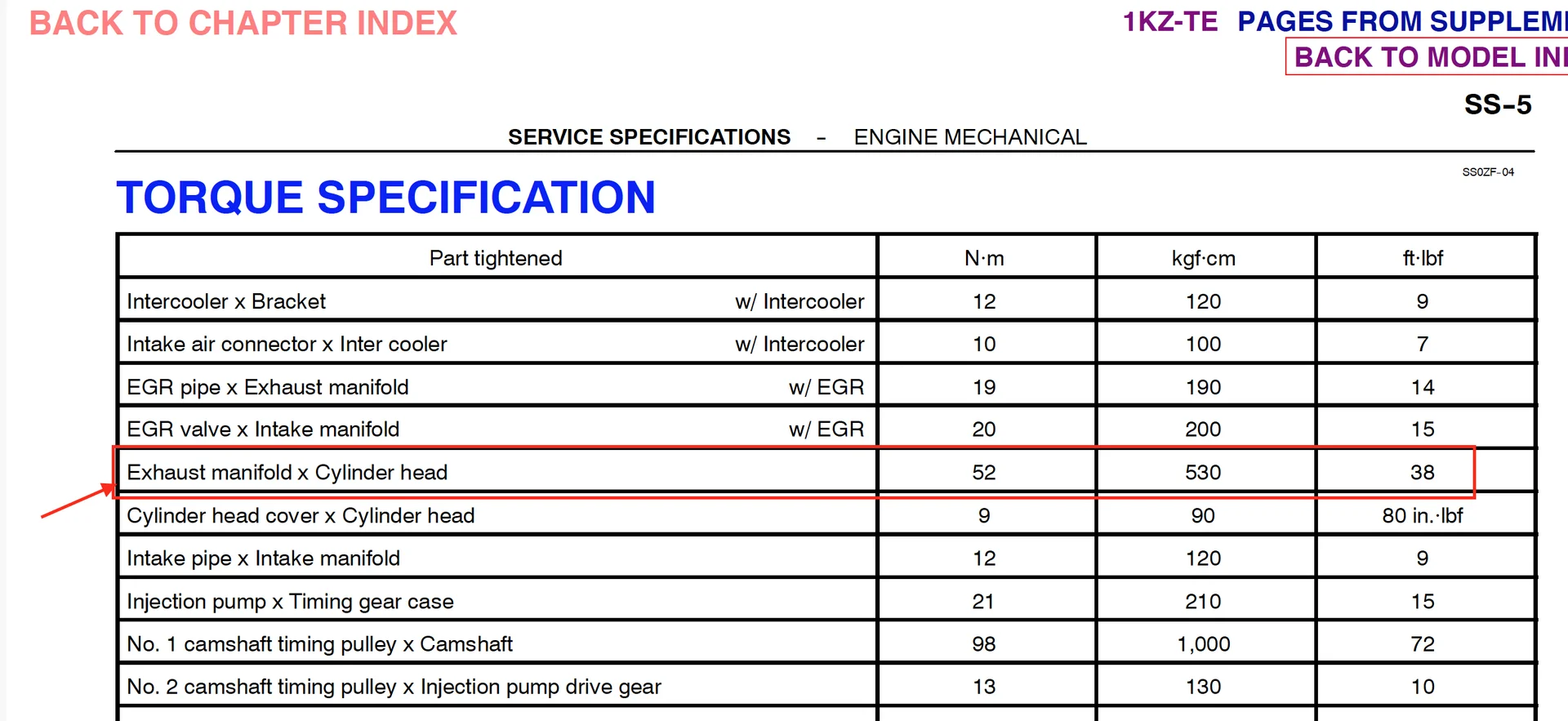

Here is the torque value, this manual i found on internet, so use it you discretion.:)
I just left the studs at 10 Ft Lbs and torqued the 2 bolts & 6 nuts to 38 Ft Lbs. So far everything has been working well without any issues.
