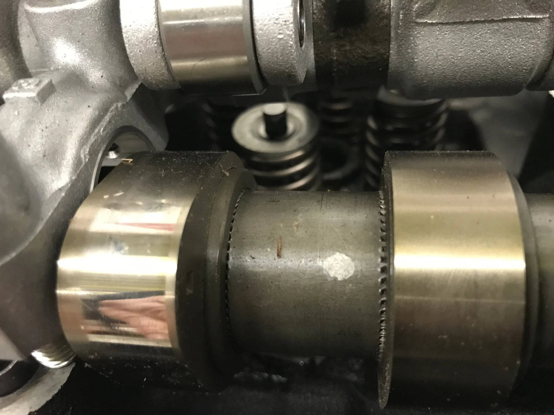

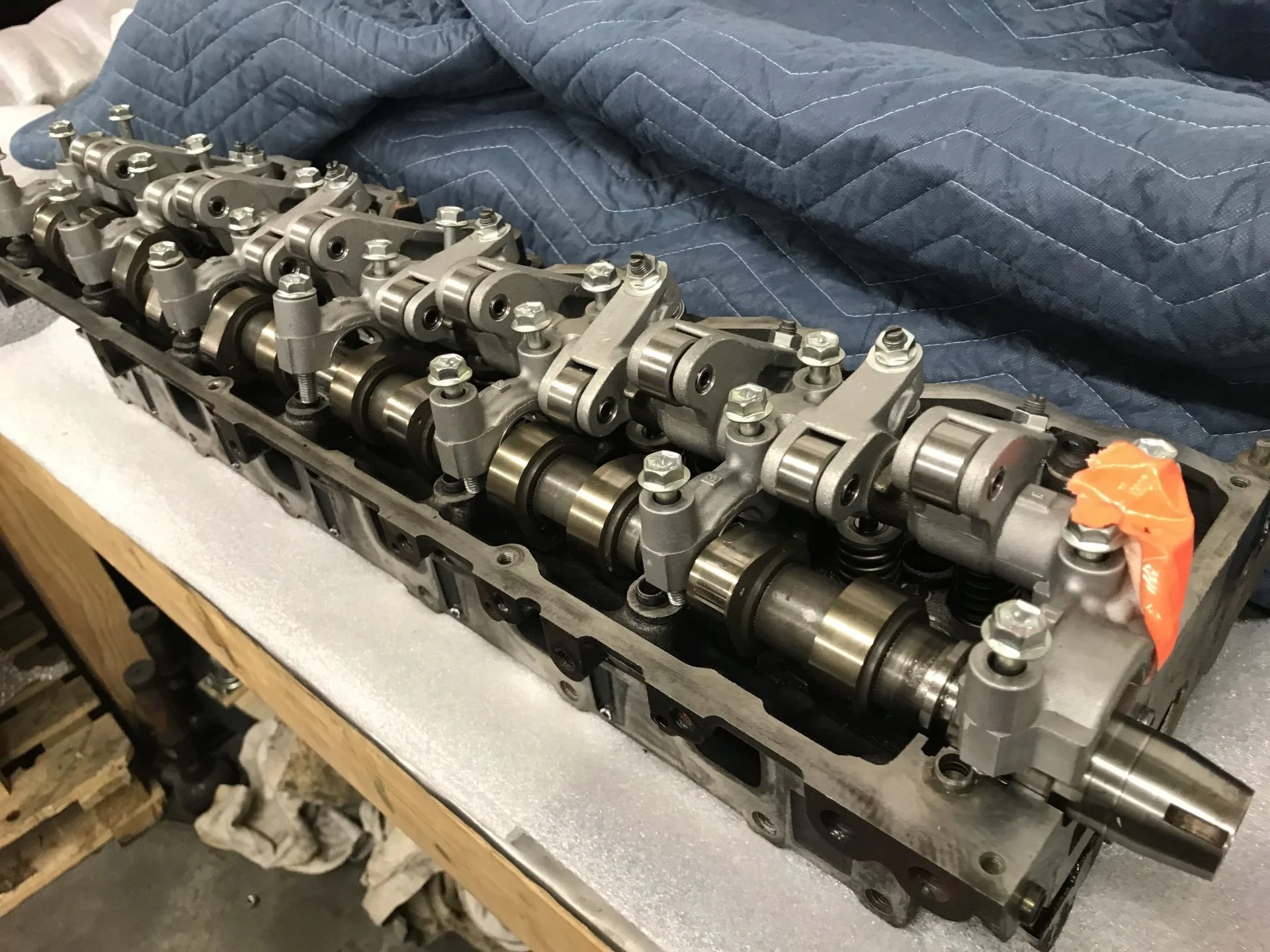

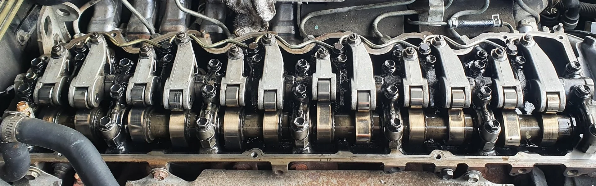

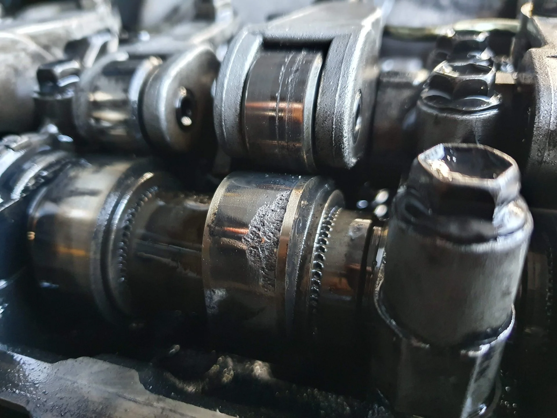

I was setting the valve clearances a few months ago when I found this little surprise on the intake lobe of Cyl 5
Pictures of the cam in my 1HD-FT:
From the cam specialists I have spoken too so far, the general consensus is that it isn't repairable, and after searching high and low for 2 months for a replacement, a mechanic I spoke to managed to track one down so I went ahead and ordered it.

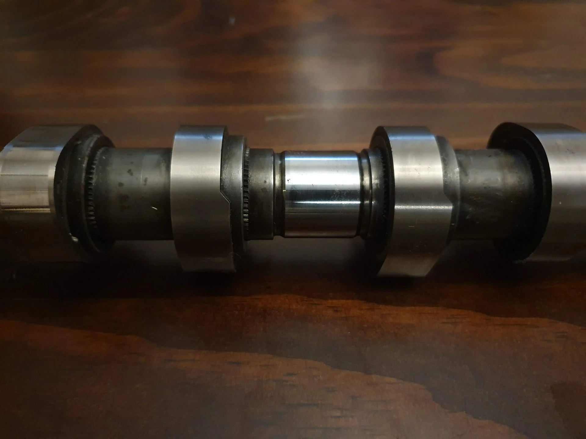

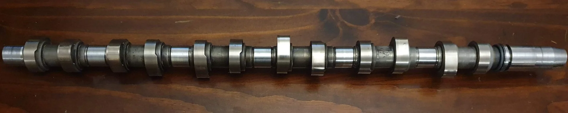

It just arrived yesterday and after having a look at it I have a suspicion that it may be out of the later model 1HD-FTE....
I have never seen an FT Cam with those little recesses/notches out of the back of the lobes, and I have found lots of images of FTE's that appear to match this one perfectly.
Pictures of the cam I purchased - Under the impression it was from an FT, But suspect it is from an FTE:
Any info would be greatly appreciated!
