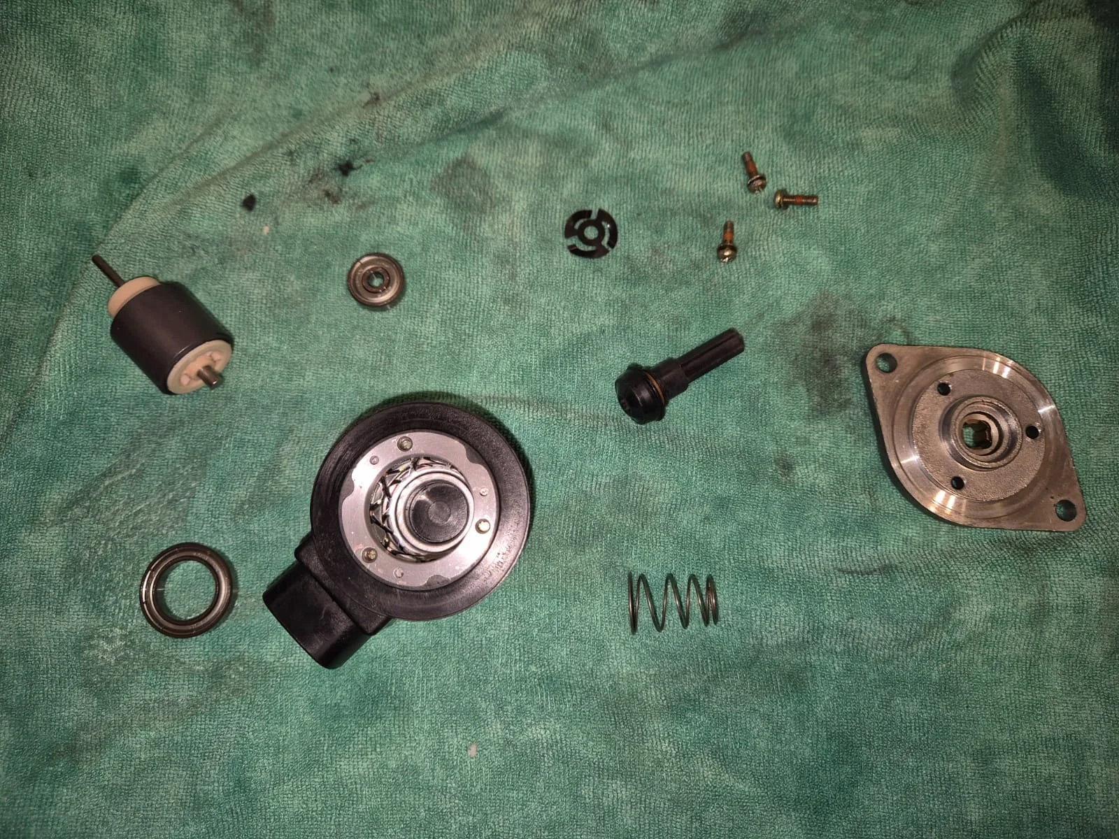

I installed the second hand idle air control valve to see how it would affect the cold start RPM. It does idle a bit higher than the original one, but not as high as they normally do when cold. It looks like someone has opened up the original IACV. The 3 screws have been removed using vice grips as all had rough edges and damage around the head of the screws. Additionally, the shielding to the wires at the connector have been damaged (possibly the auto electrician in Newcastle when installing the loom). I tried to paint some liquid electrical tape over those areas, but it was very tricky given the limited amount of room to work. At least 4 of the 6 wires had been damaged. They all seem to pass continuity tests though, which is a good sign.

for those curious as to what the IACV idle air control valve looks like dismantled.

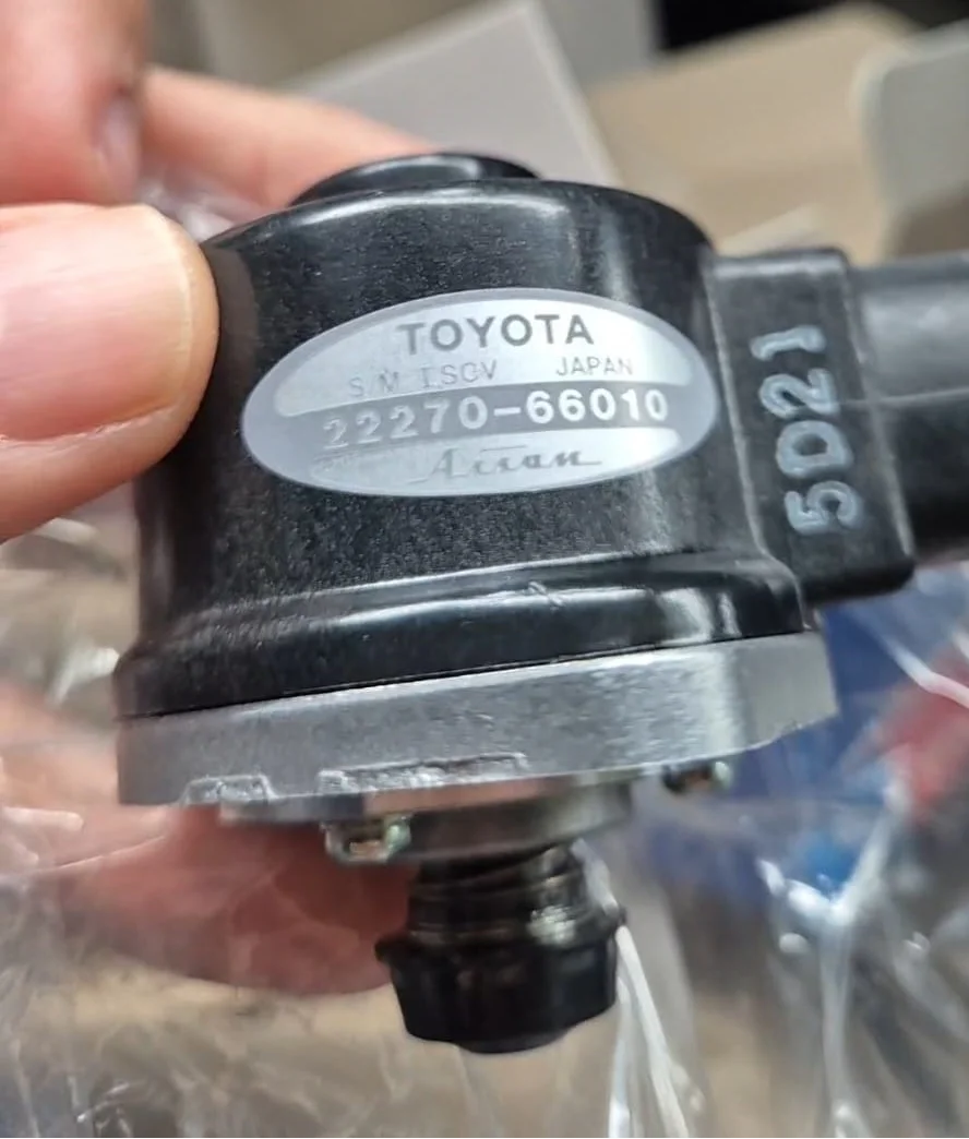

I managed to locate a brand new genuine IACV from an EFI parts supplier locally here in Australia. Unfortunately this did not fix the absence of a cold idle. The revs flare up momentarily before dropping. Which says to me that the ECU is commanding a fast idle when cold, but something is interfering and it pulls back. It also runs VERY rich on start up, puffing lots of fuel smelling smoke. I still highly suspect that this has something to do with the 2nd hand loom replacement my father had completed back in 2021. I'm not sure if this is also why the car bogs down when cold. The 2 may be separate issues.
Next step is to confirm the fuel pump and injectors have good pressure/supply.. then it will be off to an autoelectrician to backprobe every related sensor and plug on that loom.
