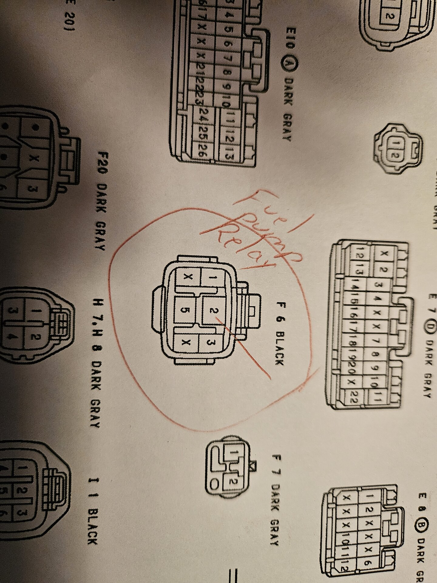

A couple of things, 1) According to LexusV8 the they are unable to acquire the calibration codes for programming Land Cruiser & Tundra ECU's. They use an ECU from a Sequoia. They program the immobilizer out. They are also able to remove the secondary o2 sensors if needed. 2) The fuel pump is controlled by the ECU. They provide wiring that simply connects to the power for the existing fuel pump relay. I have not got that far yet. I will keep this updated as I go.

Concerning the fuel pump, the harness from LexusV8 comes with with a fuel pump relay. He provides an output to run the pump. Simply remove existing relay, remove pump power wire (see picture) and connect to his output.
