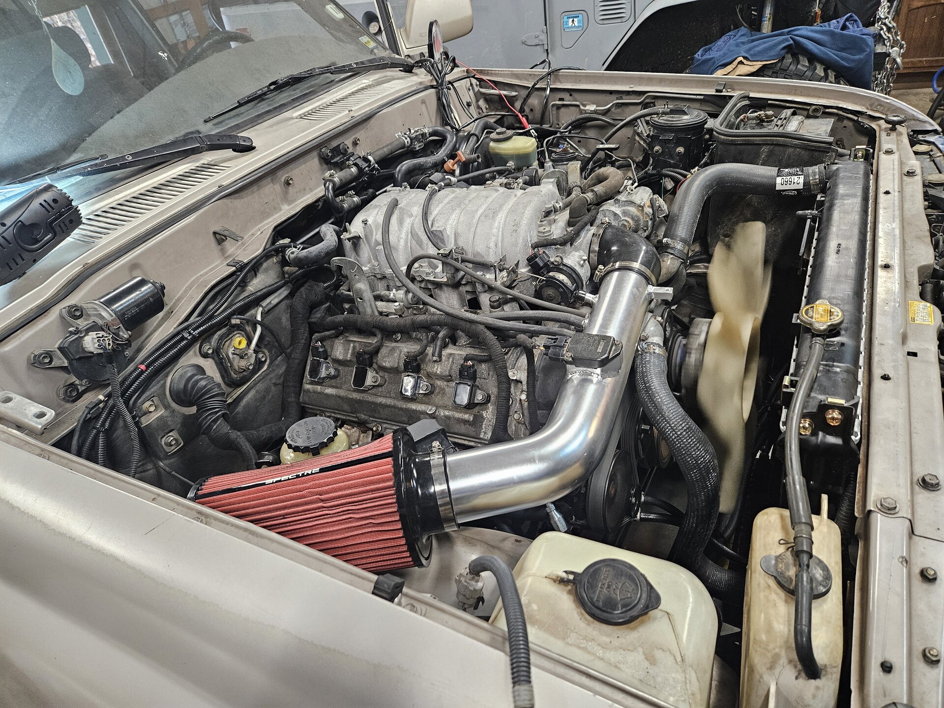

This is the direction I went with the power steering. Banjo fitting at the pump and the inverted flare at the gear box. Both are -6 x 16.5 mm.
For the fuel, I used a filter from a 100 series. It will screw right on the inverted flare supply line from the tank. I had to remove the line from the fitting at the fuel rail and used 5/16" fuel injection line which worked great with the outlet from the filter. The vent line from the tank (the third line) I did run through the charcoal filter. The evaporative emissions has been programmed out, which eliminated any need for a tank purge valve.
Well, this week was spent with a lot of things that make it look like I didn't get a lot done. Got driveshafts made, longer rear, shorter front. Install radiator, heater hoses, power steering lines w/cooler. Did not use the factory p/s cooler. I didn't like the way it ran right behind the oil filter. I wanted to be able to use the bigger filter and the factory cooler would have prevented that. Ran lines to transmission cooler and hooked up transmission and transfer case linkage. I was able to use the factory 100 transfer case linkage, but had to lengthen the transmission linkage by about 4". I was able to run the engine long enough to get the engine warm and make sure I didn't have any leaks. Onward and forward!
How is this project going? I am in the very...very early stages of a 2UZ swap.
It is proceeding nicely. It has slowed a bit, due to other projects. I am now in the process of connecting all the gauge/dash lights to the 4.7 harness. I have completed the transfer case. The CDL now works off the switch and the 4L lever. Next is to get all the gauge lights working, i.e. transmission lights PRND21, oil pressure, temp gauge, etc...

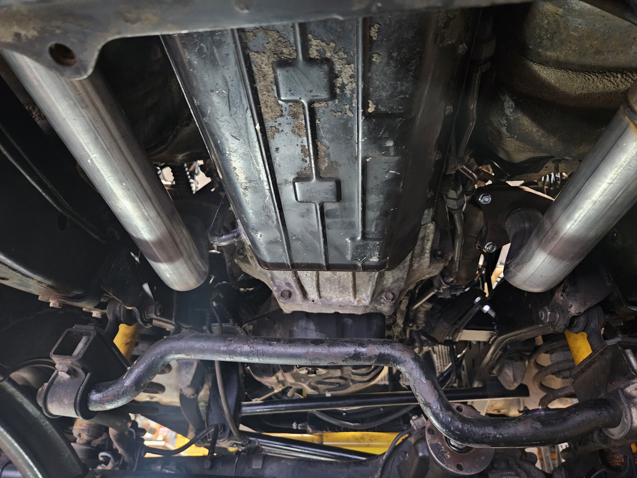

I know I haven't posted for a bit...just finished getting exhaust put on, pictures did not come out to good. I can get better ones if anyone is interested, but...I have transmission lights working on the dash as well as water temp and oil light. I am trying to get the tach and speedo to work now. Oh, and my daughter got married over memorial day weekend, so there's that! :)
Are you planning on running cats?
What size did you use for the exhaust?
I am still in the process but my setup is 2.25" from the headers into a dual 2.25 in - single 3 out spintech muffler.

2.25 from the manifold, 2.25 in and 2.5 out on a 2 in 1 out magnaflow and cats optional ;)

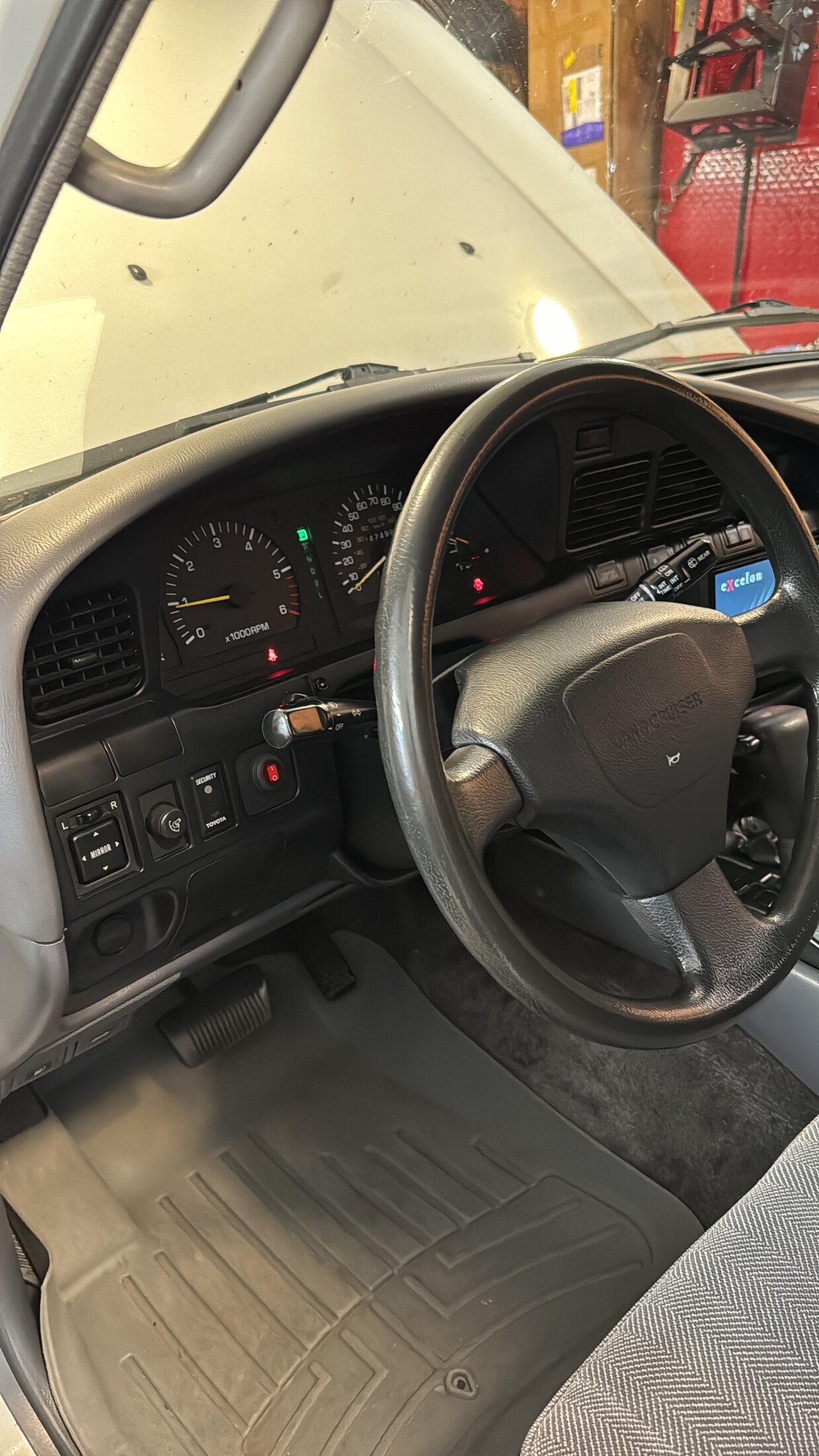

Well, I think I am finally on the final stages of having this completed.
I have all the gauges functioning except the Tach. I have not been able to get it to function. I have driven it around 100 miles over the last few weeks. Still a few little quirks to work out, but all in all I am happy with the outcome. Transmission needs a little attention. The parking pawl seems to be broke and still need to get overdrive working. The wiring is all there for it, I just haven't finalized that yet. I thought the transmission might have to come out, therefore, I wasn't to concerned about the overdrive. It has been a learning experience. I am a lot more familiar with the wiring on both the 80 and the 100 series.

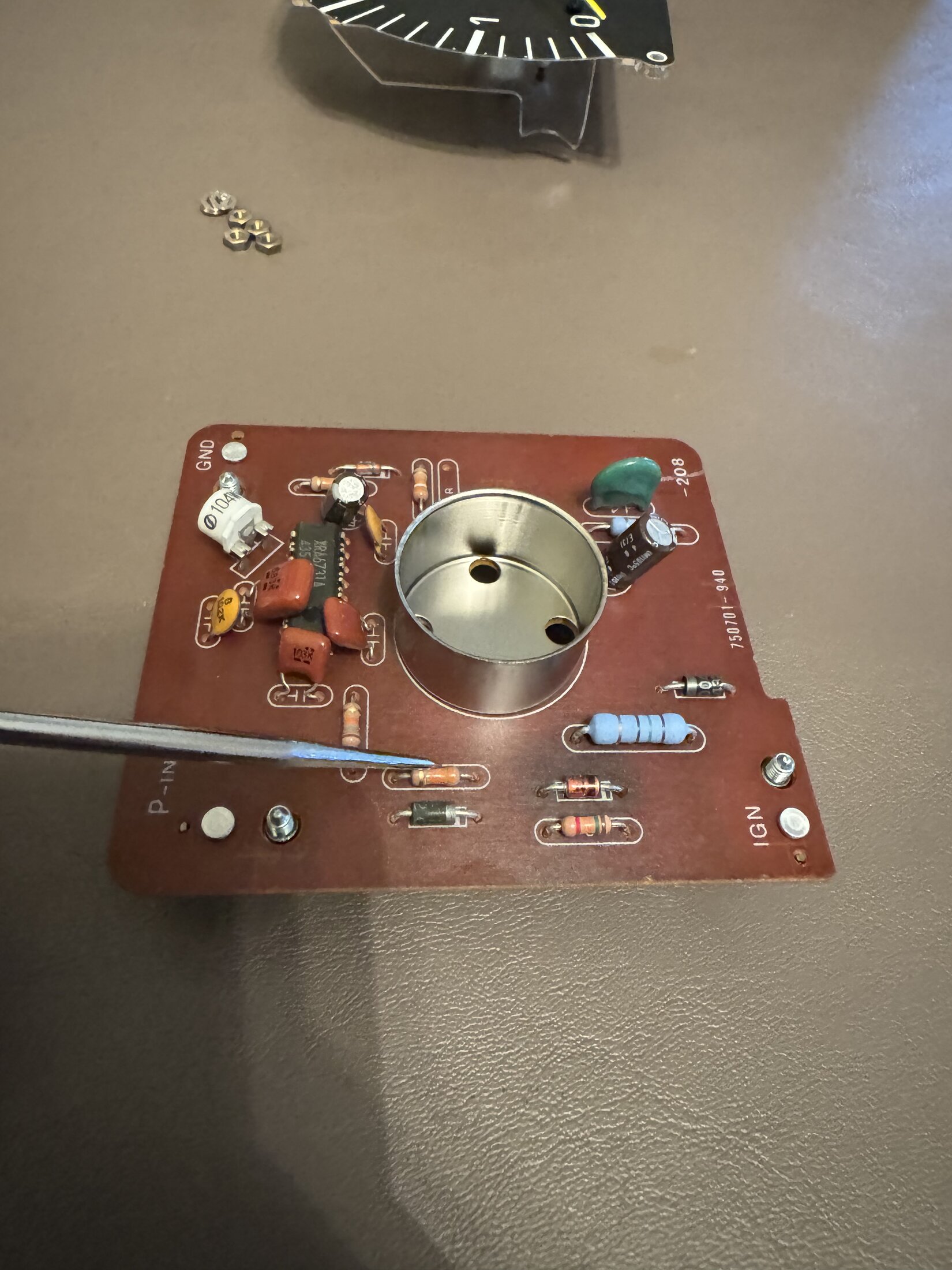

Tach is because Traditional Ignition coil being fired by an igniter and tach signal is basicly neg side of the oil. As the coils is grounded and released to create spark, the unloading of the primary circuit creates a pulse to 50-70 volts to trigger the tach.
The 2UZ uses coil over plug system and ECU possible provides a tach signal ? I would have to look at my 100
To see. Also you could run into one more small issues it tach calibration, 6 vrs 8 cylinders.
But the on the left side where the old ignition coil was, there is maybe a grey plug mounted on your ABS if equipped that’s a filter, and the old coil lead is pos and neg of coil to igniter. That igniter has two wires to old ECU, one power one neg side of the coil and one to the tach.
There is a partial solution called a DakotaDigital speed / tach correction device but it will not create a large enough signal to trigger the 80 tach, but it can correct calibrate the 8 to 6 if needed.
Now the trigger threshold, I removed my tach from the instrument cluster, I have a tach tester hi - low out but the P term on the back is the tach in, trace it, runs through a diode to a resistor , this resistor is the issue. Depending on what output tach signal you can get , 5 volt or 12-14 volt square wave or pulse this resistor has to be changed. Now I tested jump across the resistor my tach worked 5- or 12 volt signal in
But I lowered my resistor to 5.6k Ohms with the filter out under the hood plugged In the tach drops out 3500 rpm , unplug this filter the tach works perfectly.
Cheap Amazon scope voltage meter can tell you a basic tach signal from your v8. That signal tied to your tach input via how you wire it, plus resistor short across or remove it and replace lower value will get your tach working.
Now it is calibrated for the v8 another issue all together.
Without a tach tester to manually drive the tach and change another resistor to calibrate or possible twist a pot
I would defer to a tach correction device one is DakotaDigital is one of them.
So recap, tach signal is not crossing the threshold to trigger your tach.
Left with a device to boost the signal which I didn’t find to work, or mod your tach itself. Looks harder than it is.
Then 6-8 calibration could be an issue. Don’t mean it is
