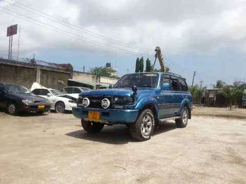

So I'm finally done with all the repairs and flipping. My LC is finally pic worthy and ive attached both before and after pics. Loving driving it! 3FE powah!
