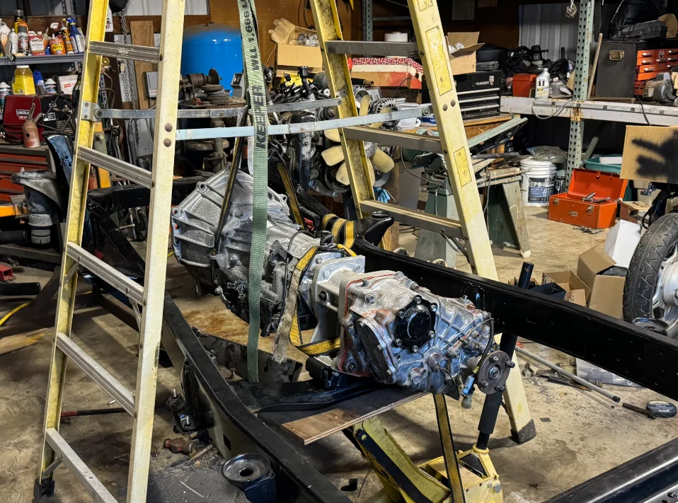

Had to spend forever buying a die grinder and the correct bit because the adapter was threaded slightly off. This is using the 85-87 mount and the OEM holes essentially slotted out in the cross member to give some adjustability because the 60 mount bolts are slightly wider apart. Going to join the motor to the transmission tomorrow hopefully to tack in motor mounts. Once drive shaft-pinion angles are set I will be able to set the rest of the axles. going to make some adjustable suspension components on the lathe when the school machine shop opens up. Slow process when you are dumb like me but it is a learning experience haha.

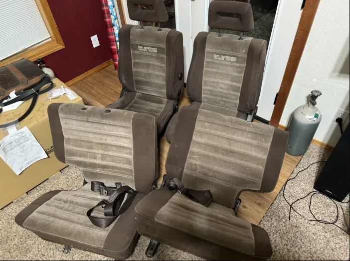

Sourced a solid set of Turbo seats from a RHD rig locally for a decent price. Foam is in good condition just need headrests for the rears. Will have to reupholster these in a blue grey setup if I stick with them still open to finding a set of blue grey for the right price.

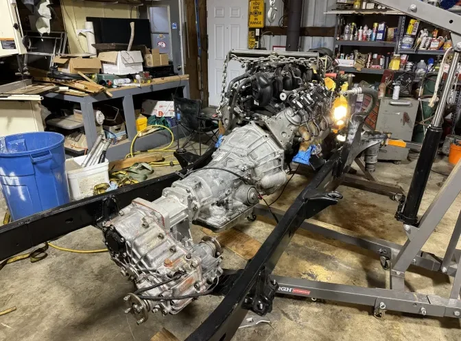

Also, motor mounts are welded in. I did however mess up and completely spaced adding the spacer plate that comes with cruiser matts motor mounts. However, the motor fits fine, and will figure it out and monitor if there are any issues. It is sitting slightly further back than Matt advised. I left the transfer case indexed off the cross member essentially and everything off of that so it sits 1.25 or so inches further back. Will deal with firewall and other related things as they come up. Wanted to give myself the most amount of room in the front for intercooler and cooling across the board essentially. Was a real pain getting everything level on the rotisserie and this and that but happy with how it came out. This is all a good learning experience.

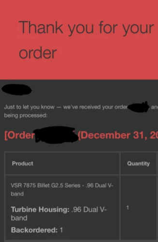

Why did you get the dual v-band and not the T4?
Aah, advance adapters strikes again!
If you find another set, ill take those rear seats off of your hands haha
