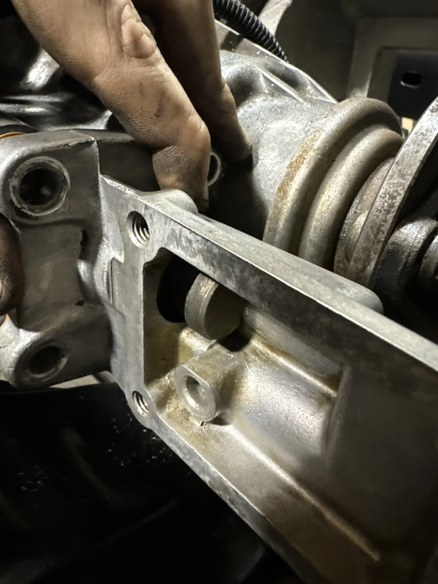

Any advice? This is the furthest this selector shaft comes out and it goes essentially all the way in. This is the vacuum housing for the FJ62
Coming back to this finally. Picked up a 91 FJ80 (going to start a thread on that... its a special one) but I will be taking the axles and stock steelies and swapping them with this one so I can run 15's on this 62. Figured out my situation with the transfer case a few weeks ago just didn't have stuff lined up on the transfer case. Hopefully next weekend I can swap the axles and start the welding on the semi float ones to finish up the rear suspension and all that is left for suspension is some of the steering mounts. Will update that hopefully end of November and have it done.
