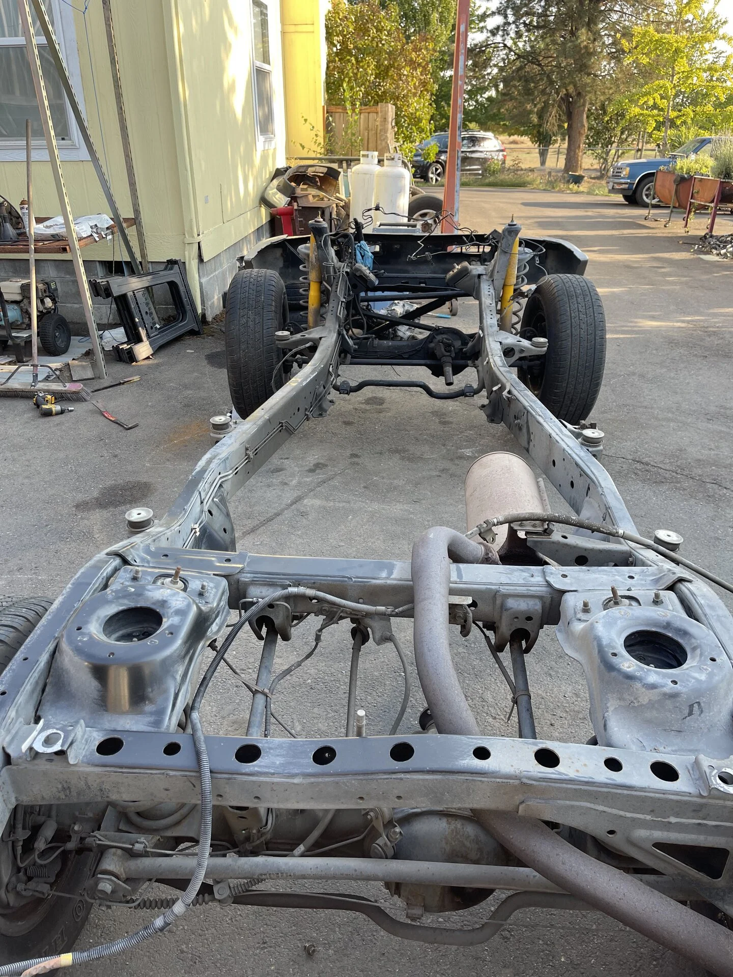

I didn't take many pictures but here is one pic of the 62 frame before I finished cutting and then a pic of the 80 frame

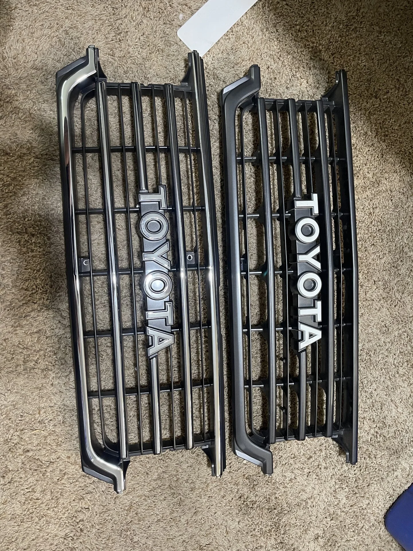

NOS Chrome and NOS Sahara Gray Fj62 grilles arrives today. Both brand new Oem. The chrome one will replace the Taiwan garbage that mine came with and the gray one is for sale will post it this evening. Don’t see these very often brand new with the Toyota box even!

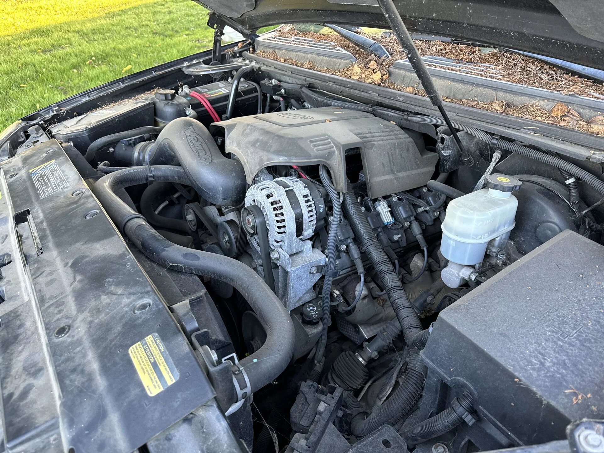

I picked this up this last weekend for a deal I just can’t pass up at $1600. 2009 Yukon XL denali. ~163k miles 6.2 aluminum LS L9H motor with 6l80e AWD. They said that it was starting to slip around 2-3 I have not tested anything out it sounds good and healthy will further look into it and baseline it before we pull the motor. Now the question is do I slap this in the fj62? Or do I save it for my 80? Or do I build a racecar??? I will end up making money on the Yukon after parting it out and keeping motor and trans!

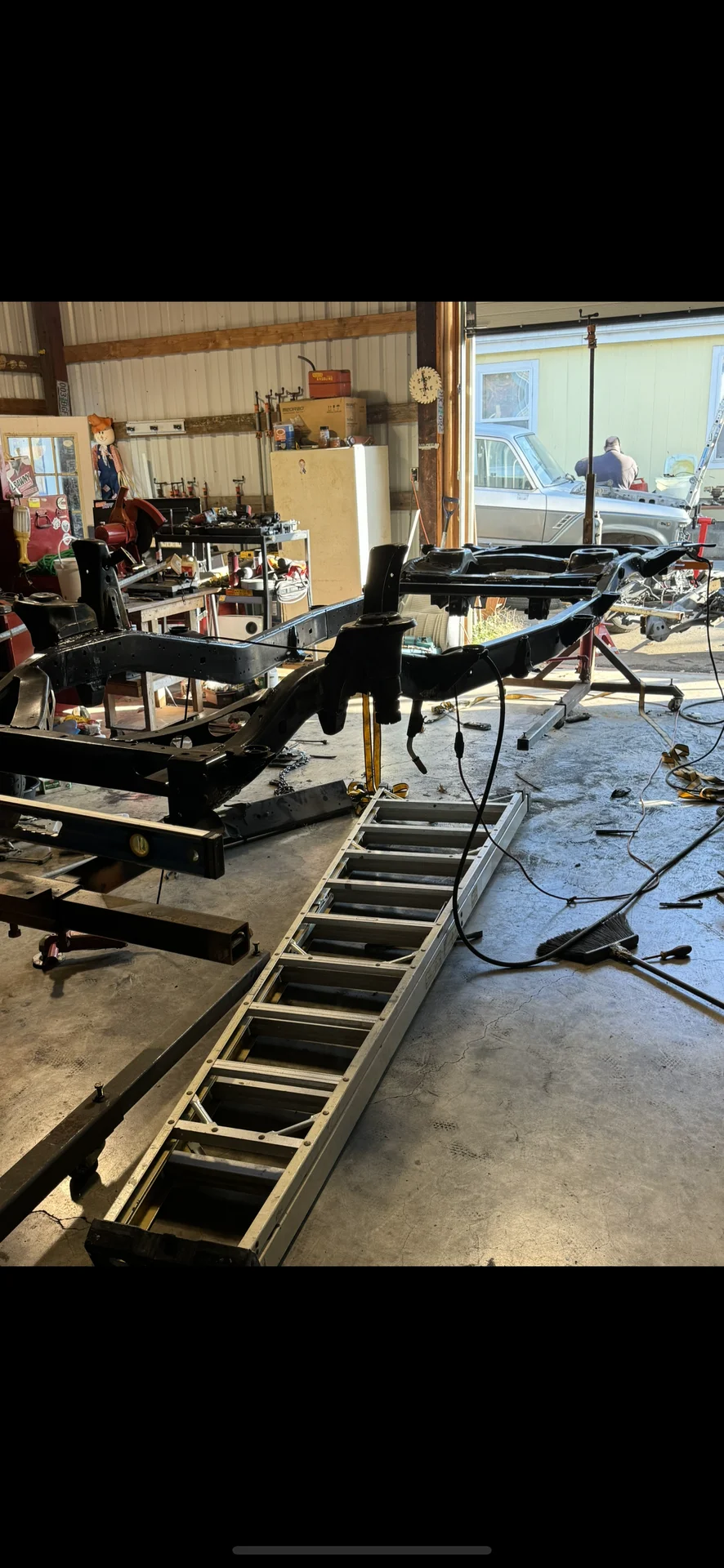

I have the front spring and shock towers put onto the 62 frame, as well as the rear cross section shortened and put into the rear as well. Not the prettiest welds but I’m confident they will be fine! Between school and family stuff time has been tight but with thanksgiving and Christmas break I hope to get it done quick I haven’t taken many photos but here is where I’m at.
Again welds not pretty but that’s what grinders and paint is for. This is a learning experience

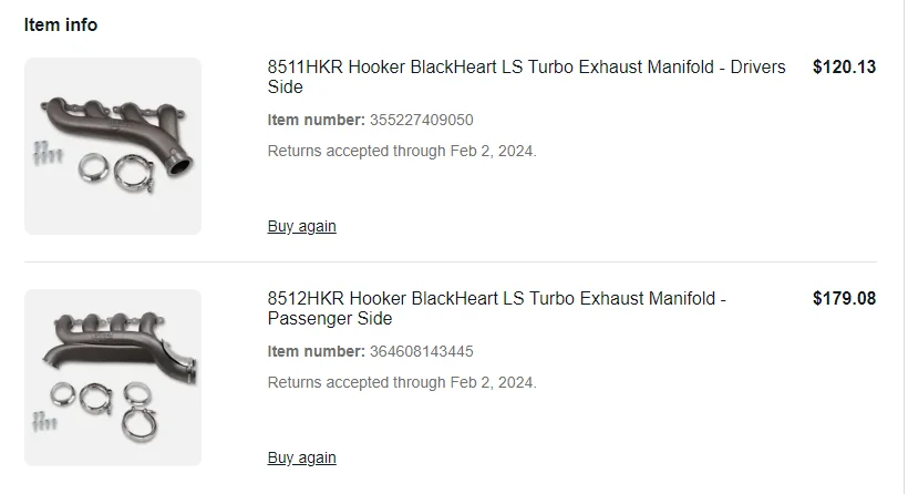

Let the party begin! (note this kit is typically 540-600$ but eBay scratch and dent special makes it a no brainer)
Buddy is coming over on Tuesday to finalize the location of 80 series suspension and measure stuff. Will build all adjustable arms and hopefully have full suspension set in position along with motor transmission etc. all in place ready to go back under the body by next weekend. Figured since I'm already building everything essentially from scratch may as well throw a turbo on it for the cool factor. Practicality is irrelevant at this point.
I can tell you right now it will be easier to make a new passenger manifold from scratch rather then make that one work on a Cruiser. Running the crossover pipe behind the bellhousing is going to be a mess with driveshaft and downpipe.
I used this and capped the downpipe end and cut a new one in the middle and ran the crossover under the front of the oil pan.
I have a SOA and it’s all very very tight
